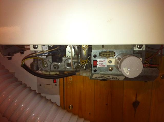

Switch on boiler is set to 'fully pumped' and not 'gravity'. As is the programmer.

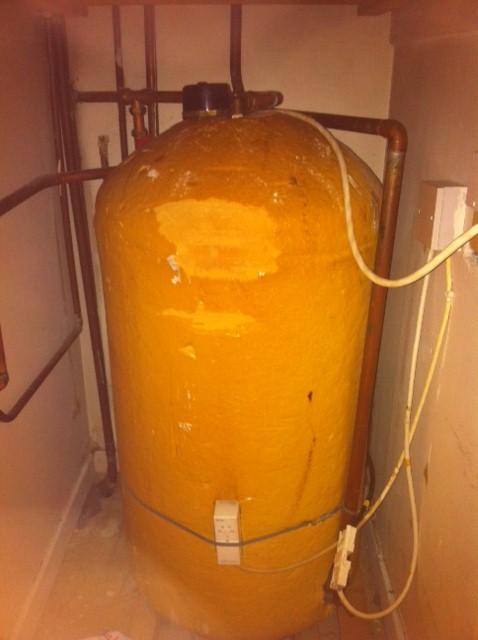

just to check, that cylinder stat does fit into a hole cut in the insulation, so it is touching the copper cylinder? it seems to be sticking out a lot.

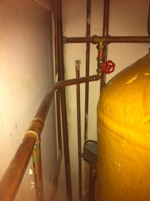

can we have some pics of the motorised valve behind the cylinder, showing its pipes?

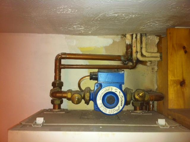

the pump looks extremely odd to me, perhaps I'm looking at it wrong. Where does the pipe go to, running rightwards out of the pump?
Hi hertsboilers, I thought initially there was a second yet to be discovered V4043, but having now seen the 'photos it looks as though you are absolutely correct. It is a gravity system. The sketch you have shown is most likely spot on.

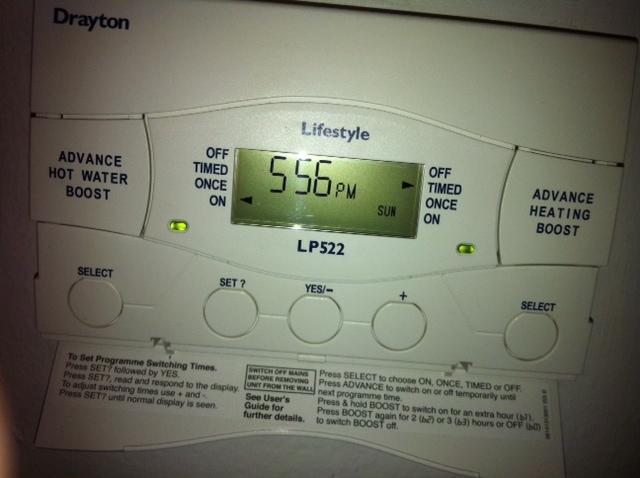

Independent control is possible but since that cannot be achieved it may be because the programmer is set to "Gravity" instead of "Fully pumped"
Maybe the OP could check that.

it could cause the "cylinder too hot" problem if it was faulty, incorrectly wired, or not in intimate contact with the copper cylinder (see my question above)

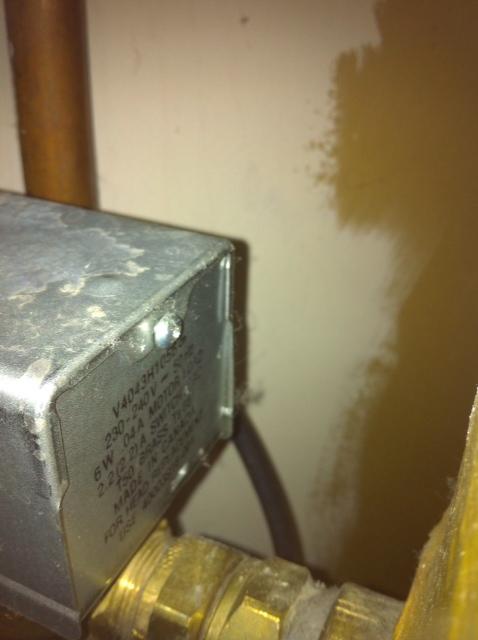

Discovered another valve in most awkward place, hidden behind cladding next to boiler.! Its not a complete unit as in the motor is a different make to the valve.
Anyway, the valve was leaking onto the motor and that is obviously the cause of the RCD trip.
Seems the plumbing set-up isn't the finest with valves and pumps spread out weirdly.
Plumber drained the system and put a new valve on. All is well again.
