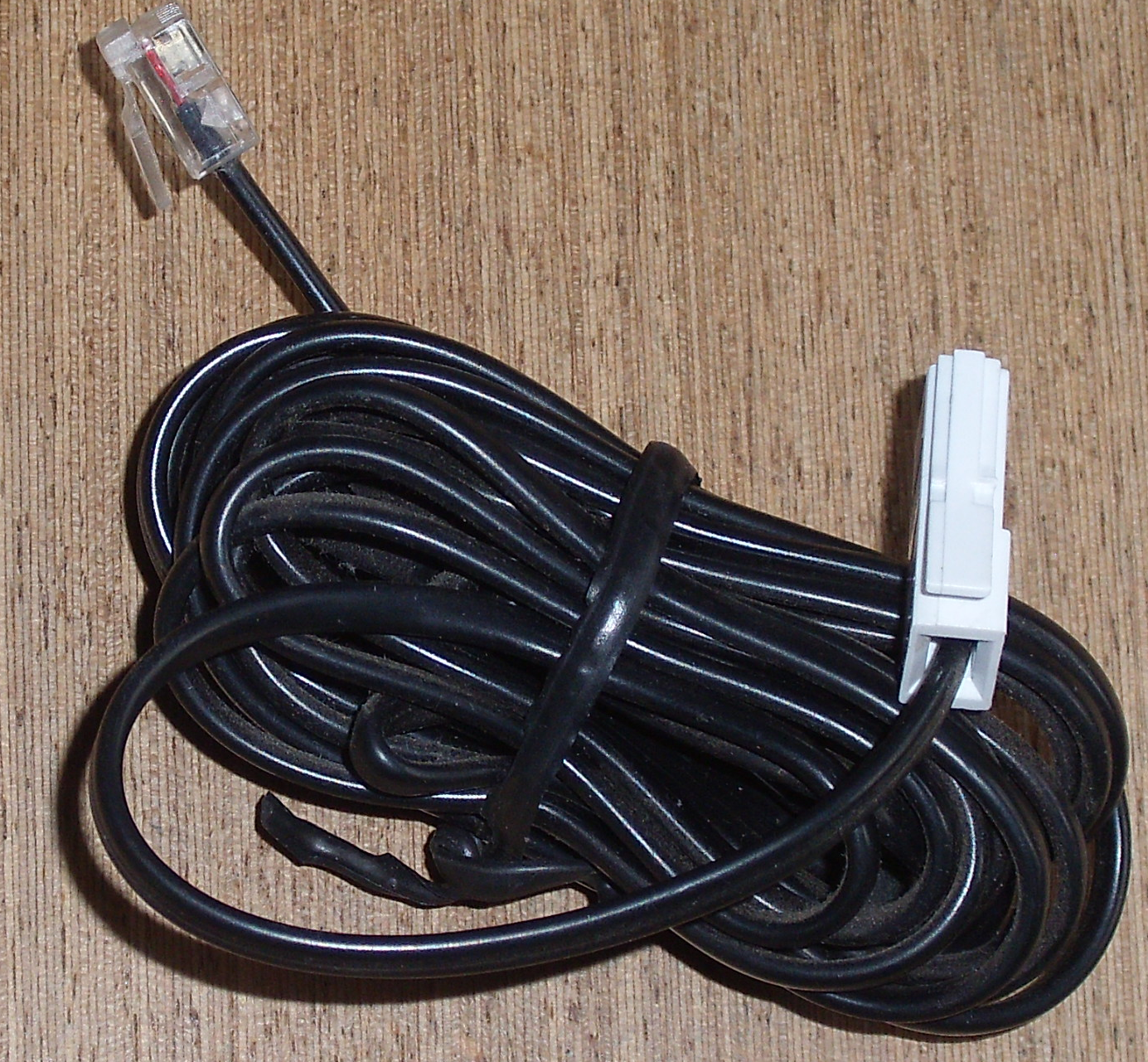

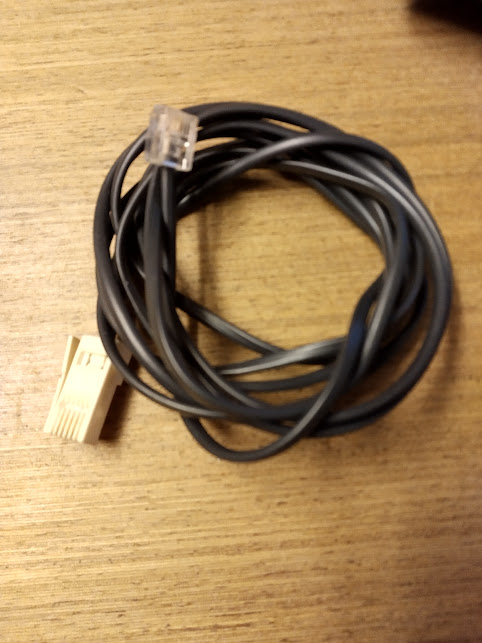

Or use this lead which also comes with the routers and doesn't require an adaptor or filter:

Never had a lead like that with a router.
I'll say the vast majority if not all of the modems/routers I've unpacked have included them, I currently only have 2 in the drawer, however I have used 3 at site where only a modem is in use so no filter required and I've repurposed (cut up) several.
Just pulled this failed lead from service in a friends home fortunately he had a spare from another router pack:
And as it happens I installed a new TP Link router with one of those supplied leads a couple of months back, meaning I now have four internet services running with them and two with 6P modular plugs (RJ12)
Edit: of the 5 broadband services I currently have running only 2 use a RJ11/12 cable
All the routers I have had had a micro filter and a double ended RJ11 lead.
