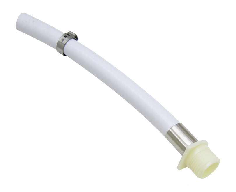

Both newly fitted showers are leaking out of the bottom of the units. One is only slight, the other is very bad.
I've removed covers and run shower to see what's leaking. I can see that water is leaking from the outlet hose just before it fits into the screw in hose (external hose that hand set goes on).
Any ideas why both would do this from new? Am I doing something wrong?

You have fitted the rubber washer in the end of the hose before screwing it on haven't you ?
Have you a pic of where it's leaking ?
They are just rebadged newteam showers.
Washer is defo in place.
Just trying to work out how to up load a pic to show you the leak location.
Thats def a manufacturing defect.
I don't know how bristan work on coming out to look as i never had to call them out but triton etc don't charge until on site and the fault is proved to be yours and still don't always charge.
But give bristan a ring see what they say it may be a known fault and they'll send you new hoses.

I think I will have to fit myself but concerned how to undo the clip. Any tips?
Note: the pic above is one of the old units that I replaced. The clip on the hose is slightly different to the new one.
The clip should look like this.
there is a tool for doing them up but can be done with a pair of pliers.
useally to undo just place a screwdriver in the hole and twist.

So if I insert a screwdriver and twist, this will undo the clamp?
How do I do it up again when installed?
What is the tool called for doing them up? Screwfix might have them?
Or if all else fails, could I just use an ordinary jubilee clip?
