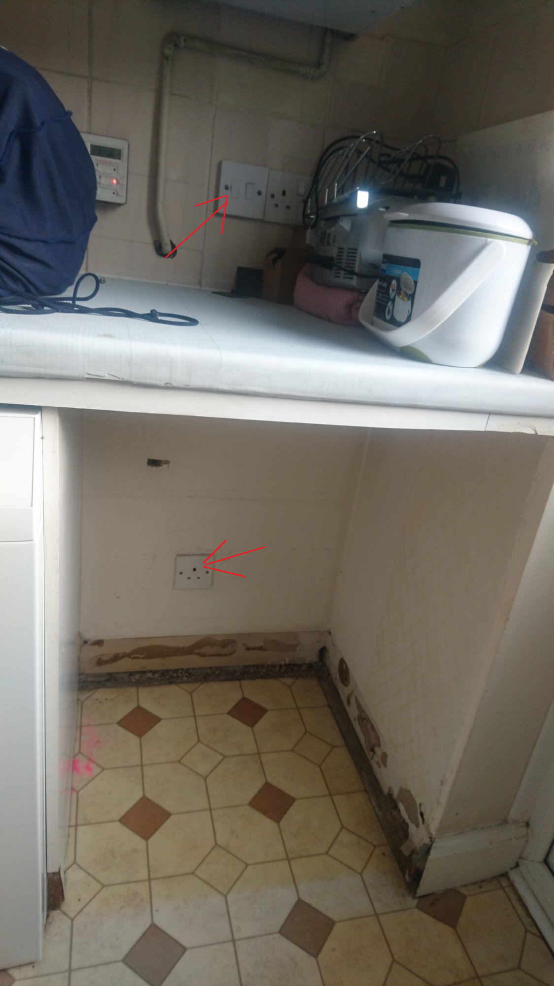

My kitchen several has under worktop/in cabinet non switched power sockets for appliances etc.
Above the worktop, each of the power sockets can be switched on an off by a switched FCU.
The switches indicated in this picture illustrate this:
The previous owner has had loads of switches configured this way in a couple of places and it looks a bit of a mess so id like to tidy it up and have less visible wall mounted kit before retiling.....
Before i retile and refit the kitchen i want to know if it's possible to do the following
1- remove the switched FCU, join the load and supply using a choc box then blank off.
2- replace the under work top sockets with switched sockets
3- tile over the blanked off areas. (or fit blanking plates over the tiles in case i need access/maintenance in future)
can you guys provide some advice on if this is a feasible solution or the best alternative approach?
p.s id have about 5 or 6 of these to do
1- remove the switched FCU and blank off
You would need to join the cables with a suitable method for hidden joints because of 3
Yes, if you want switched sockets.
3- tile over the blanked off FCU's
If you follow 1.
It would probably be just as well to re wire the parts concerned.
The FCUs may be removed if they are not there because the spurs need to be fused.
You may tile over it if that does not create problems with concealed cables and no "safe zones" for them, and if you use a maintenance free connection method to join any cables.
https://www.diynot.com/wiki/electrics:walls
I would not consider that accessories you cannot see create safe zones.
Thanks, for the reply. Can you recommend the most suitable/correct joining method?
i was thinking along the lines of some sort of maintenance free junction box box
I prefer soldering, but that seems to have gone out of fashion.
MF junction boxes are allowed.
As mentioned above you will have to comply with the cable zones with tha accessories concealed.
Install a couple of sockets in the appropriate place and cable joints and routes become easy.
I didnt even realising soldering was a valid/acceptable method thanks for suggesting!
However, if, as I understand it, each FCU feeds just one (single) socket, then I cannot think of any situation in which "the spur would need to be fused".
Thats correct each FCU feeds a single socket
Cheers for all the responses folks...most appreciated!
Just need to decide on the best approach for me now.
In that case, as I said (expanding BAS's point) you could, if you wanted to retain a local means of switching, replace the FCUs with DP switches - which you might consider to be an aesthetic improvement.
Kind Regards, John
