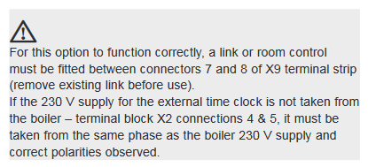

I have worked on a number of 'domestic' systems, if I had to put a figure on it I'd probably say around 100-200. So not as many as pet pants who install them on a daily basis but enough to get an opinion.
I find the vast majority of NON COMBI systems are wired:
Mains to the controls-timers then to wiring centre and from there to the boiler, pumps, motorised valves etc.
Or possibly; Mains to the wiring centre and from there to the controls-timers, boiler, pumps, motorised valves etc.
From a random boiler installation instruction manual
