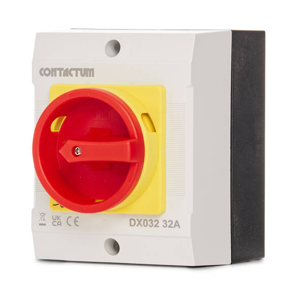

I would expect to see an isolator adjacent to the boiler. If I was the boiler engineer I wouln't be wanting to be looking for a way to make it safe and also be able to isolate it in a hurry if there was a problem while I was working on it.
Something of this ilke as it's outside and isolate all live wires (L, N, switch wires etc) in fact everything except earth wiring :
In my experience of domestic heating systems (bearing in mind I've far more experience of commercial system) involving a hot water cylinder I reckon the mains supply is most likely to be in the order shown. Combi's are more likely to have the wiring centre within the boiler, along with the time clock and/or radio kit.
Yep, that's about it with your diag. The electrician put this huge switch on the wall with the cable pinned to the wall along to the boiler. I will have to redo it and get the wiring hidden. It's just too ugly!
