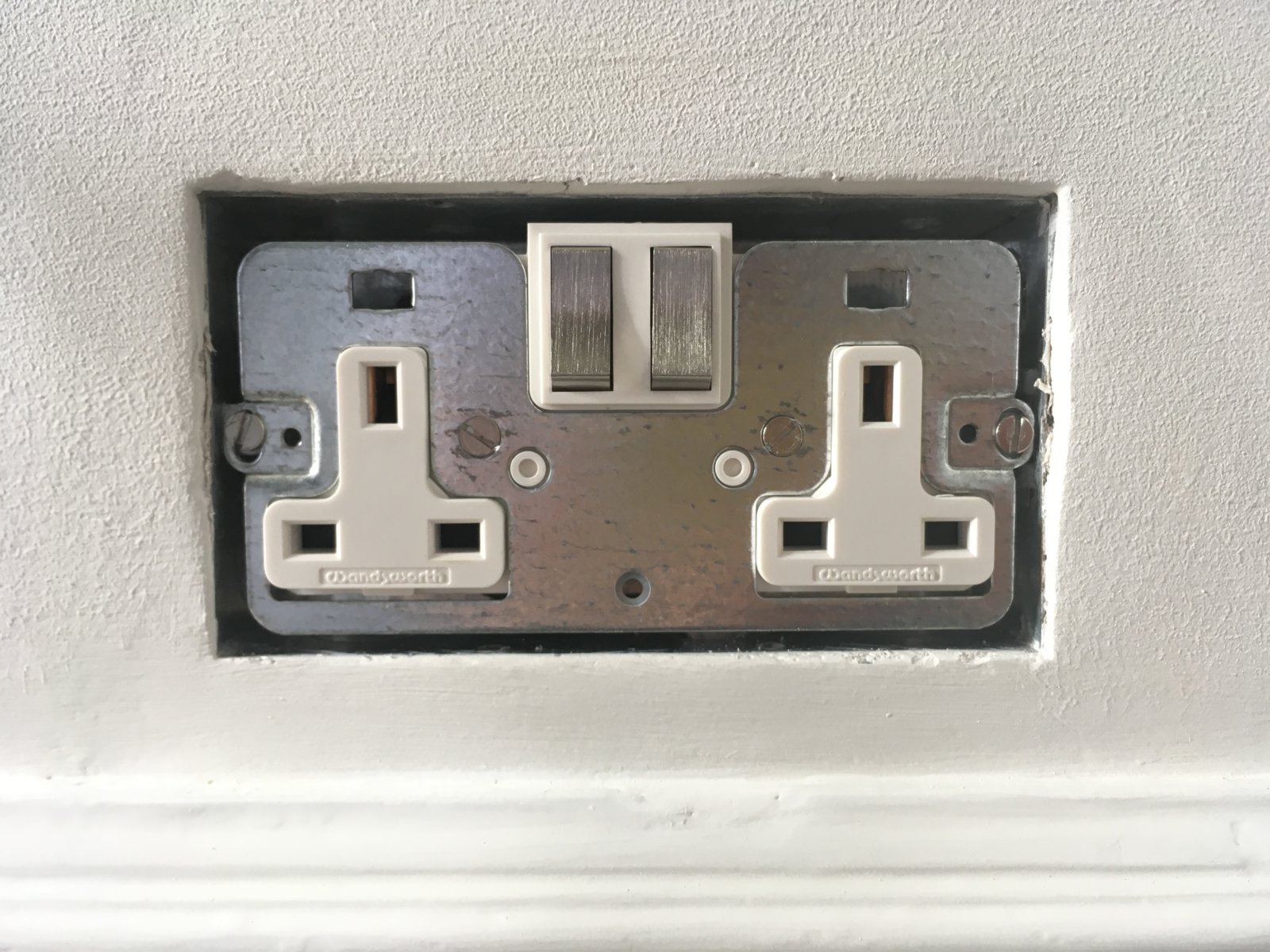

Filling Large Gap Around Socket Back Box
I cut a ply plate to fit exactly to the edges of the box fixed using the existing fixing holes and electrical screws, then you can fill flush to timber and carefully remove when set.

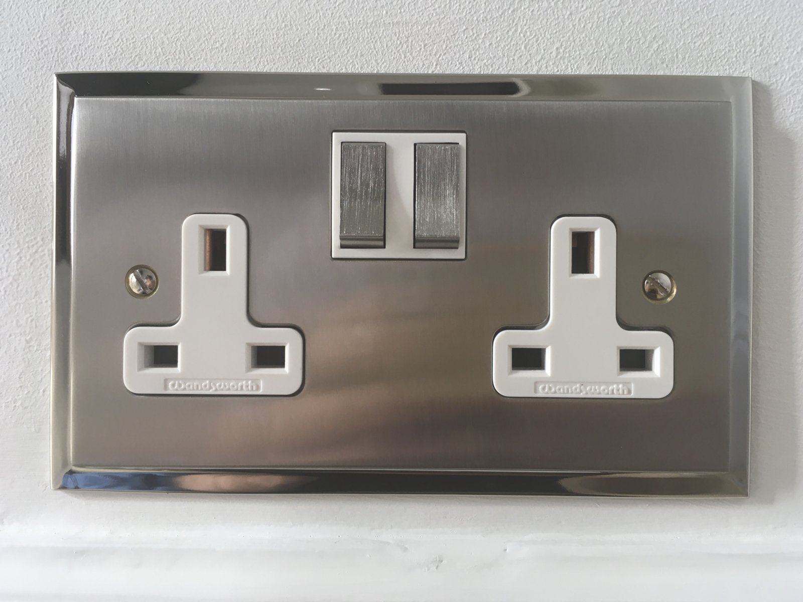

Thanks. Yes annoyingly I did forget the grommet.
Once again thanks for the help. Here is the finished work...
