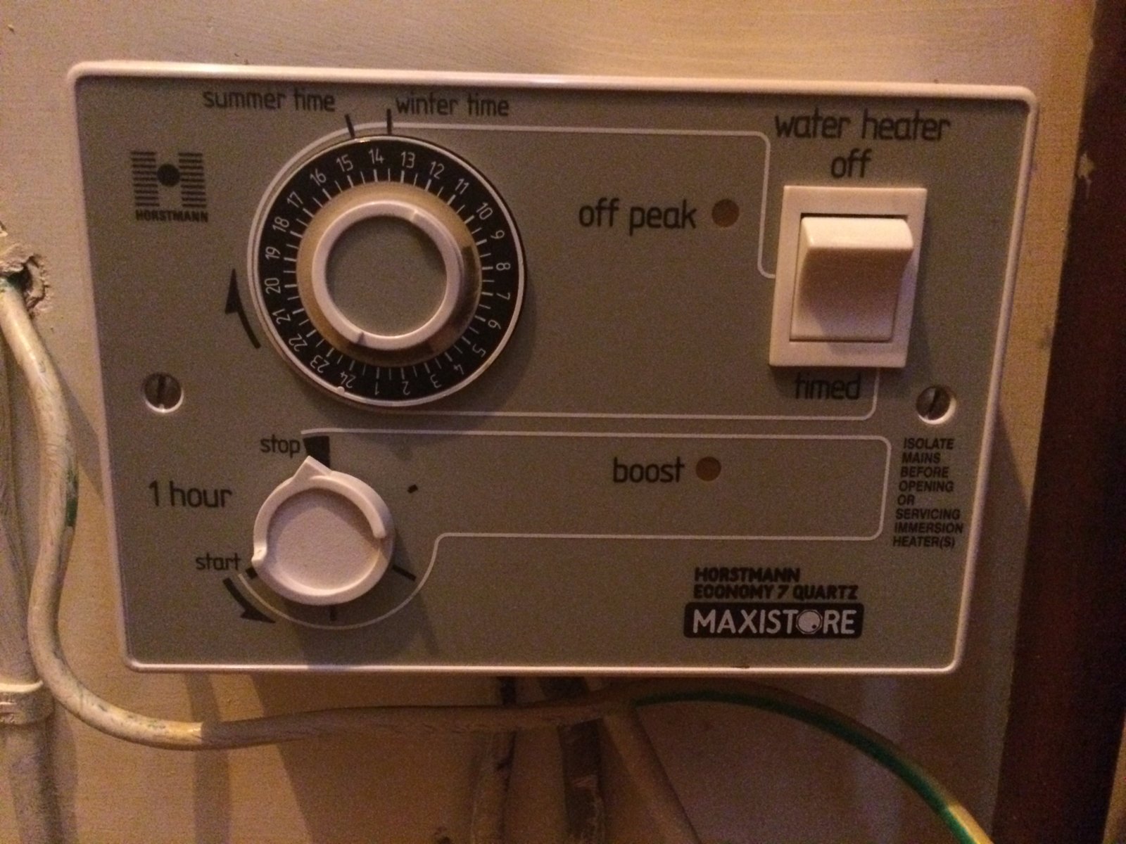

Horstmann (and probably others) do immersion timeswitches that enable you to override the timer.

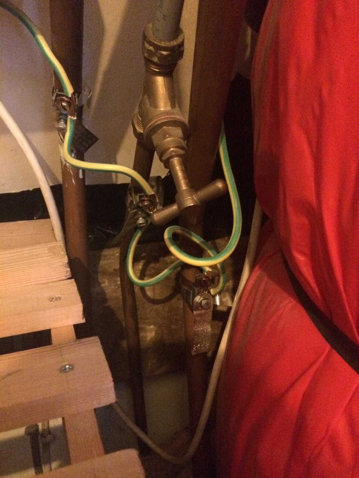

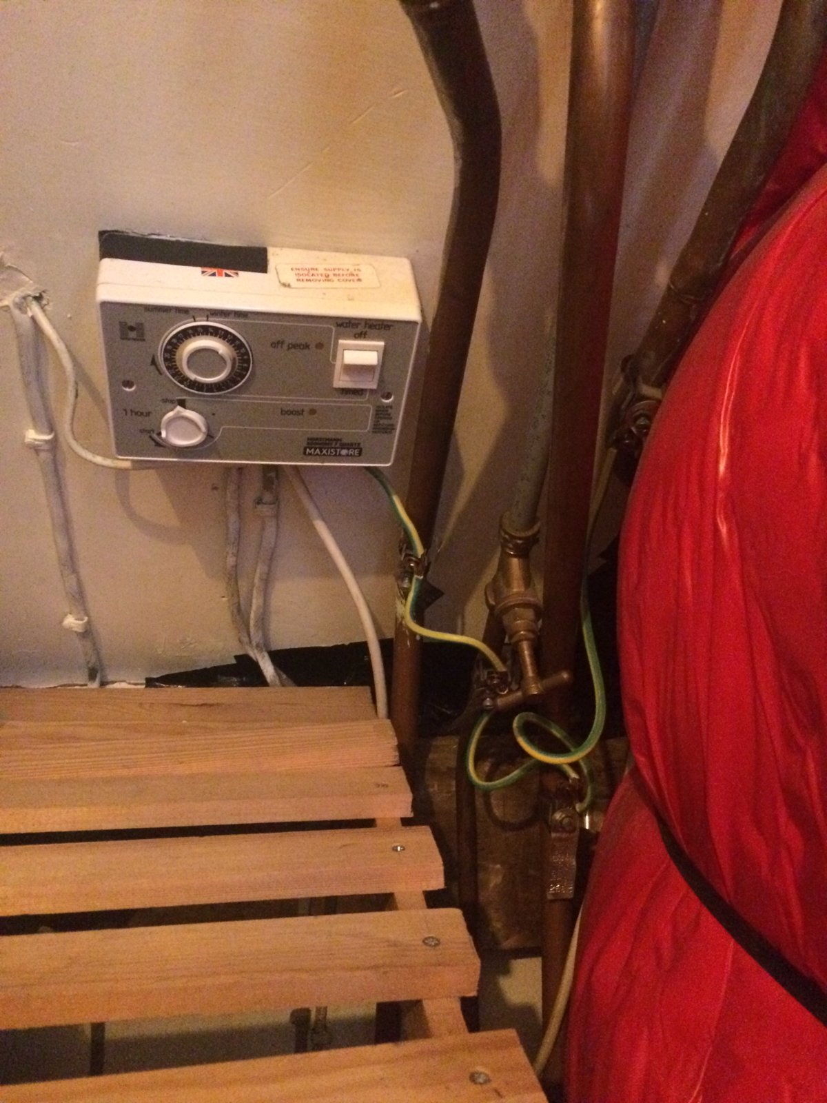

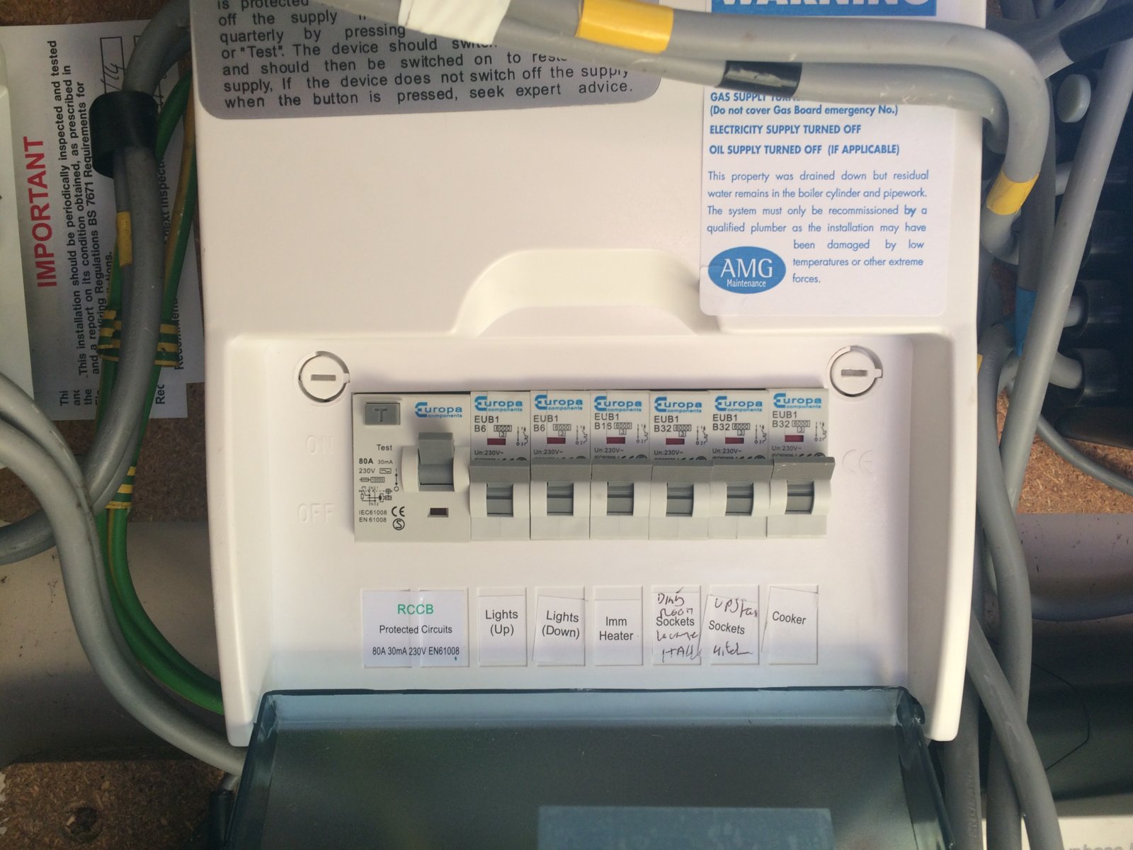

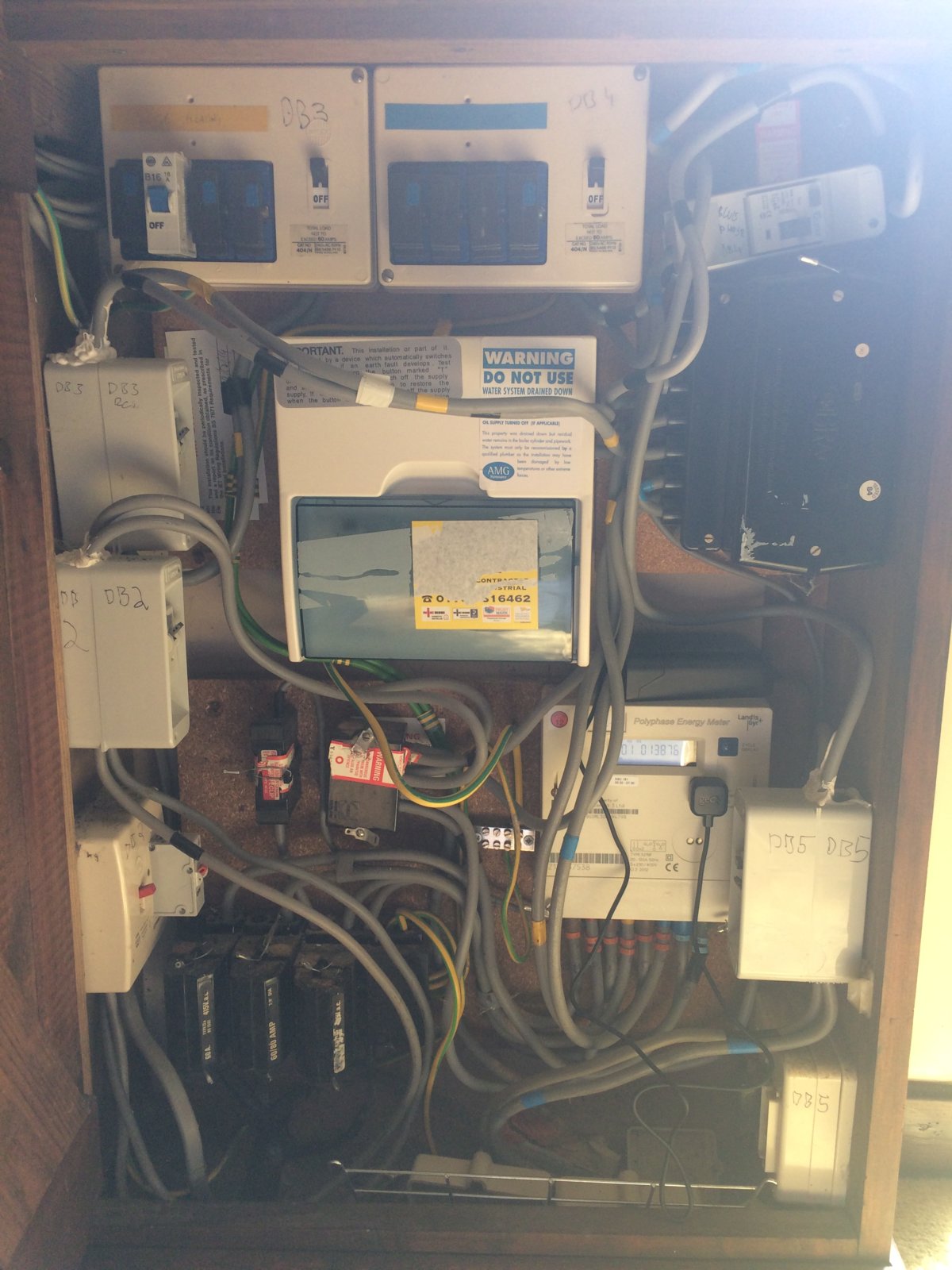

please show photos of all the switches, timers and cables around your immersion heaters; and of your consumer unit(s) and electricity meter(s). There is probably a timer close to your meter, owned by the electricity company.

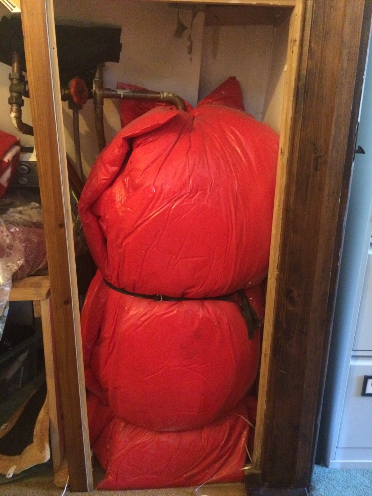

What colour is the insulation? New ones have more.

The insulation is red, I have attached some photos as requested. You can ignore the warning sticker on the consumer unit, that was placed there while the property was vacant by the repossession company who were selling the house. They don't come off easily!
Ah, it looks like you have a bare copper cylinder, with a red fibreglass jacket on it.
More modern cylinders have factory-applied stiff plastic foam insulation. I should think yours is 30 years old or more.
Being small, and the insulation not the best, you will always tend to be short of hot water. You could add some foam pipe lagging, especially on the pipe that comes out of the top. You can add a second jacket on top of the first.

From what you say, there is probably just one immersion heater, going in at an angle from the domed top if the cylinder. They are usually about 30" long so it will not quite reach the bottom. If/when you get a new cylinder, it can have two heaters going in horizontally through the side, the bottom one will heat the whole cylinder, and the top one will heat about a quarter of it. as you have cheap-rate night electricity, it is best to use the bottom one at night and to top up as little as possible during the day.
The immersion heater will take round about an hour and a half to heat 90 litres of water. It looks to me like you can put on your "boost" prior to having your evening bath, the thermostat will turn it off as soon as the cylinder is hot, so you will not waste electricity. Your Horstmann immersion timer switch is a good model, but check your electricity tariff to see what hours your cheap rate is, and set the timer to take full advantage.

It looks like you have a 3-phase supply. Are you in agricultural or industrial premises? Or at the end of a long overhead power line?

I'm not on agricultural or industrial premises and I don't think I am at the end of a long overhead power line, I'm pretty central in the village. I hadn't even noticed that I had 3 phase supply so that's interesting.
Do you know if you definitely have Economy 7?
It's more unusual with three phase supplies, although it does exist.
Yes definitely, the first thing I did when I moved in was get the cheapest economy 7 tariff I could as I knew coming from a gas supplied home, electric heating was going to be a lot more expensive.
