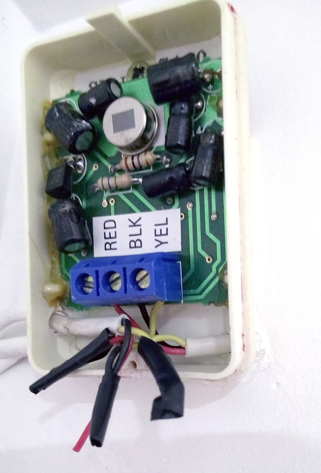

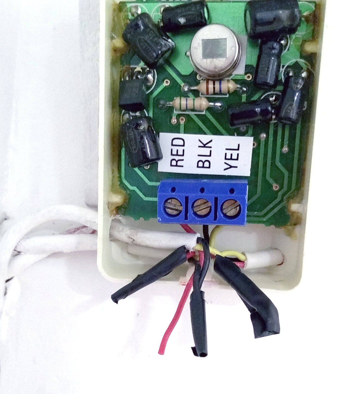

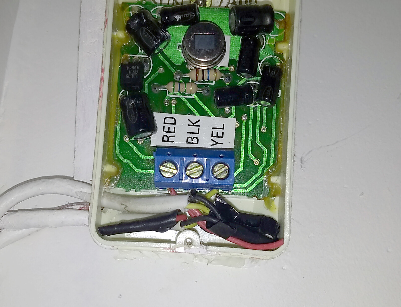

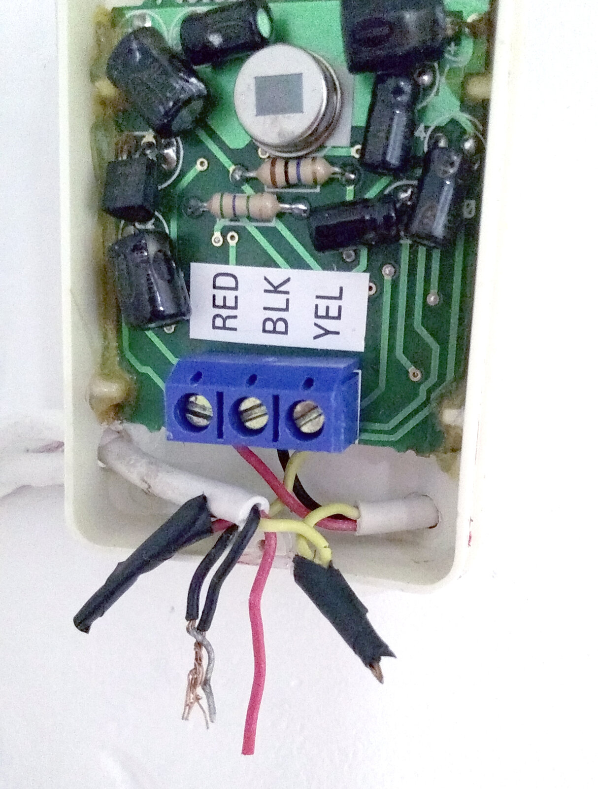

Ok I took the lid off and found this. Could this be my problem :LOL:
Here is a photo of inside. Those two blacks were twisted together with tape on them and everything was crammed in the space.
For now until I have more time could I just stick a piece of insulating tape on the sensor. It actually points at something that already has a magnetic contact anyway so I could do away with it all together.
I didn't bother with the tamper as its out of reach.
So as a temporary bypass do I just tape up the sensor
