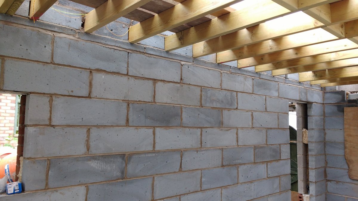

Last question on this I promise - my blockwork is set to end up about 50mm lower than the underside of the joists - the BCO says the joist should land on the block not a mortar bed - worth getting some coursing blocks to allow the joists to sit on a decent sized block, or just cut thin slivers of block and get them bedded at the right height? I guess I can't just use a tiny bit of cut block (eg. 50mm x 50mm) under each joist as that would be too flimsy, so should run a straight course all the way along level with the undersides of the joists? (I'm using those long celcons) anyway any tips on the better way to do this much appreciated
What did you end up doing with the 50mm gap?
Looks good, are they cuts of the same block you built with? Which density are they?

They're celcon turbo blocks same as the rest of the wall. 3.6n just cut with a saw. I guess dense concrete are better but I'm doing this on my Todd so anything to save my back and speed me up :D
