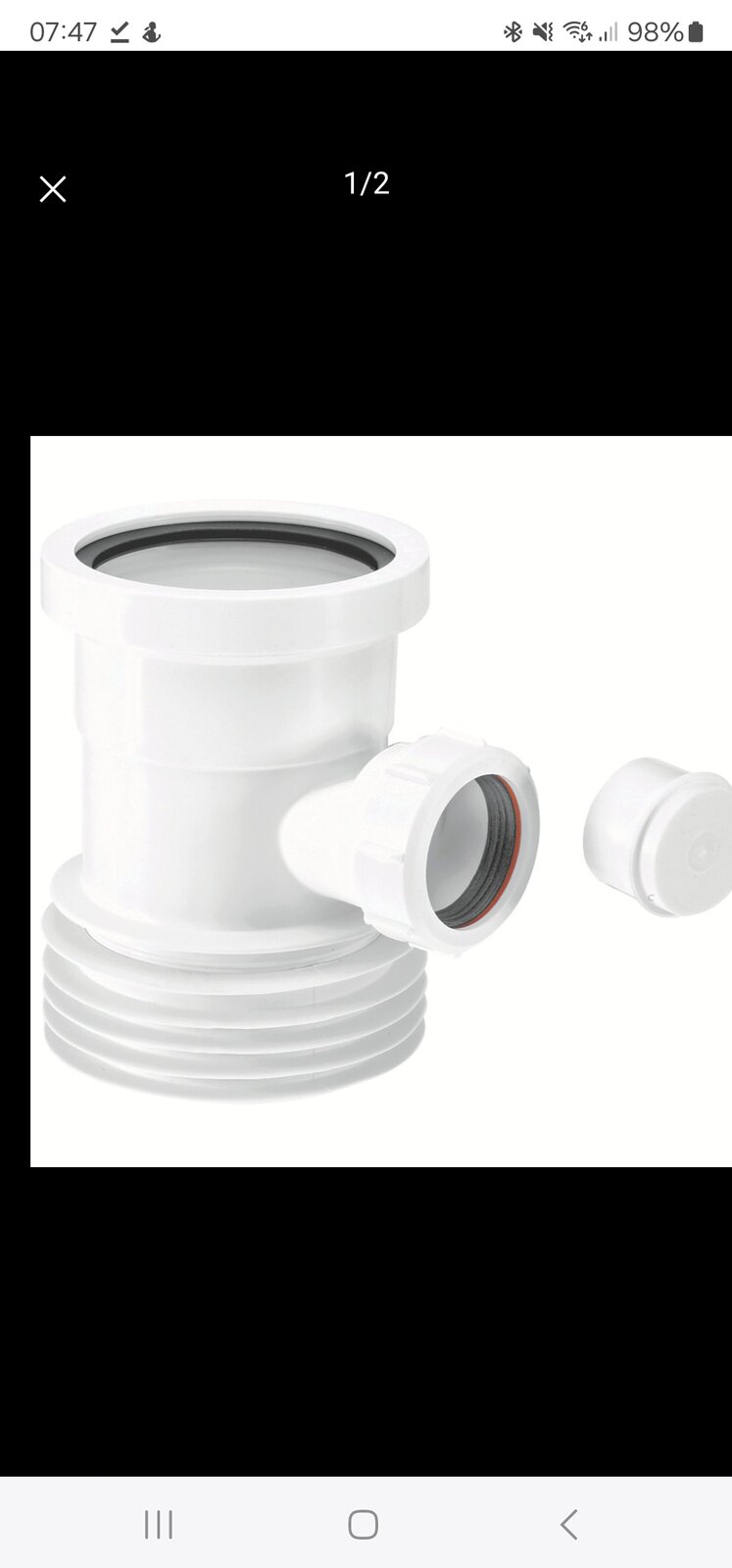

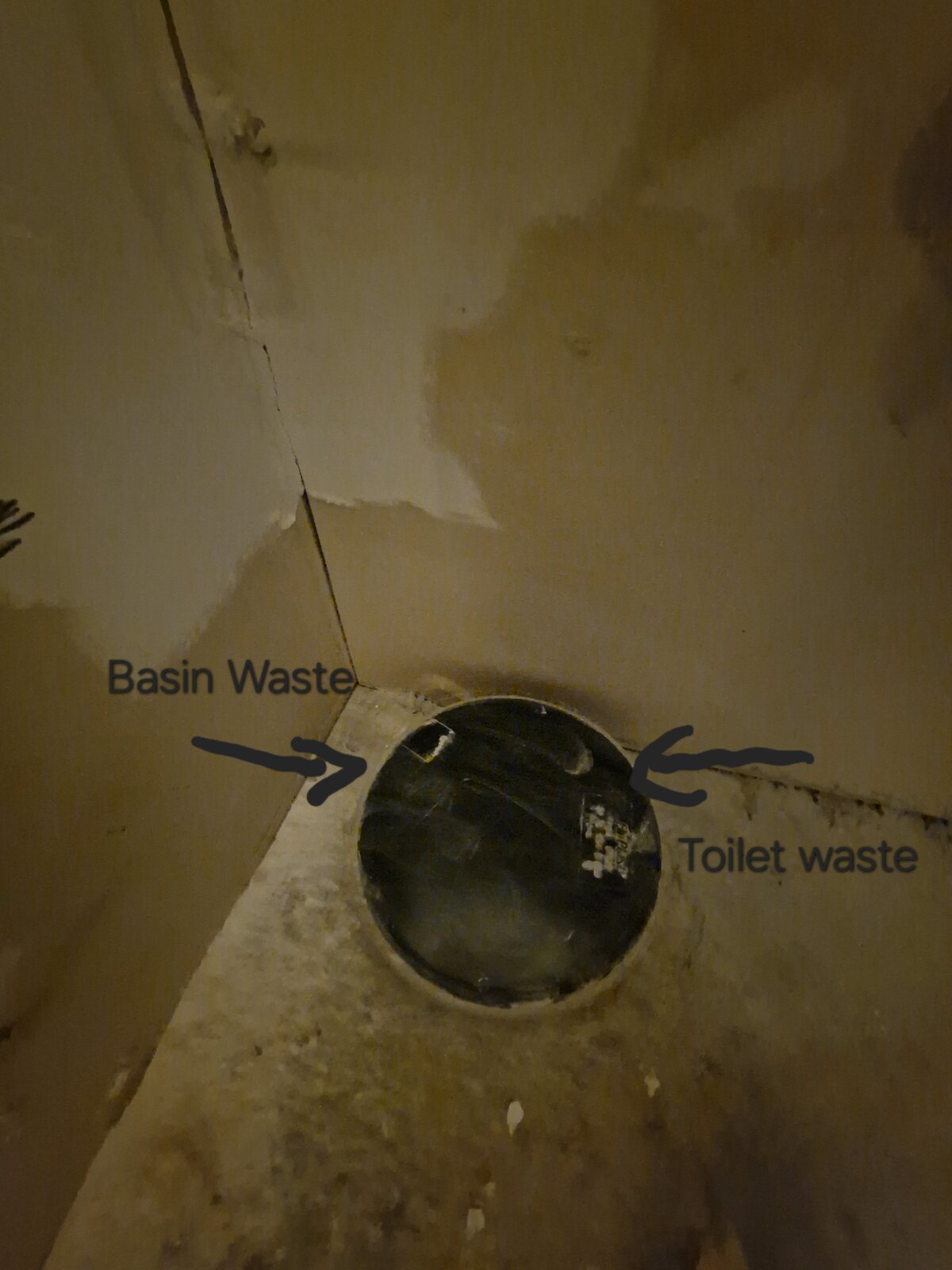

Hi,
I'm after a new waste pipe connector that has a boss and toilet waste on opposing ends. I plan to fit the sink waste inside the wall on the left and soil pipe itself will be in a concealed toilet frame but I've not found a connector that has a boss and toilet waste connector on opposite ends. Usually they are on 3 corners but I don't want anything sticking out at the front or it'll push my frame housing further out which I don't want.
Thanks in advance

Anyone available to lend a hand here? I'm planning to work on this tomorrow.
The unused bosses can be trimmed to be flush with the pipe if that helps. But you might need to fit the basin connection in to a boss connection above the soil pipe entrance.
Thanks.

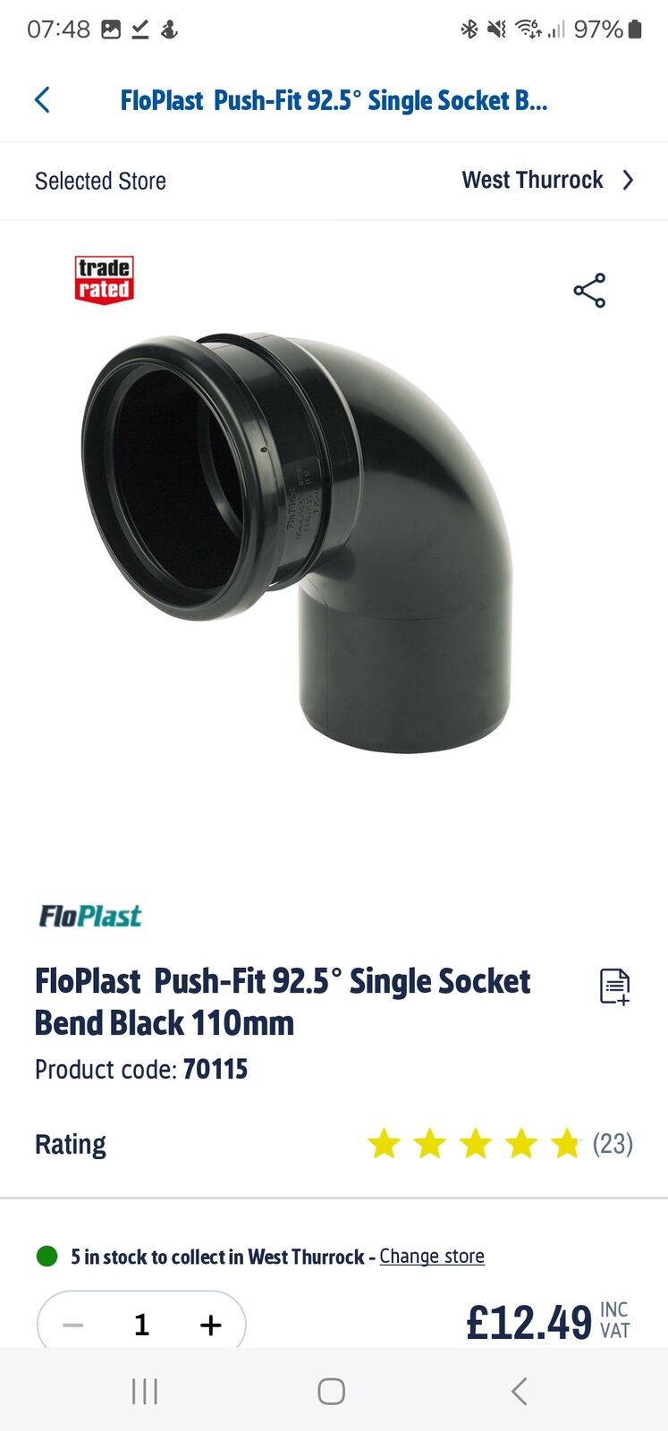

Can I use something like this together?
