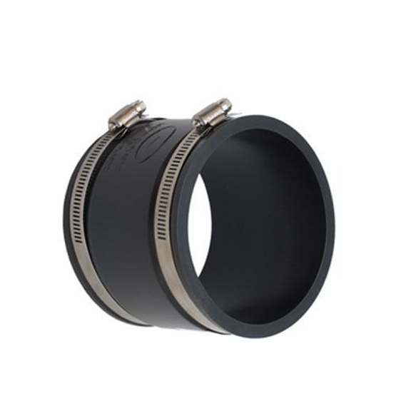

Only other way you may be able to do it, if pan connector tube is firm, would be to cut ~ 2" above ground level and use a banded adapter (flexseal fernco) and then use a shorter bossed connector above it but that would be a bit of a fudge. Would need to know the diameter though.

That's why I was asking if the white pipe of the pan connector down into the concrete is rigid or soft - if it's stiff then a fernco adapter will tighten up to it fine and it wouldn't leak, if it's soft/flexible it may not. Some pan connectors are rigid and stiff, other are more soft/flexible. Just squeeze the pipe with your hands, does it feel soft and relatively pliable or does it feel quite rigid/stiff
This is the fernco, the jubilee clips tighten to the pipe and seal it up
