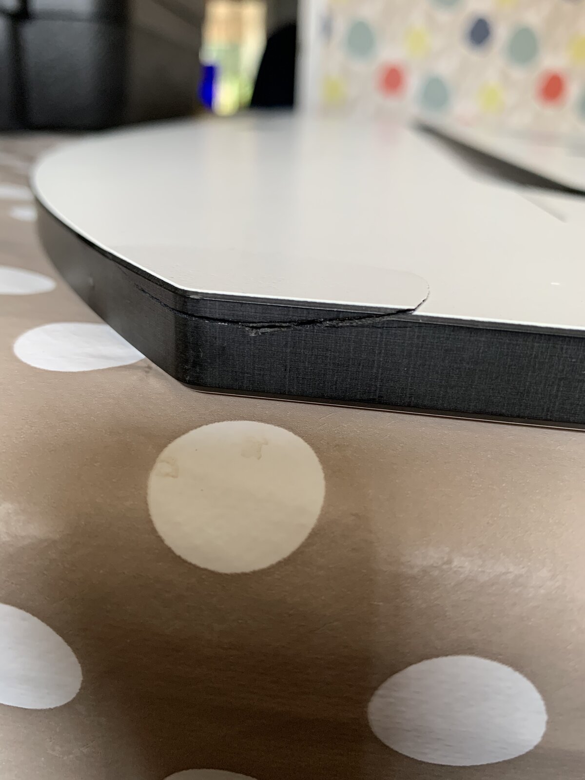

right….so I bought a “brand new” Trend KWJ700 worktop jig from flea bay, but it’s damaged…
There’s a chip/tear at the edge of the 400mm rounded bit which is about 3mm deep and so that bit lifts above the surface. The seller offered a £25 refund which I’ve accepted as it means I will have paid £40 for the jig.
I’m wondering if I can glue/screw it down.

Super glue - from a mitre bond kit.
You can't screw that stuff
Alternatively epoxy adhesive (Araldite) worked well.into the joint, clamp until set, then clean up with a fine file
