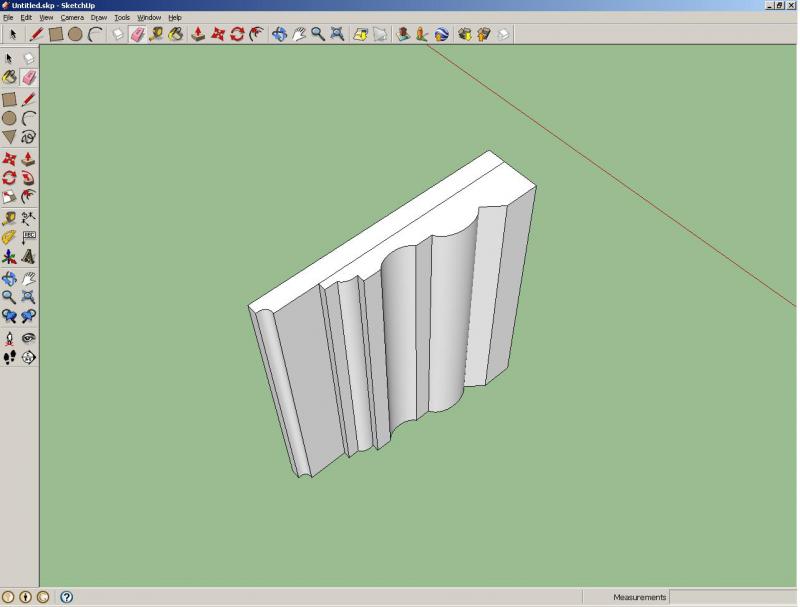

I hope this an easy one for you. I'm intending to build up an architrave around a few windows at home. It will be made up of 2 layers to closely match what is already in place in the rest of the house.
I'm buying an off the shelf architrave (MDF) which is about 95mm wide. This will sit on a backing piece ( again MDF ) which is about 12cm wide and 9mm thick. Something like this.
Once it's all painted up the idea is it will look like a 12 cm wide architrave.
The challenge I have routing that detail on the edge of the backing piece. I would want to create something like a a 'Rounding Over Ovolo' which I think would be made with one of these.

I'm only considering making the back section which is
120mm x 9mm or 12mm mdf. Length will be 2400mm. Checkout the first picture
I must be missing something but I thought that is exactly what I would
Be doing with the cutter ie running the bearing along the 9mm edge along the length of the piece.

Click ! Got you now. Yes cutter is 12.7 mm high so bearing
Would be off the work. Nice idea about back-to-back.
