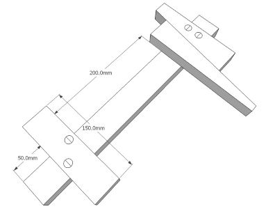

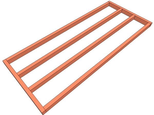

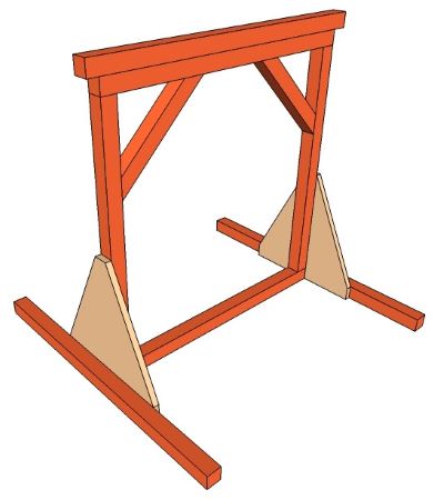

The first task is to find yourself a workspace where you can set-up a cutting table to break down your sheet stock. Homemade "quick and dirty" trestles can be made from 3 x 2in (70 x 44mm) or 2 x 2in (44 x 44mm) CLS or scants (providing they are straight) with maybe some plywood or chipboard offcuts, and look like this:
By using sheet material for the leg braces (the light coloured pieces) it is possible to make this sort of trestle so that it can be knocked down into 3 pieces for storage (flat) and transport. Or you could just buy a couple of folding trestles at £40 to £50/pair, or more. I tend to make mine about 900mm high x 900mm wide from materials I have available (often 2 x 2in or 3 x 2in CLS), but I'm not overly 'precious' about how they look, so long as they are sturdy. To sit on top of those I make-up an approximately 7 x 3ft (2100 x 900mm) cutting table out of 2 x 2in or better still 3 x 2in softwood:

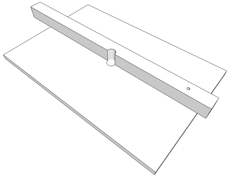

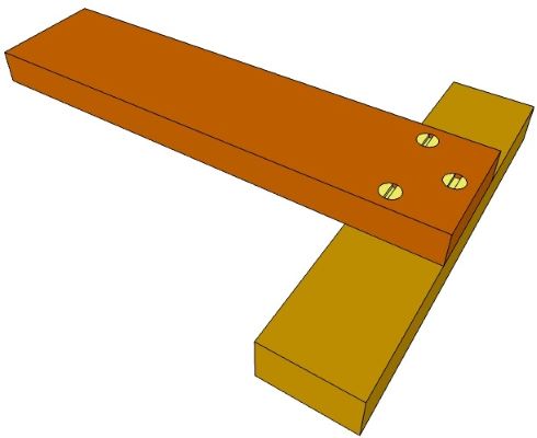

which is screwed to the tops of the trestles. Again appearance isn't critical, but that 7 x 3ft (2100 x 900mm size IS - it is the smallest size I've found capable of adequately supporting an 8 x 4ft (2440 x 1220mm) sheet of material, whilst also being small enough and light enough to be moved around fairly easily. You absolutely need a flat work table at about waist height to use a rail and saw and cut both accurately and safely. You also need a large square, which can be home made from rips of ply or MDF:

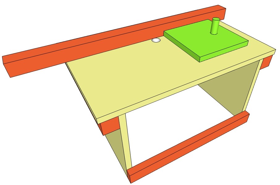

Oh, and if you need a router table (probably doubtful), that, too can be home-made using bits of MDF, 2 x 2in softwood and 2 x 1in (44 x 22mm) softwood lath:
It all starts from a simple base:
