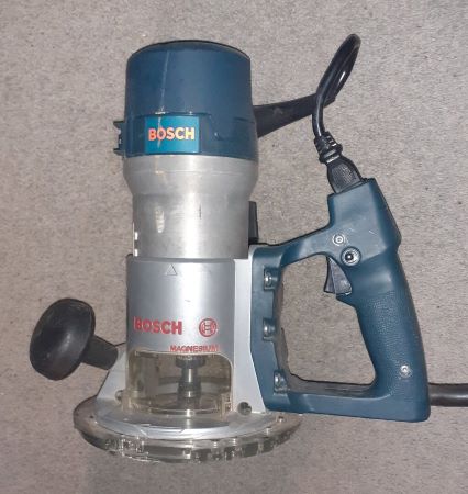

Lest I am considered biased against fixed base routers, here is one of mine, a Bosch 1618EVS (GMF1400 in Europe) with a D-handle fixed base:

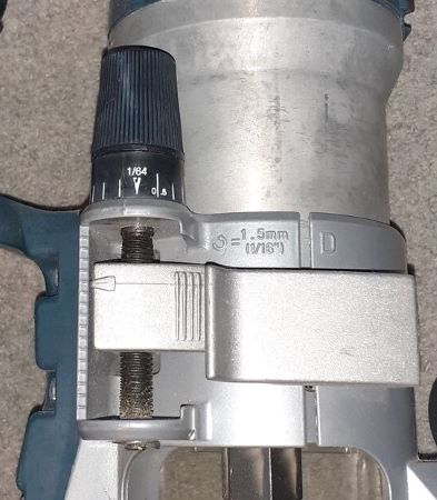

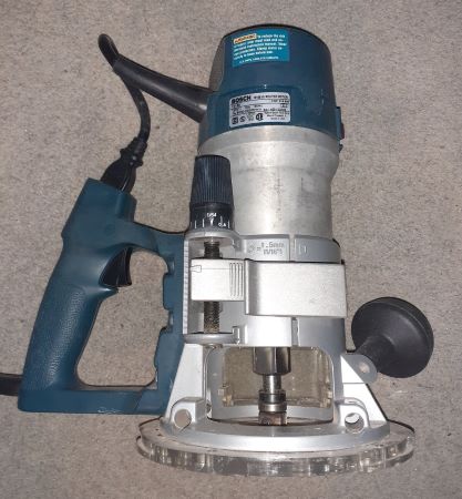

Despite being a fixed base router, I've found this design awkward to use in a router table because of the depth adjustment being so poor and hard to use when the router inverted (added to which if you undo the buckle a bit the motor falls out of the base and can hit the floor - oops):
That motor really needs to be installed in an expensive router lift to make it more useful in a router table. In fact Porter-Cables seem to be better router table routers (assuming if you don't want to spend £100s on a router lift), because they use a copy of the old screw the body in-type depth adjustment originally designed by Ray Carter. However, since P-C manufacturing went to China in the early 2000s the quality has apparently gone down a lot, and in any case, there hasn't been an official distributor of P-C tools in the UK for more than 25 years. Against that, many modern plunge routers can be used in a router table by simply installing a fine depth adjuster like this one (below) for the MOF96, which also fits a lot of other routers (e.g Trend T4/T5, deWalt DW613/DW615, Perles OF808, some of the Ferm and Power Devils routers, etc) at about £15 to £20 a pop:

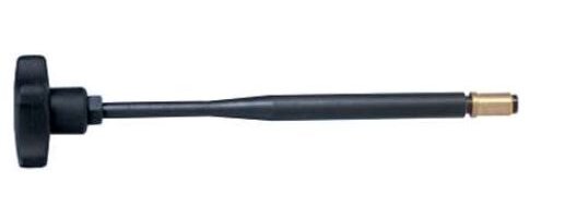

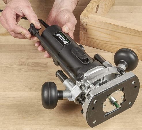

this is a fine height adjuster fitted to a Trend T4 router:
instead of using the turret and depth flag to control the plunge depth, the fine adjuster is screwed onto one of the threaded rods on the turret and is turned to very precisely adjust the depth of cut. With the router in a router table this would mean the router would function in the same way as a fixed base router (without the annoying tendency some of them, like the Bosch fixed base routers have, of falling out of the bottom of the router table if you undo the base lock). If you look on the Trend web site there is a compatibility section for a large number of routers that tells you which of their bits fit which routers. A lot of the Trend stuff either dates back to or is based on the Elu MOF96 router, partly because so many of its' features were so widely copied since the 1970s.

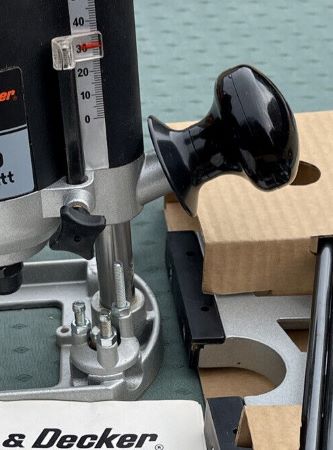

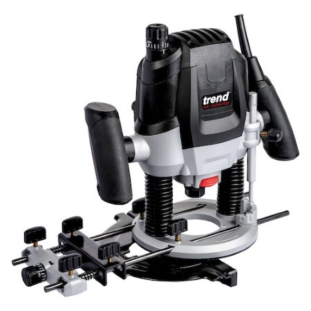

I went and had a look at the Erbauer ER2100 router - it is very similar to the Trend T7e (below), with the same type of fine depth adjuster built-in:
I reckon both of them would be useable beneath a router table, but that depth adjuster is going to be hard work unless there is some way to get a bigger diameter handle on it.

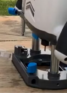

I did watch a review of the MacAliister MSR1200 on YouTube but what I got from that was that the tool has an American-style turret depth stop which lacks the adjustable screws of European style ones as on the Black and Decker SR100 to the right (below). The SR100 was a partial copy of the Elu MOF96 (with a redesigned body) made in the 1990s which was eventually renamed the deWalt DW613 and is still available in some markets:
(BTW the guy reviewing the MacAllister uses the fence wrong and at about 6:00 has the fence mounted on the wrong side of the cutter, risking a kick back - the rule is material to the left, cutter to the right, fence to the right of the cutter and push the router away from you - he keeps doing that he'll have an accident sooner or later, although at 7:00 he does correct his error, then pulls the router towards himself which is just as dangerous!!! So if you get a router RTFM - read the flaming manual)
The adjustable depth stop screws on turrets are more versatile and allow a fine depth adjuster to be screwed on and used, as on the Trend T4 above. If your router lacks that feature, a car jack really isn't a bad alternative, or something like this router height adjuster off eBay for about £8:
