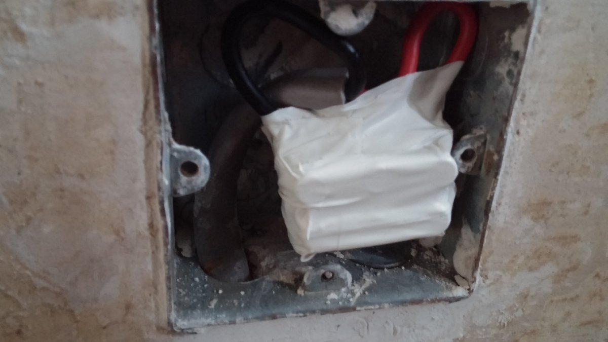

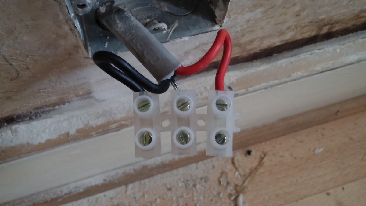

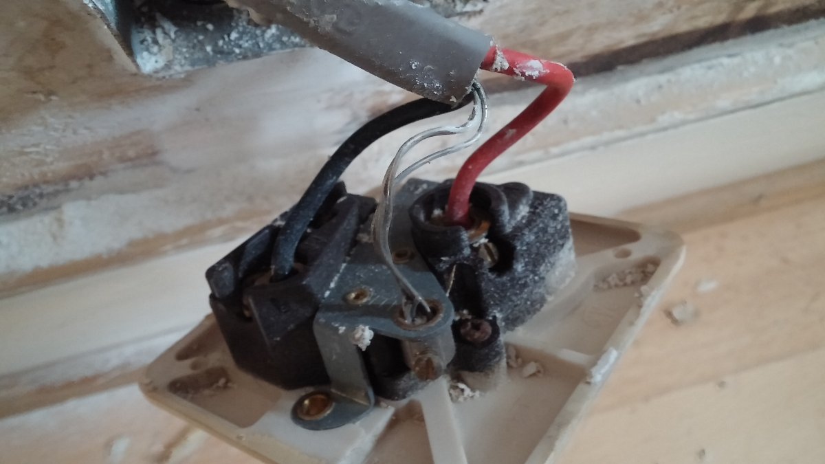

Holy thread resurrection I know, but I now find myself in the same position as the original poster.
I've discovered an old electrical socket behind a removed radiator. It didn't appear to be live, but I'm taking no chances and blanking it off.
I've screwed wires down in a terminal block, taped it up, and fitted a blanking plate.
From the photos, does it look ok? I'd really appreciate thoughts from any experienced sparkies.

Should be ok. I don't like terminal blocks if they cannot be accessed so would have used a maintenance free terminals there.
You say it doesn't 'appear' to be live. Did you test it?

No it isn't OK. You haven't earthed the exposed conductive parts.
Thanks folks. I did test the socket (by plugging in a hoover) and it didn't turn on. So I'm assuming it isn't live. (I did however cut all power before fiddling with the wires.)
What's the best way of sleeving the earth wire? If you can see, it just comes bare out of the main cable (without its own sleeve).
nobody mentioned ring continuity? :rolleyes:
is this socket part of the ring?
if it is then you need to connect the 2 reds together, the 2 blacks and the 2 ( or 3 ) earths together..
