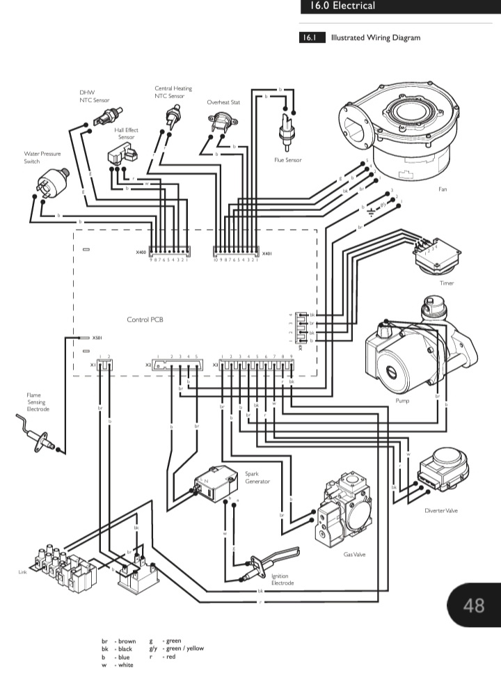

Looking at the boilers wiring schematic..

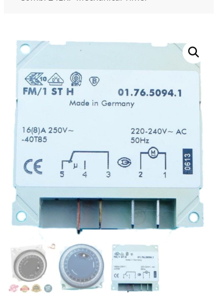

The clock is on a different terminal block to the thermostat connections - so it would be unlikely for any modifications to be made behind it, that would effect the thermostat connections.
Edit:
Actually, a link on the back of the clock between terminals 1 and 3 would bypass the thermostat connections.
It could also be linked out at terminal X3 9, but that would be a bit strange...

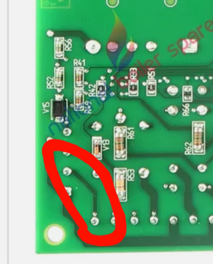

... and looking at the boiler PCB and Clock connections:
there must be a live connection to X3 9. Without this, the clock couldn't control the boiler. Where that link (or short) is made is another matter.

See previous post, the thermostat connection could also be linked out at the clock.
