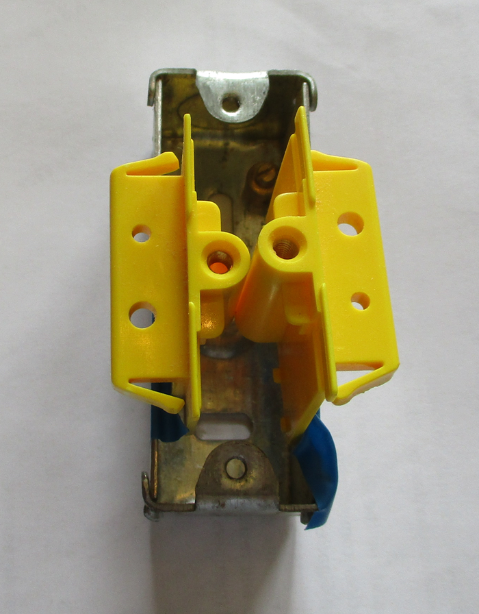

fitting a light switch flush with a Cupboard
but the plastic bits that hold the box to the plasrterboard are outside the box so the inside is free to house a switch. the screw lugs would intrude the same as a metal box
Yes, but it could only be done if they could find a way to put the 'plastic bits' at the top and bottom of the architrave box - which would be difficult, because there would then be little or no 'fixed' material left at top and bottom of the box! If they put the plastic bits (hence also the lugs, which are the problem) on the sides (as with all available plasterboard boxes), the two lugs would virtually meet in the middle.
Anyway, whether this is the reason or not, as I said it would seem that 'plasterboard' architrave boxes do not exist ...
Kind Regards, John
i'm sure appleby could make an architrave box but the demand probably would not be high
Quite. There are few enough architrave switches used in the first place, so the market for such boxes would presumably be very small - and, for 'us', the ways of doing it using metal or 'surface-mounted' boxes are not all that demanding.
Kind Regards, John

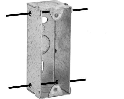

If it were me I'd drill ~3mm holes through the side walls of the architrave box, thread coat-hanger wire through the holes and bend the wire ends into small loops for screwing the box to the back of the panel.
If it were me I'd drill ~3mm holes through the side walls of the architrave box, thread coat-hanger wire through the holes and bend the wire ends into small loops for screwing the box to the back of the panel....
Yep, there are many ways in which one could do it - although I'm not convinced that it would be too easy to end up with a 'wobble free' situation doing it your way, particularly if one wanted the edge of the box to be fairly flush with the outer surface of the panel. I think that small brackets would produce a much more assuredly rigid solution than a bit of coat hanger.
Kind Regards, John
