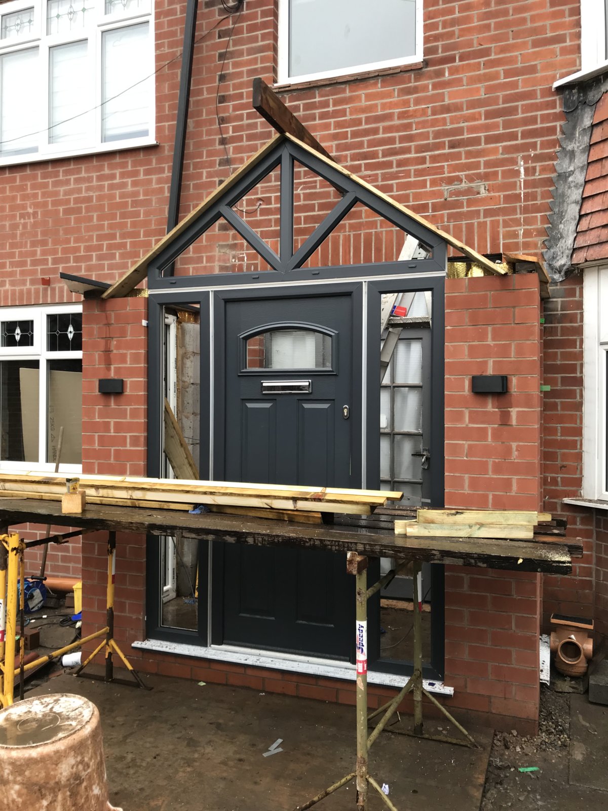

Ok, i’ve started baypoling, I like them but the heads a bit small for a PZ2.

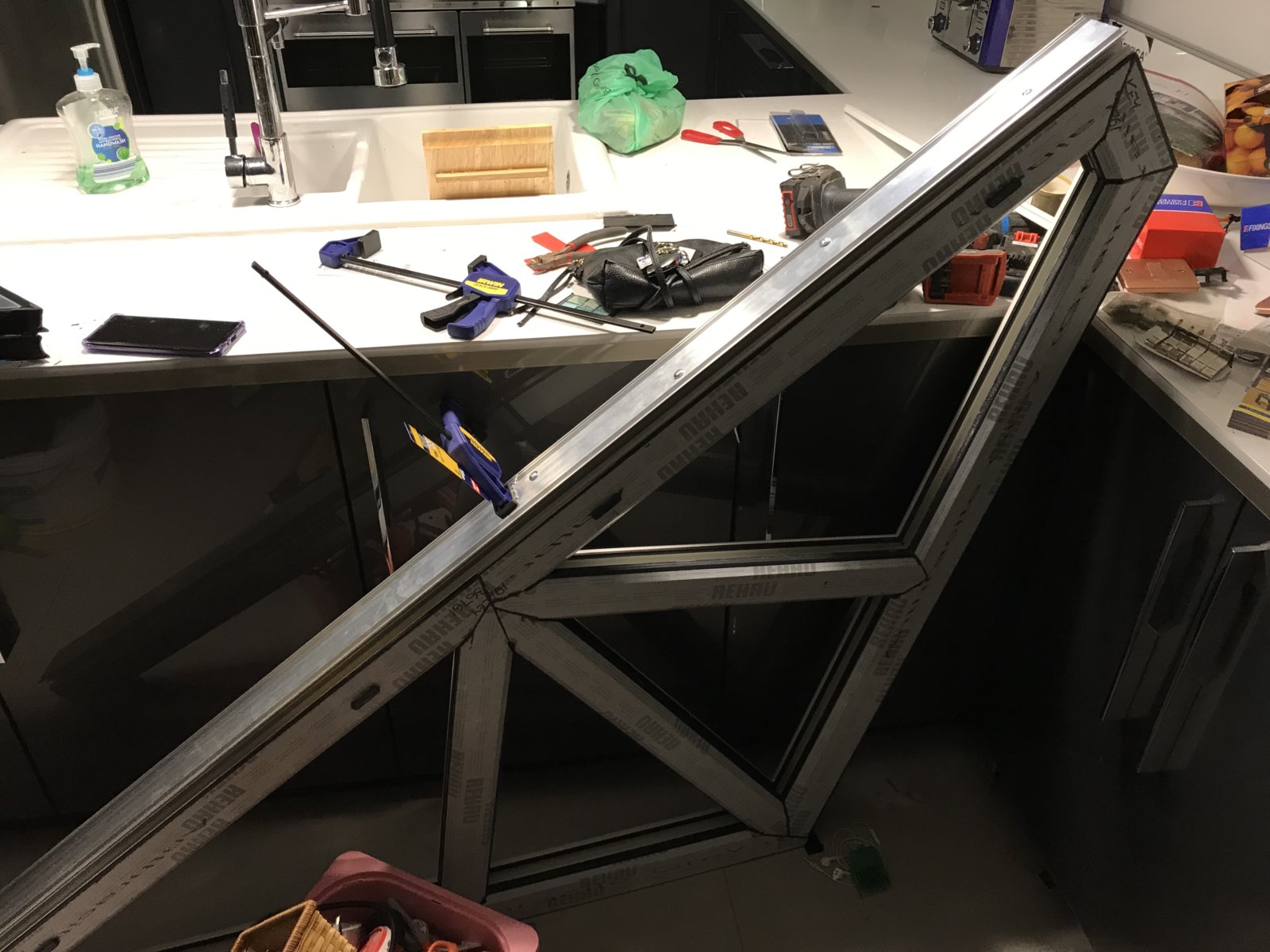

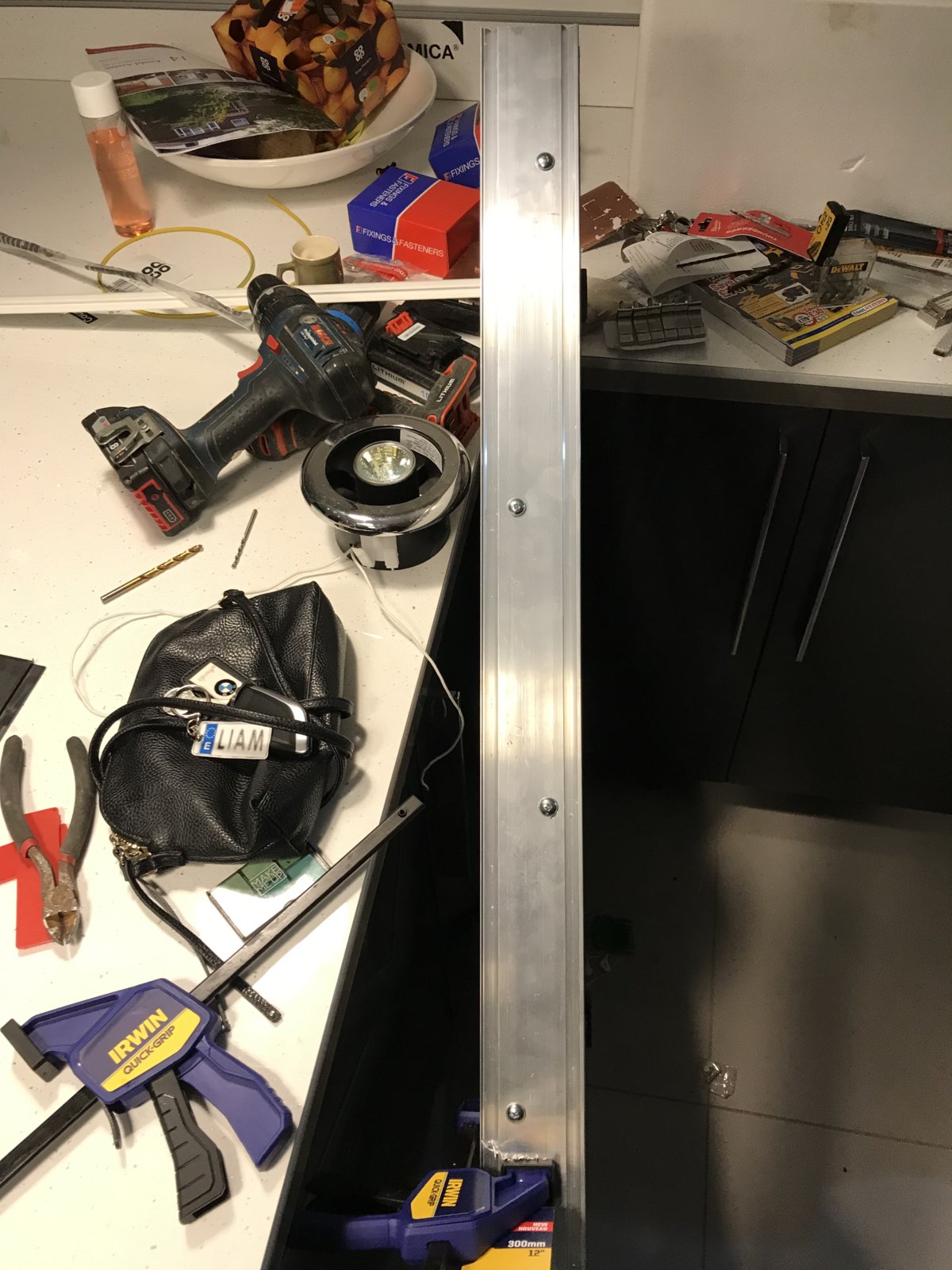

Does this look about right? I screwed them so they won’t touch the ribs on the frame, and from the underside because the frames an awkward shape
Cracking job, couplers look good, can be a bit fiddly but they will certainly reduce any whip you'll get when closing that slab, the clip on ones you linked to just clip frames together, ok if they are fixed windows but door and side panels need heavy duty ali couplers, well done good job

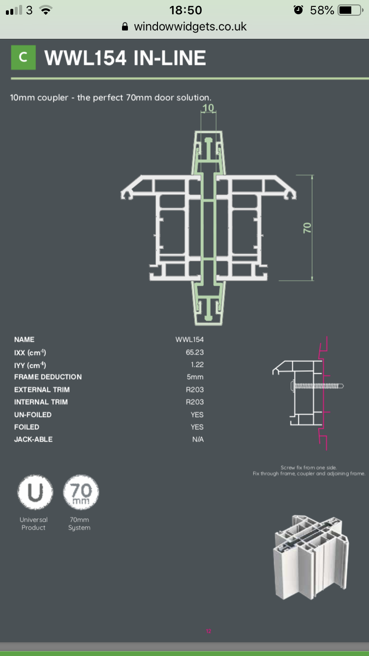

They get covered by a box that sticks out 30mm from the frame like this:

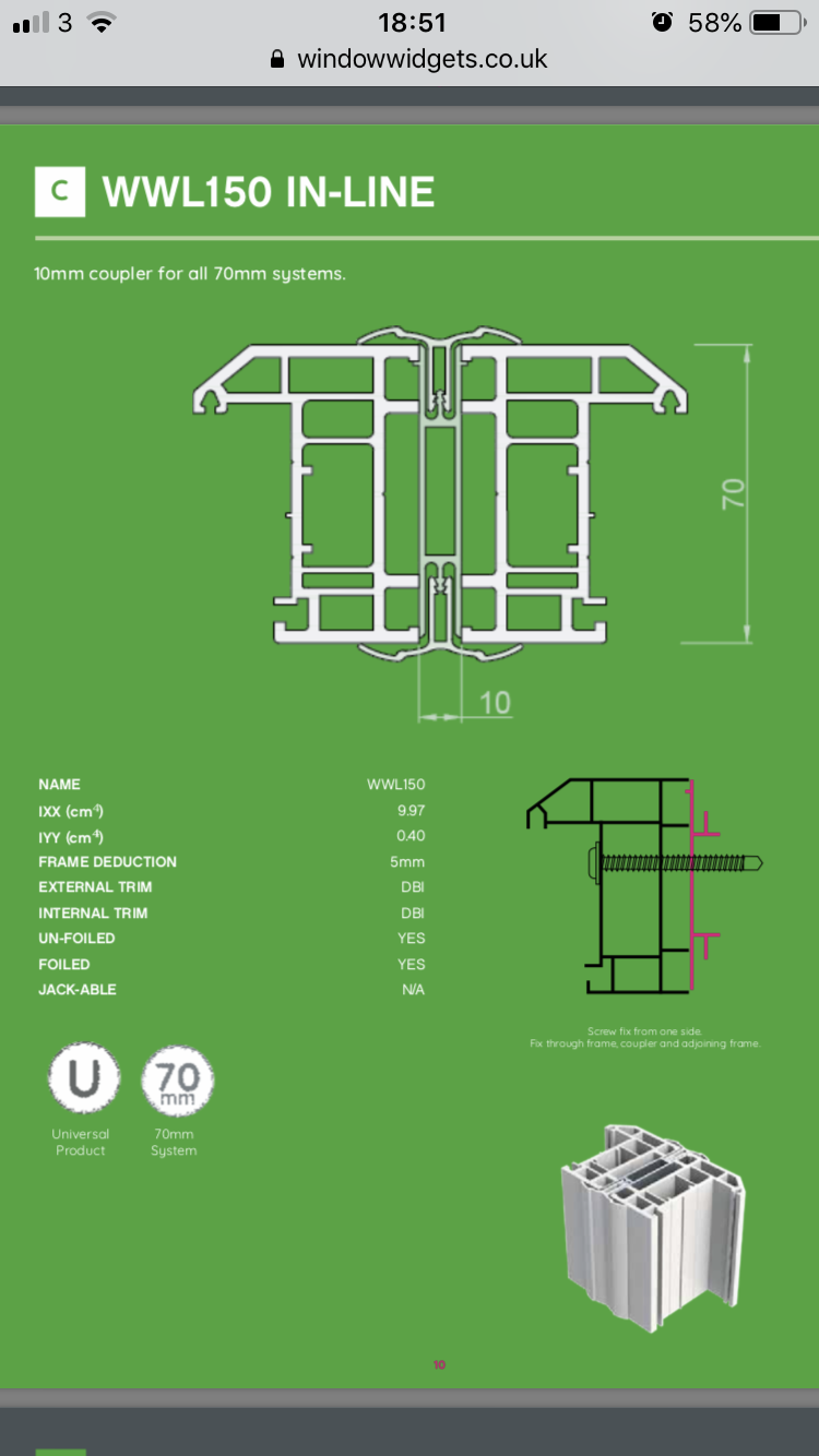

So i’m now looking for a pair of this type:
I’ve e-mailed windowwidgets for a price and also asked the supplier of the door if they can swap them.

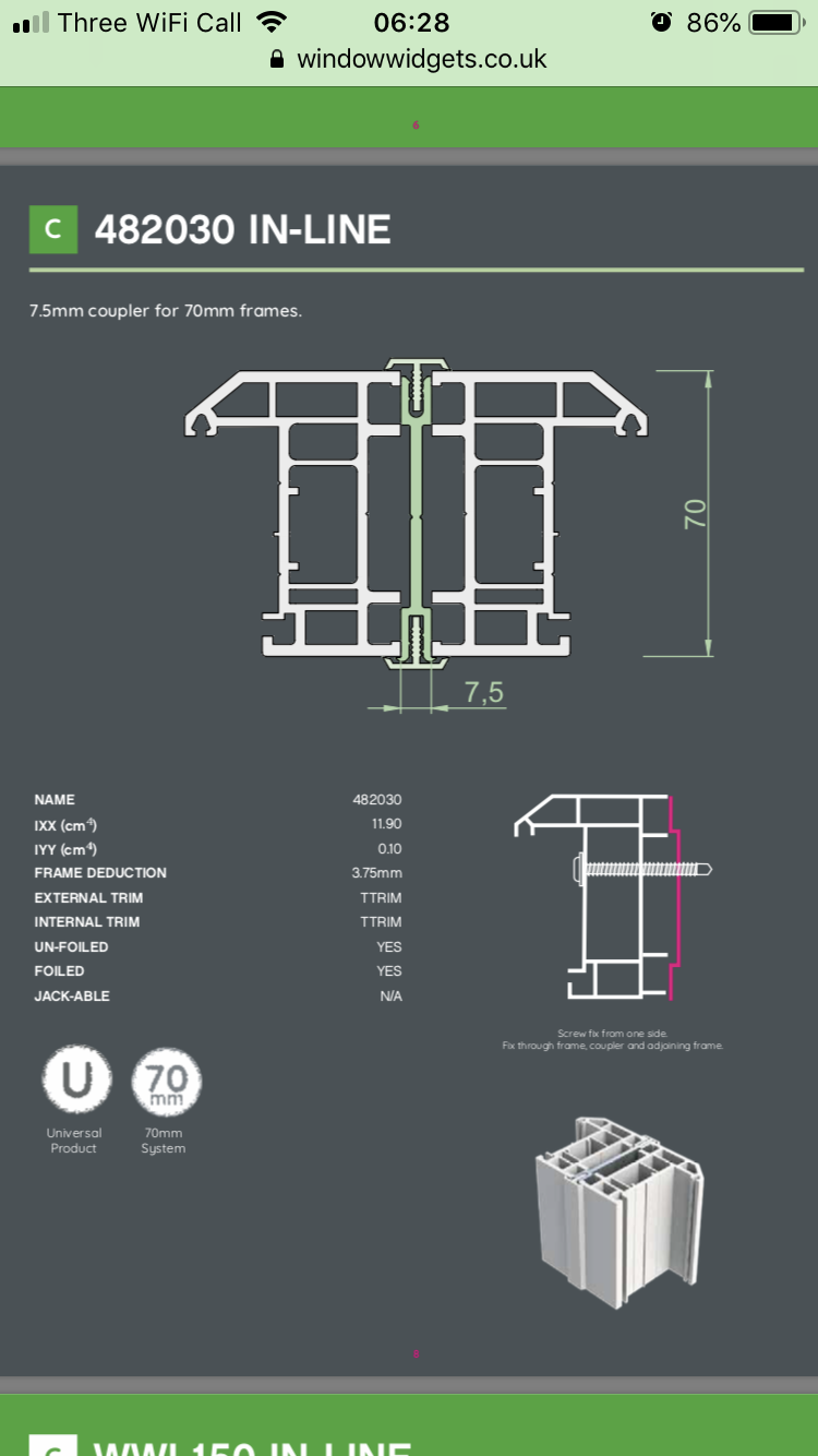

We used to get sent same as your first picture, can't say I ever liked them . Changed supplier about 6 years ago and now get the type in your second picture, much better finish all round imho. You shoyld find they are very similar to the ones you had on your first door
Yes, the trim is the same so it should look identical.
The supplier is refusing to swap them, Window Widgets won’t deal with me direct. The supplier has an account with Window Widgets but won’t order them for me :confused:
Any idea where I can buy a pair of the WWL150 style ones?

Thanks :). I got some smaller ones from a place called Windowplas in Bolton, £22 for the couplers and trims.
They are these ones:
The wider bits catch the ‘fins’ on the door and while they are smaller the metal is thicker so hoping they will do the trick.

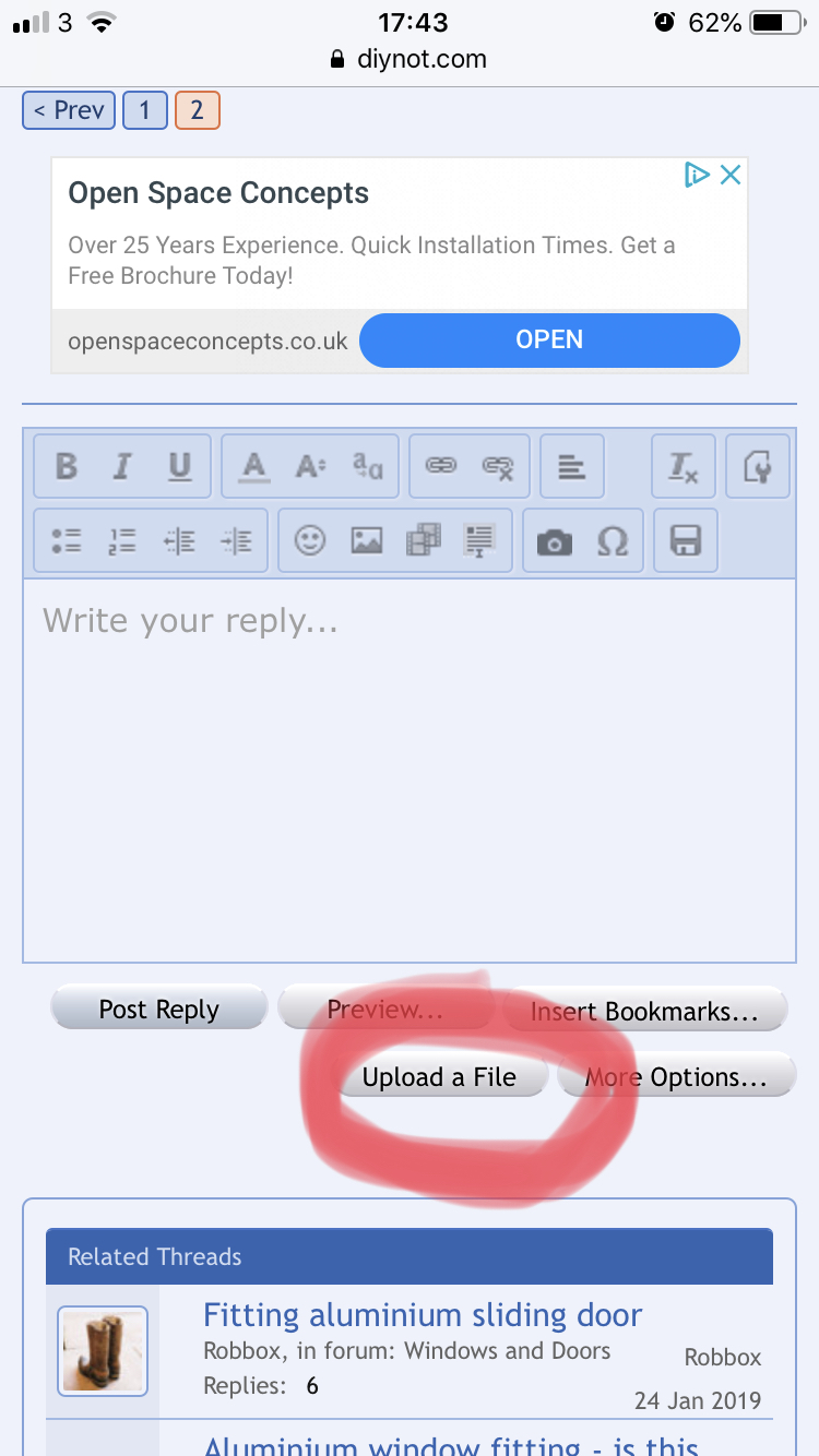

Hi Ian

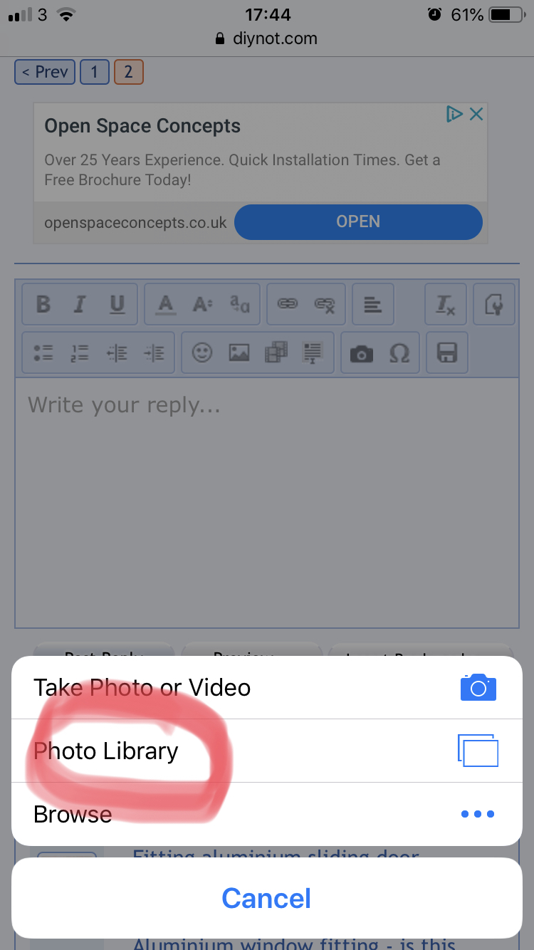

You seem to have got the knack of uploading photo's from your phone. How do you do it ?
I just click on this:
And then this:
That’s with an iPhone, so not sure if yours may be different?
Ahh I think that's my problem I'm using a lap top!
Is that an DIY not app. your using on your phone?
