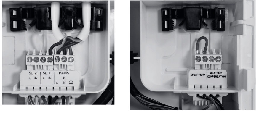

If I had a modulating boiler able to use OpenTherm OT-lodgic.jpgI would not even consider Hive, I don't I have an oil on/off boiler so Hive for me is a consideration, however a Hive TRV head is similar price to a Wiser TRV head, and the big expense is the TRV heads as you have, or at least I have so many, so why spoil the ship for a halfpence of tar?
I would hope where we see an OpenTherm enabled boiler with on/off control it is because the boiler has been changed without updating the controls, so I would expect to find a wiring centre which is a remnant left behind when new boiler fitted. Have a look where likely there was originally an airing cupboard.
One could put Hive where the programmer is, and turn old thermostat to max, or replace old thermostat with a blanking plate and link the controls there, however the question is where will the Hive go? Hive is designed to receive a "demand for heat" from the TRV's as long as where it is located is not over 22ºC, so located in the hall likely fine, as we would not normally have a hall that hot, but in the living room can be counter productive as if living room hits 22ºC then it will stop heating other rooms.

There is also Honeywell Evohome, and Tado (If correct on selected) which work with OpenTherm, but Drayton Wiser uses same back plate as Hive.

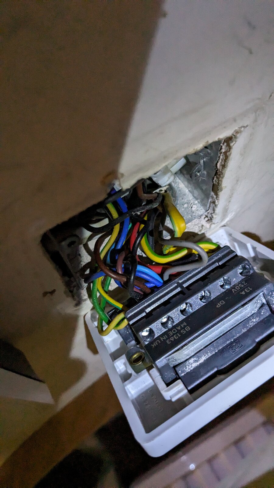

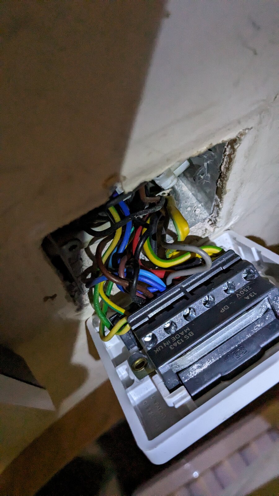

I will try and post a better picture tonight but the spur didnt seem able to come away much more.
Am I right in thinking that it might be easier disconnecting the stat receiver and programmer from the spur and then wire it directly into the boiler using 5 core cable. If it starts to get too complicated I'm happy paying someone to change it rather than risk it.

Behind the FCU, I believe you should find four cables.
The mains supply to the FCU, a 5 core flex to the boiler, a 5 core flex over to the nearby stat and the flat, grey, triple and earth wire to the downstairs programmer.
As I was (perhaps poorly!) trying to explain to @CBW, with a little investigation, we may be able to discover how this triple and earth cable is connected.
If that can simply be removed, then the 5 core flex cables between the boiler and stat, are already in place and with a small modification, everything will work, without having to remove any more cables.
If it looks too complicated, after getting a better photo of the FCU, there's no harm proceeding with new wiring, but again, if you want to decommission the programmer, we need to ensure the triple and earth is fully disconnected.
An alternative (but not ideal), could be to keep the wiring to the programmer in place, connect the black (switched live) and brown wire (live), together in a wago, safely isolate the earth and the grey (neutral) wires in separate wagos, and then cover the hole in the wall with a blanking plate.
Then as in post 2, the grey wire could be moved from terminal 2 to terminal 1 of the stat backplate, ready for the Hive.

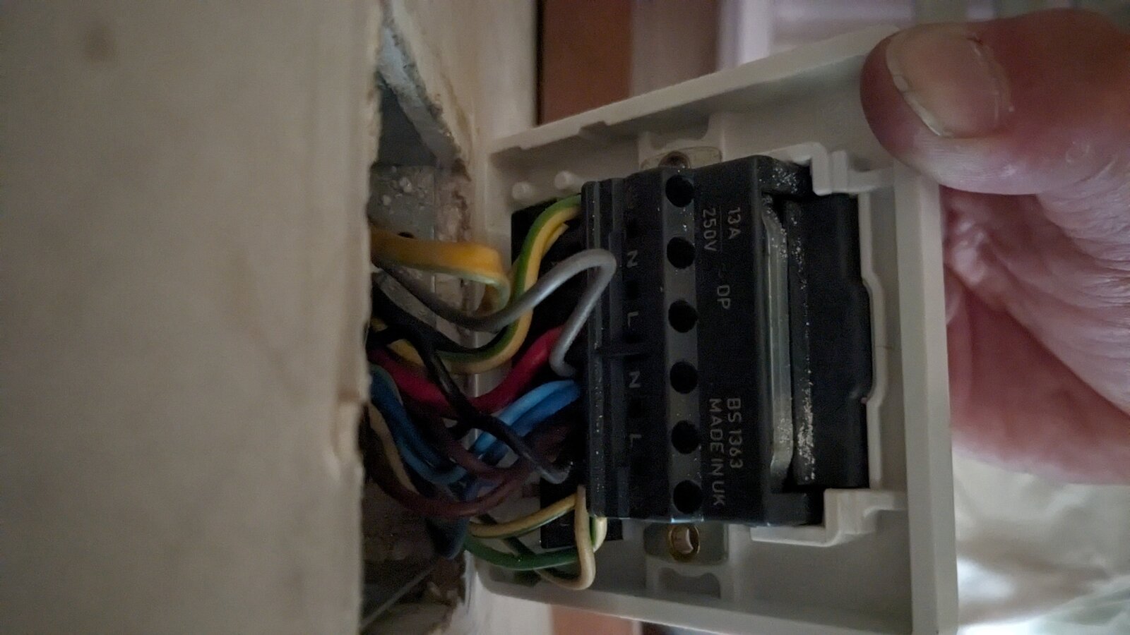

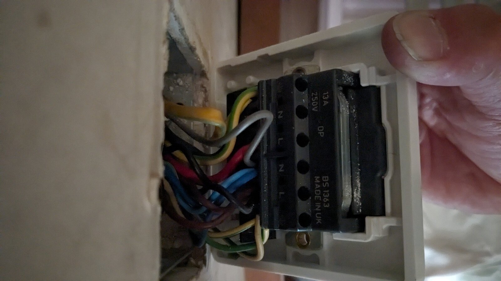

These are as good a picture as I could take.

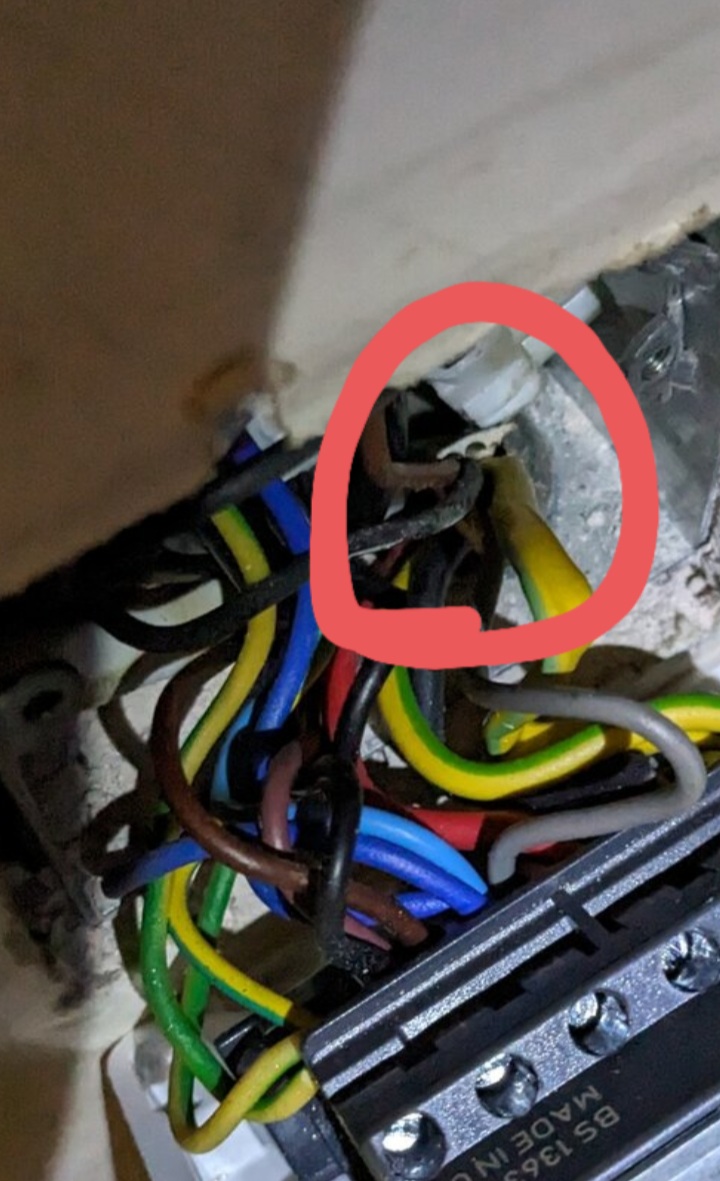

Better - but not quite there for a full diagnosis :)
This appears to be the flat grey triple and earth that connects downstairs to the programmer...
Where the brown wire of that cable comes from, and where the black wire connects to, are what we are interested in; the grey wire can be seen to connect to Neutral which is expected.
The plastic terminal blocks above the cable are probably related.

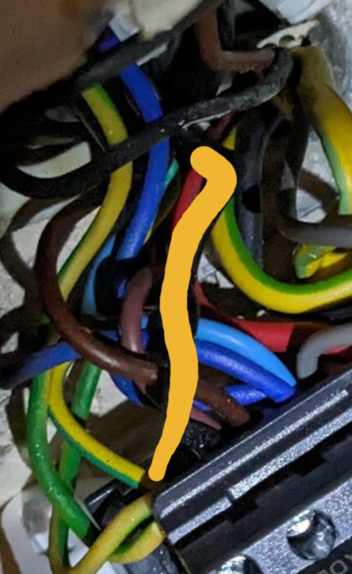

The brown wire goes into a block with a black wire that i think comes from the stat receiver.
The black wire goes into a block with a grey wire which I also think comes from the stat receiver.
Thank you for that.
I believe that means we can just connect the wires in the two blocks together into one connector, and the triple and earth can be completely disconnected.
But give me some time to confirm the logic, before attempting anything! :)
That black wire goes from live in the spur into 2 core flex and disappears to what looks like the boiler. The other black cable in the 2 core flex goes into a connector alongside a brown wire which also looks like it goes to the boiler. It certainly doesn't go to the stat receiver as I can see the cables for that.
Ok, I wasn't expecting a 2 core flex; that suggests there may be further connections that we can't see.
Because of this, I can't be certain of how your system is wired; feel free to ignore the following!
I still believe that the grey, 3 core and earth cable connects to your programmer.
My next step, would be to disconnect the brown wire from the connector block (isolate it safely), and see if your existing programmer has lost power and does not turn on (hopefully it doesn't have battery backup!).
If that is the case, we know we have the correct cable.
As the programmer is basically a switch that connects the brown wire and the black wire together...
The black wire and the grey wire on the other side of the connector blocks can safely be joined together.
That should, theoretically, bypass the programmer.
If the boiler then behaves and responds correctly to the thermostat, it's hopefully an easy switch to the Hive and all the connections to the grey cable can be disconnected.
If this doesn't work, then it will be a case of redoing the wiring, or recruiting some professional help.
