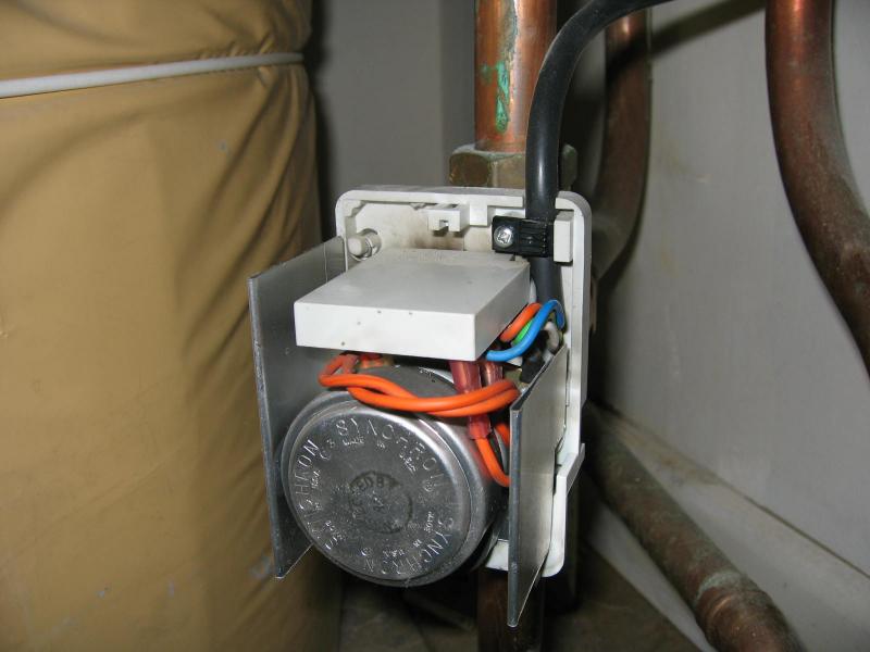

CH on and HW off is pointing at H, but not coming on, so the micro switch, in the actuator head. Where is the actuator head? Can I change that?

The actuator head is the top part of the whole 3 port valve. that you've been testing
Don't know what make your valve is, but can usually just change the head without changing the valve. Fairly straight forward.
Isolate boiler power and remove fuse. Remove securing screws and lft head off the valve spindle. Remove the related wires from the 10 terminal box. ( should be White, Grey, Orange, and Blue. and a green earth if there is one) Fit replacement head in reverse order.
I took an easier option instead of messing around in the 10 terminal box. I mounted a 25mm deep switch patress on the wall. cut the existing cable and put the wires into a 5 terminal strip mounted inside the patress. Put the new cable into the strip like for like and fitted a blanking plate.
This will have a distinct advantage in the future when testing. Especially if the micro switch is suspect, cause I can easily link white to orange to test.

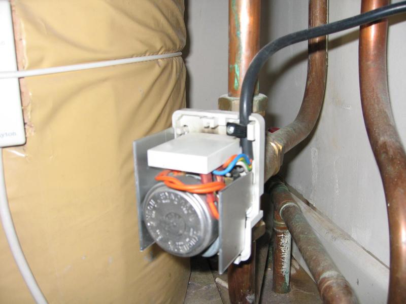

I've bought a new actuator and I'll be fine changing wires etc over. The problem I have now is how do I get the exisiting switch detached?
Looking at the new one is not giving me any clues, will the old one simply pull off? I can't see how its attached to the pipe work.

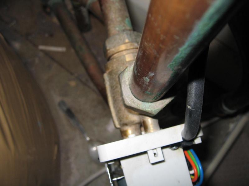

Don't know about your actuator, but I doubt if it will just pull off.
On photos 1 and 4, I can see what looks like solid brass pillers behind the head. Securing screws have to secure to something and apart from these pillers it seems to be space.
Look at your new one to see if any holes that match the position of pillers.
Perhaps if you stated the make of the actuator head, someone may know the answer.
The one that is currently on is:
ACL Drayton
Mid position valve 22mm
679H340 - 3OLO
And the repalcement actuator is acl drayton MA1
They look similar, but are not an exact match, as the back of the new one looks different to the back of the one that is on, but they are approx the same size, shape etc

Suggest you do search for author 'goosander' on this forum. Seems he had similar problem and was informed the older valve did not have removable head, but the latest model does.
Based on that it seems you need a complete valve with head and not just the head. I noted a technical helpline 0845 130 5522 if you think its worth enquiring.

Done the search and see what you mean. The thread does mention that the microswitch is interchangeable though? Are you able to tell me what that is? I guess if I change it and it works great, if I change it and it doesn't I can put the other one back on?
A full drain down and change of valve is beyond me, happy to get a plumber although I suspect they may well be in short supply at the moment :D
