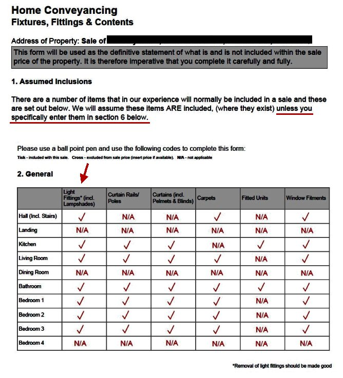

If that is what happened he should make a formal complaint to the vendor, unless he bought it like that, as they were not supposed to remove the lights, and could probably be held liable for the costs of replacing them.
Doubtful that any contract which permitted persons to leave bare wires hanging from a ceiling would be considered valid.
That is probably true. The standard conveyancing forms certainly have provision for light fittings to be excluded from the house sale, but (as you can see here), also require that removed light fittings "should be made good" - which I presume probably includes making things electrically safe! ....
