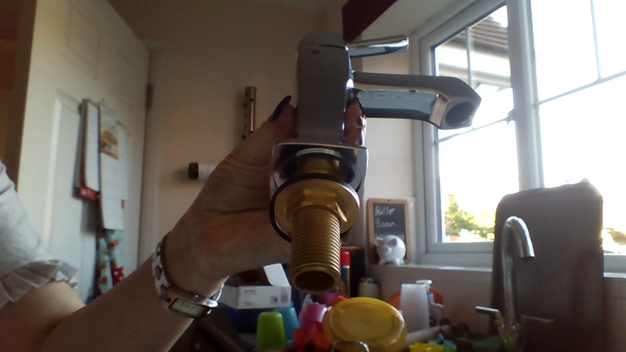

Hi All,
This is my first post so here goes...... I've bought some new taps for our bathroom and the thread on them is slightly longer than the old taps. My question is, how can I fit them? There is an isolation valve attached to a copper pipe approx 25 cm long which joins onto the current taps.
Thanks in advance.

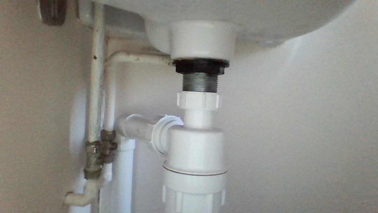

Can you post a pic of the pipe and tap connection so people can see what sort of pipe connections you have. :)
Here's a picture of the taps and the setting under the sink:
if you undo the upper compression joint on the service valve, and carefully measure how much too long the pipe is, you can use a Pipe Slice (a tool that cuts copper pipe cleanly and accurately) to cut a bit off.
The old olive might be a prob if it is tightly indented into the pipe, unless you buy a new piece of pipe.
The pipe slice will be useful if you ever do more plumbing.

I don't know if it's a trick of perspective, but that tap looks like a bath tap:unsure:
is that a bath tap you are holding in pic? it looks quite large for a basin?
It is a sink tap I have matching bath taps and they are bigger. I do have tiny hands :)
if you undo the compression joint on the service valve, and carefully measure how much too long the pipe is, you can use a Pipe Slice (a tool that cuts copper pipe cleanly and accurately) to cut a bit off.
http://www.screwfix.com/p/monument-tools-automatic-pipe-cutter-15mm/12468

You would be wise to replace the fibre washers on the tap connection end do not try to reuse them unless they are rubber in which case you might get away with it but new are best.
It would be a good move Emma, to remove the paint from the pipe work unless you intend to renew it......always a plumbers nightmare!
Nitromors removes paint, if you give it long enough.....brush it on, wait and then wipe it off.
Flexible pipe connectors would be the easiest way here, as there isn't any vertical movement in the existing pipes at all.

How do you know the thread is longer? Have you already removed the old ones?
If the new one IS longer, it may not be by much. You may well struggle to use a pipe slice to trim a very small section, and you will have to remove the olive. Save your tenner you will spend on a one use pipe slice, and buy a decent junior hacksaw. You may need to saw a cut diagonally across the olive, insert a small screwdriver in the cut and twist. This will open the olive to remove. Fit taps, using a "top Hat" washer on each, and new fibre washers. Offer the pipe up to the tap and mark the pipe at the appropriate position. Cut and fit, using new olives in the iso valve.
Alternatively, buy flexible connectors with a built in isolation valve, turn off water at mains, remove old iso valve and fit new to the existing remaining nut and to the taps.
