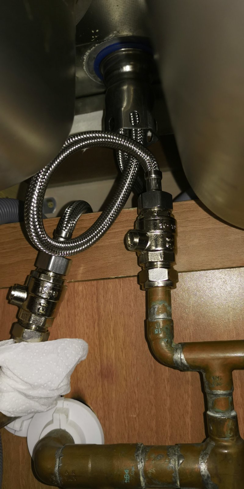

Connecting tap tails to isolation valve

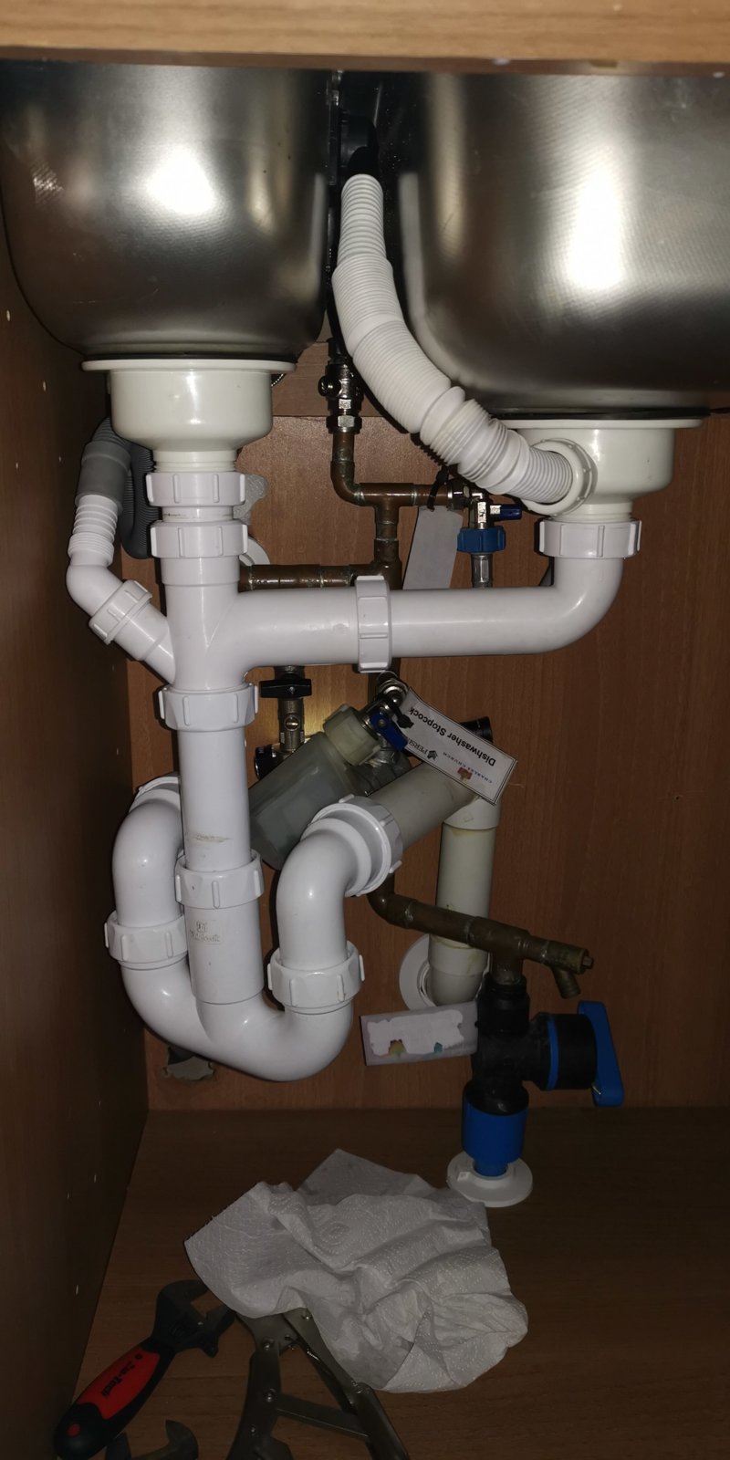

Well we've water again waste pipes fitted back and no leaking.
Just the cold flexi pipe which worries me
I might call a plumber out to fit Copper tap tails for please of mind as I'm worried about coming downstairs in the morning to a flooded kitchen.

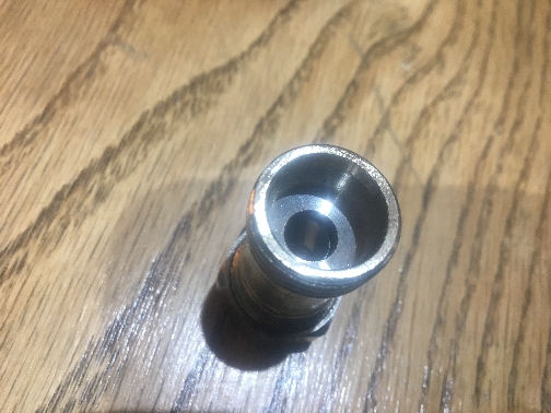

You could always use bent ballofix valves to send the flexis away from the pipe... They don't need to be full bore for a sink!
Full bore is used on gravity ,not mains,and your flexi hoses will restrict the flow anyway. The screwfix one is not suitable ,it has a female end. The other one in second link is OK ,but I would use a tap tail adaptor into its compression end ,rather than connect the flexible hose to it directly.
Thanks for the help.
Why would you use a tap tail adapter rather than just screwing it direct? Just wondering? Is it more secure?

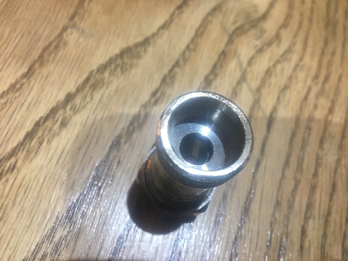

Its a compression fitting ,olive and nut. Intended for a pipe to be inserted into it. The inner face is tapered to accommodate the olive and the edge ,which your flexi hoses rubber washer will contact ,is fairly sharp. The tap tail adaptor has a flat face ,so your rubber washer sits on a flat surface. Some people just file the isolators sharp edge to a flat surface. Why bother when for a couple of quid you can buy the correct thing .

Most of my plumber mates do the same... But they haven't had a flexi failure in their own home... I have! :eek:
Just waiting on some tap tails then I'll make the changes,next problem will be changing the old sink hoping it comes out okay as I don't fancy damaging the work surfaces
Ps... You can also use 1/2" rad valve tails... I've always got dozens of them on the van ;)
Yes, spare 15mm rad valve tails are handy for that job and also look neat if chromed you match chromed isolating valves.
But something to think about is the rad tails are not BS approved for potable water. The brass could have a high lead content.
