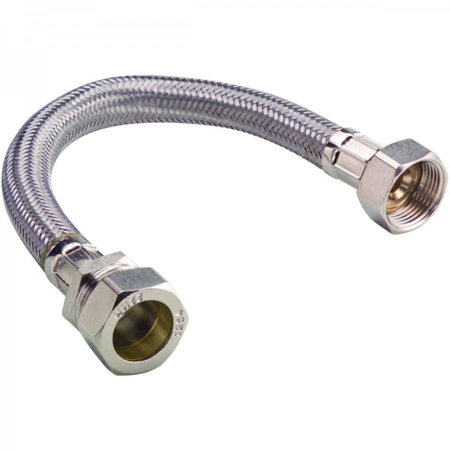

Due to the limited space, it it possible to use a flexible (instead of a rigid 22mm copper pipe) in the return pipe near where the Magnabooster will fit.
See photo FlexiblePipe of the sort of thing I had in mind.

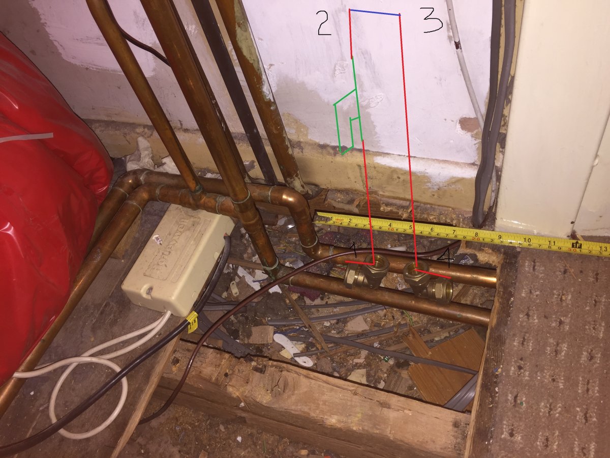

Update:-
I've removed the floor boards and created a bit more space. But it is extremely tight there.
I have some compression fit elbows (22mm) and am thinking of fitting them at the corners marked 1,2,3 & 4
The return pipe would be cut at 1 & 4, hopefully i can get a pipe slice in there.
The Magnabooster will go in the bit marked in green (obviously it is not to scale).
However the bit marked in blue, I think this will be too short so I won't be able to fit a pipe there with the compression elbows.
Any thoughts on how to complete this.
Going up isn't an issue, but going horizontally form 1 to 4 is extremely tight.
From 2 - 3 (blue) you could use a U-bend... http://www.ebay.co.uk/itm/15mm-22mm...rn-bend-plumbing-diy-new-u-bend-/161161553662
If so then it may well be better all-round to get a plumber in to solder 90 degree bends off the return flow pipe as well as the U-bend. If you decide to get someone in to solder make sure the filter is fitted between 1 - 2 before that final 90 degree bend is soldered!
I would also feel inclined to support this additional pipework to the wall with a couple of pipe clips (along 3 - 4 may be best place for that).
