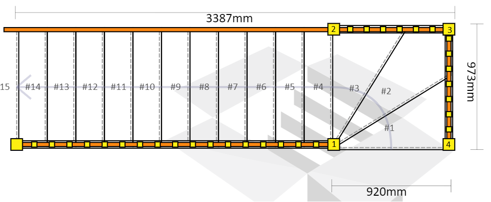

Looking to have this staircase up to our loft conversion, fitted over our existing ground floor stairs:

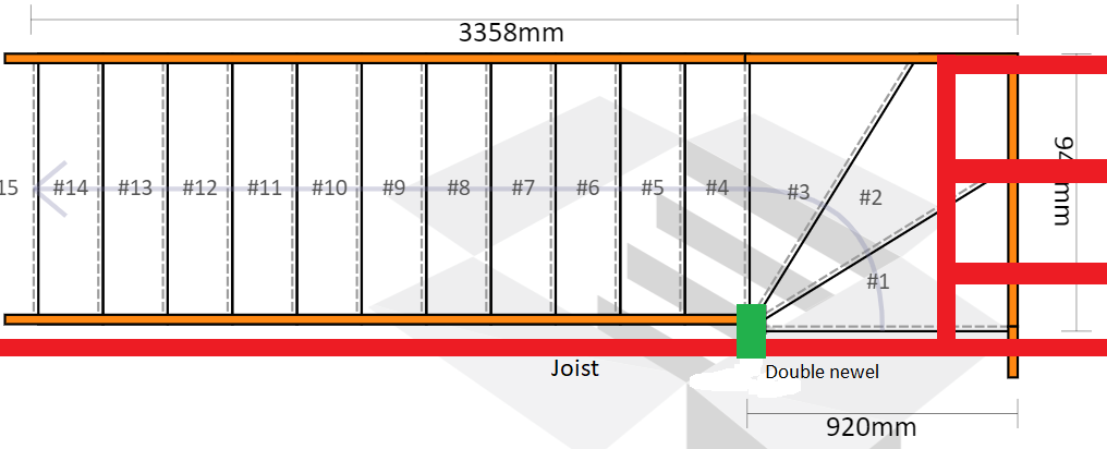

This is how it relates roughly to the existing first floor joists and stairs opening in red (ie the joists below it, note this picture has missing newels/balustrades):
My question is about how to fix the newels - I assume all freestanding newels should be notched over a joist for strength?
Also, I know it's normal to double up top trimmers, should bottom joists be beefed up as well? Is there any guidance on what should be done/what sizes are considered big enough? The full parallel joist and trimmer are 65 wide, cut joists 50, all 200 deep. Full joist has a span of 3m.

- Newel 3 and 4 are between/next to joists so I can add noggins if needed so that they can be notched over some joist, fine
- Newel 2 is against a wall, bit of a funny layout as the wall is stepped (hence the extra balustrade) but I've no real concerns here, either fixings into the wall or build a small stud wall to make the wall flat and fix the newel and back winder stringer to that (manufacturers have recommendations for how the stud wall should be constructed)
- My problem is with newel 1. As a single newel it ends up 10-20mm away from the joist. I can't make the stairs wider as the newel wouldn't line up with the existing top newel on the ground floor stairs (need a balustrade in between them). I can't move the joist inwards as it will foul the ground floor stairs balustrade
