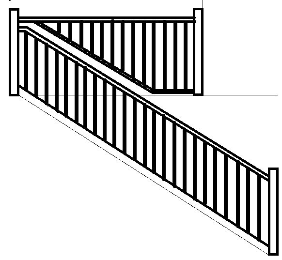

With all this 'going round in circles' I'm doing, I've thought of this latest idea.. let me know your thoughts :
With the newels being aligned on the same vertical plane, why not make this a feature instead of a hindrance..
newels inline on vertical plane.JPG You can just about see the three newels aligned in this shot.
So, I'm thinking a full length handrail/baserail/spindles on the stairs between the existing newel centreline, and then a handrail with modified baserail and decreasing length spindles (all on the same vertical plane) on the landing..
I sketched this to help describe it :

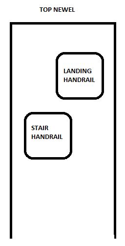

The main issue I see here is the gap between the edge of the stair handrail and the landing apron on the way up..
Once I've added say 10mm (for plasterboard/ply/mdf) as a fascia to finish the side of the trimmer/joist, there'd only be about 5-10mm gap for hands/fingers to pass..
Possible solution : Have the stair and landing balustrades slightly offset from that vertical plane between the newels, like this ? :
Not sure I could pinch enough width though, even with the handrail up to the edge of the newel....
Another idea to add to the mix... With each of these ideas having their own set of 'niggles' to over-come, am I best just going whole-hog and replacing/repositioning the newels.........?!?!?!? Sigh :)
yeah that is a possibility and though rare is not unheard of on a single balaustrade, and I suppose would be compliant provided the gap between the stair spindles and the apron was kept below 100mm, however the stair balaustrade might look a bit strange like that.
I would stick to either offsetting the handrails from the existing newels or repositioning them.
Just to add another equation into the mix have you considered just replacing the whole flight, you could then cut your newels in properly would only add about £150 to the whole project.
