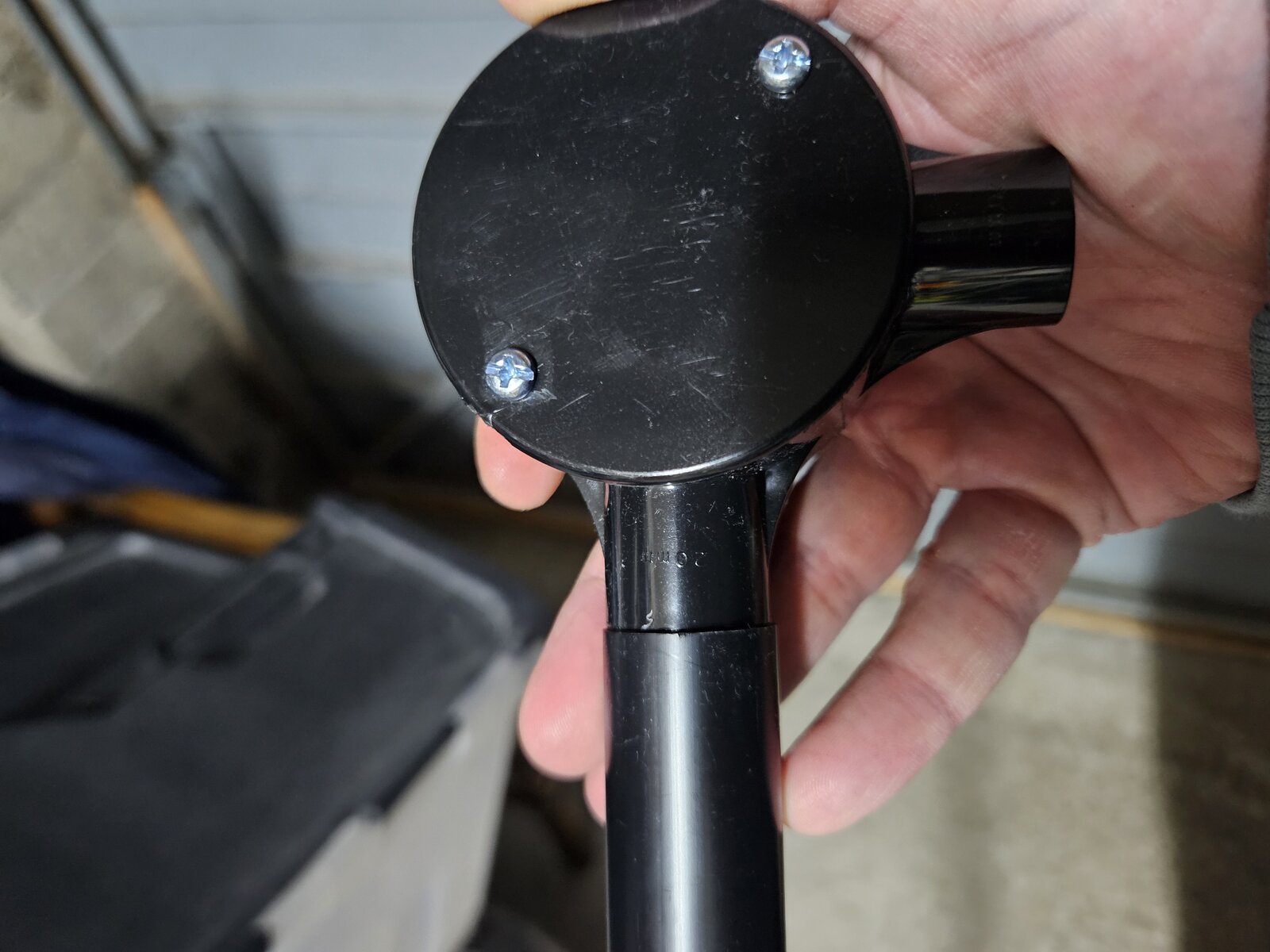

Hi guys...just needing a bit of a sanity check here. I bought 20mm plastic conduit and 20mm T boxes & elbows. Should those fit together??? I'm trying to get the conduit inside the connector, they both seem like exactly the same size! Photo attached.
Am I doing something wrong? How do I join those?
Yes.
My best guess is the supplier sent 25mm conduit by mistake. Can you measure it?
In my experience; internal diameter of 25mm conduit is likely to be around 20 to 22mm, by assumption the external diameter of a 20mm socket is likely to be a minimum of 22 up to 25mm.
That looks like 25mm conduit to me.
That 'conduit' is more likely to be black PVC overflow pipe, which is a few mm larger than conduit.
The overflow I've used is 3/4" or 22mm, I believe that image shows something bigger than 22mm.
Mate, you're exactly right...I went to take a quick photo of the conduit and noticed it's 25mm Must have been a long day, that's all i can say about that!!!!
