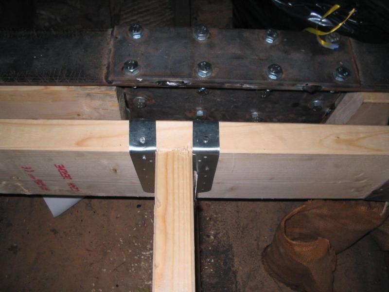

this is the bolted and welded join between two steels the same amount of bolts are also on the vertical plates across both beams.

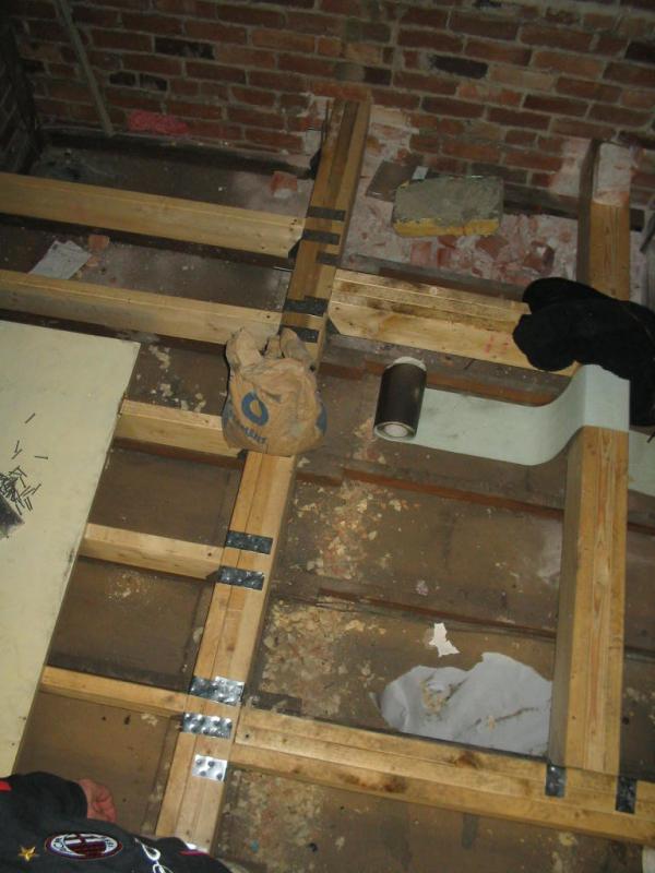

this is veiw of the stairwell triple trimmer joist area,its very small as we are using the paddle stairs which Iv been told are more 61o than 41o ?

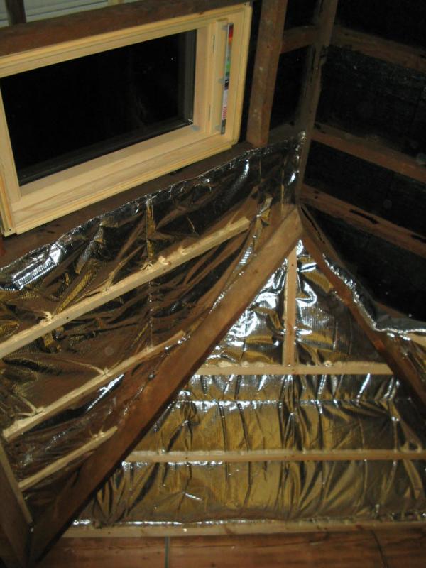

just a shot of the window,should be another one up soon.

The 'space saver', paddle or alternating tread stair is an exception to the 42 deg. rule for loft conversions where it is accepted that space might be tight. Personally i hate them and if you are going to be using this room regularly ie for a bedroom then i would do everything you can to get a proper staircase to fit. There is no minimum length for the landing at the top and bottom of a flight of stairs - it must be at least as long as your stairs are wide, so if your stairs are 800mm wide, your landings must be min 800 x 800mm. Also, if there are any doors onto the landing, and they open onto the landing and not into the room, then the door swing must be at least 400mm clear of the top or bottom stair nosing.
