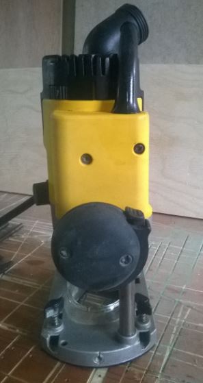

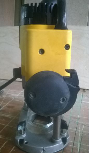

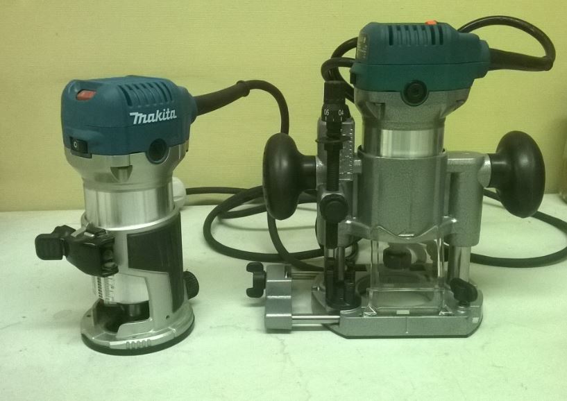

Follow up photos of deWalt DW622 and Makita RT0700CX in plunge base
and the Makita RT0700CX in laminate trimmer base with Chinese clone motor in plunge base
The DW622 has circa 52mm of plunge depth, the RT0700C and clone have about 30mm depth of plunge.On-off lock on DW622, off:
and locked on
In comparison to my old 600 watt Elu router of the early 1980s (MOF96) that Makita is tiny - the DW622 is maybe 10% bigger IMHO
