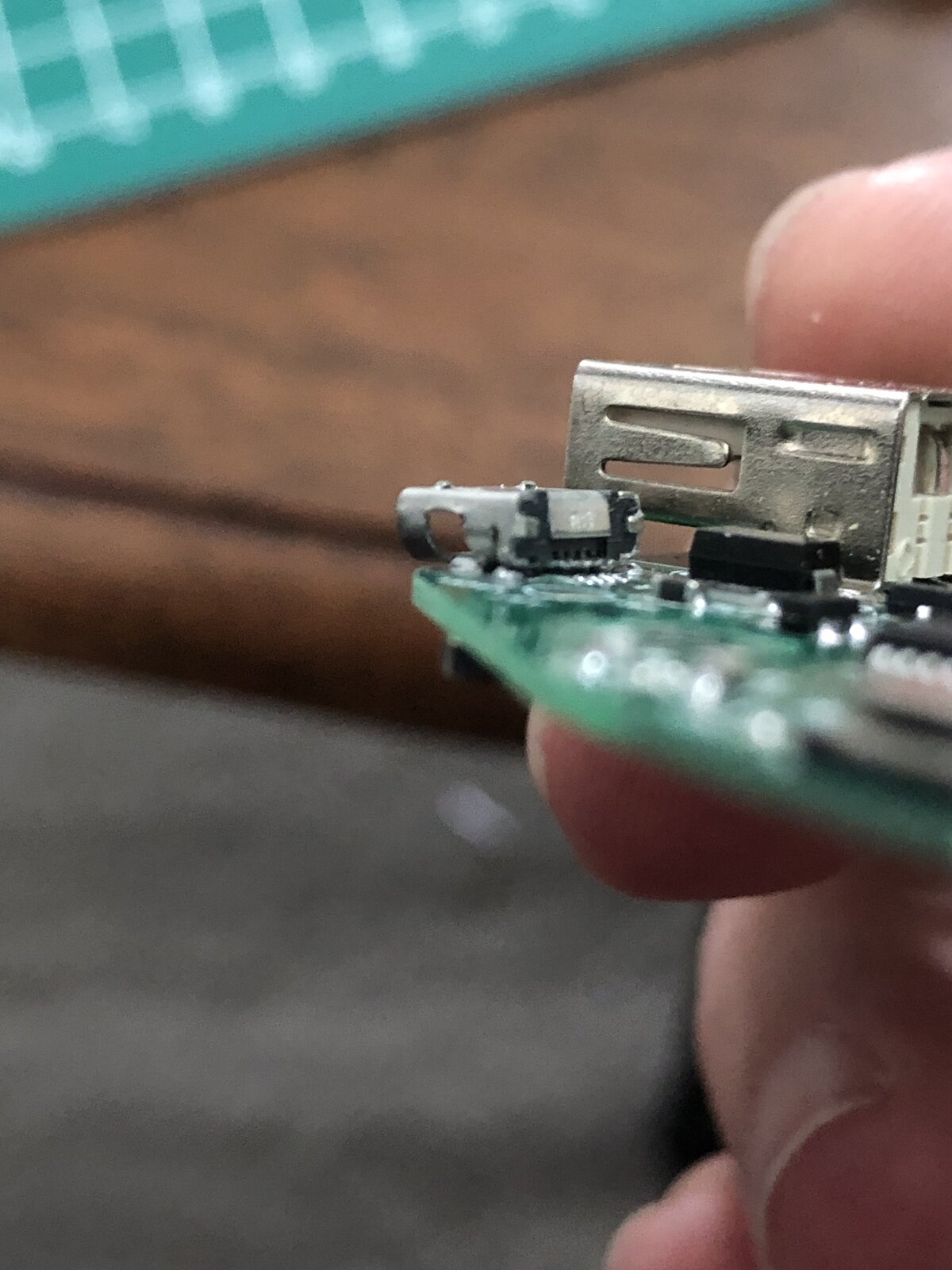

I have taken the speaker apart once more, and I can't access the battery as its somehow built into another section of the speaker that I can't open without fully breaking the speaker. I do however know that the battery is a 3.7v 1800mah with a JST Connector 2 pin.
So, its a very poor picture, I couldn't go upstairs yesterday, pain was bad and I passed out before I even opened this page to reply to you, otherwise I would of gotten a picture of my microscope that I use to check where there are breaks on my MacBook Pro (mid 2009) but not gotten far with that yet. Anyway, I took a picture from my phone, but it wouldn't focus on the connector.
Do you think that I can get away with repairing this or do I need to replace with a new one? Are the pins not the anker post, soldered on, or is it just the anker pins - that is if that is the anker pin, I am not sure, I have never removed or replaced any chip or connector before, So I am completely open to suggestions.
I also just want to say that when the connector is pushed back down the speaker does charge again. There is also space in the chip board controls for a new battery if needed. If I can get it to charge correctly, Then it should allow power charging and play right? I am unsure on this as I can't remember if that worked before, I want to say yes...
