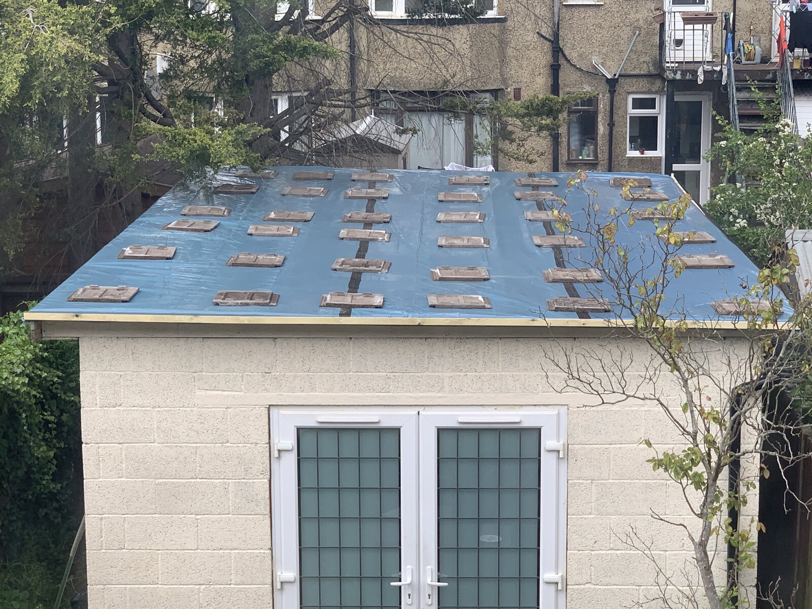

I'm deciding now whether to strip the felt, replace damaged OSB then put down EPDM... or just temp cover the whole roof with layers of DPM/TARP and batten down which two individuals say would last 2 years if done properly.
Thank you for the suggestion, so the roof is 7.5 by 4.5 metre.
How am I rolling out the 4 x 25 metre dpm? 4 metre DPM roll going down length way across the 7.5 metre stretch? And then overlap the lengths and leave overhang?

i got the temporary cover on today and battened down nice and tight.
should last a while for now, DPM was great suggestion 300mu is solid stuff.

so ill save upView attachment 234958
That's a nice neat job, well secured around the edges.
The angle of a flat roof is 1:40 for felt and slightly less for EPDM - providing the joists are strong enough and don't bow

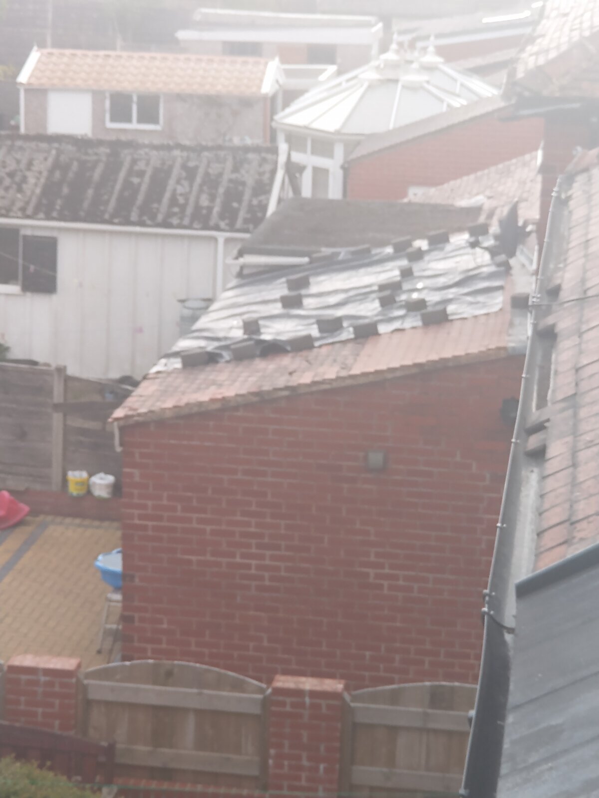

The Dpm will crack up in the UV.
I've some pictures some where of a flat roof covered Dpm after a lead theft . Less than 3 months it was falling apart
