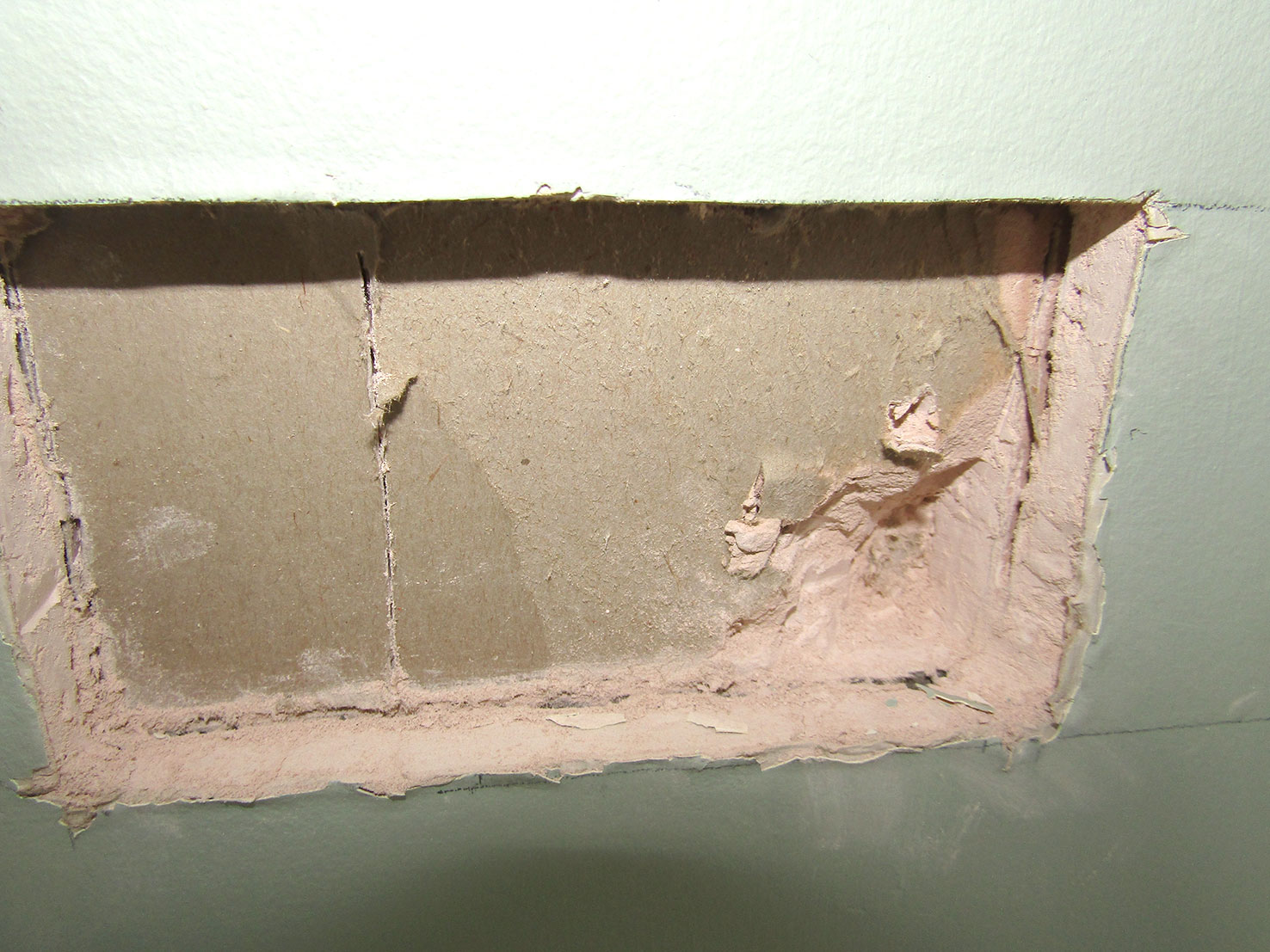

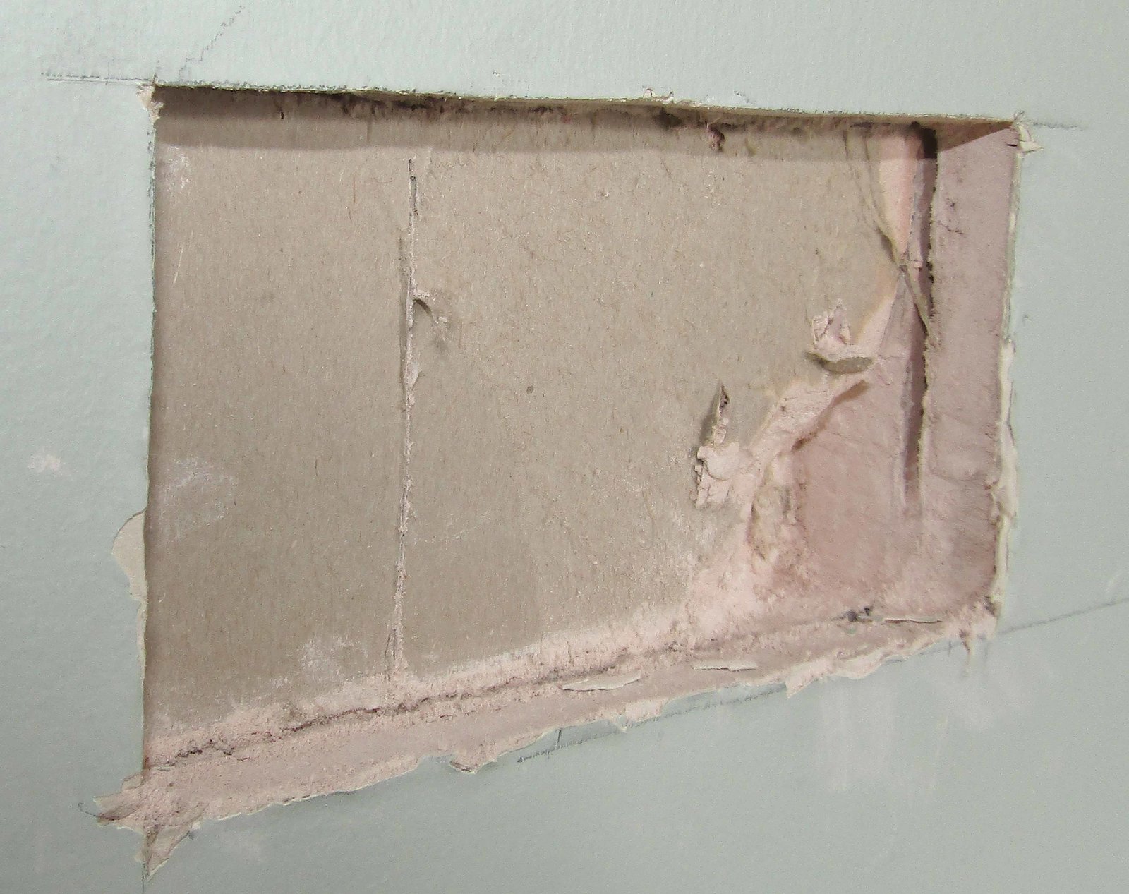

I have decided to install a double socket, so I have taken a couple of pictures to show how the wall is made up. Again, as far as I can see, it is made of of 3 sheets of plasterboard stuck together. The back box I will be using has an approx 35mm depth.

I have decided to install a double socket, so I have taken a couple of pictures to show how the wall is made up. Again, as far as I can see, it is made of of 3 sheets of plasterboard stuck together. The back box I will be using has an approx 35mm depth.View attachment 127965 View attachment 127966
These pics do not show how the wall is constructed. You still have not explained how you know the wall is only 2” thick?
when you drill for the fixing screws, show us the drill coming out the other side.
Those cabinet hanging rails are excellent because they spread the load and don't pull out. But I have only used them where you can catch the studs as well, or use a long screw to reach the brick or block behind. I don't believe any other method of fixing will be as good, except perhaps stitching a large piece of ply to the entire wall.
