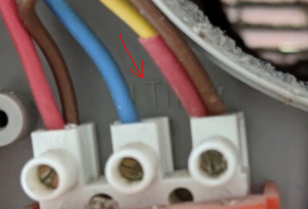

Fixing New Extractor Timer Fan But Only Have L/N Wiring
What does the label under the piece of black plastic say
and what are these markings?
  • Thanks
Reactions: PxC
Oh. You did leave the brown link in place ???
Err :rolleyes:
Now that I have the correct answer in front of me it makes perfect sense. All working as desired now!
Thanks very much for your help and patience!
