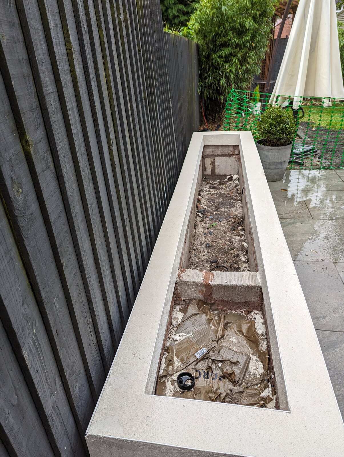

Fixing timber to the rear of a wall without rear access?

How long is the planter? If you use some steel box section for the rails you may be able to span the length.
I deffo would not be fixing a (moving) fence to the top courses of that blockwork. Never in a million
That's not what I'm intending to do. I'm dropping the post behind the wall, and then going to fix through the wall in several places. Will probably use some sort of strap on the inside as well the spread the load

The fence we were intending to build, is more screening to be honest. Hit and miss style. If we pulled out the fence, would need to double up materials to do the same their side and offset it so you can't see through, and I'm not paying for that
IF its just screening you want try using bamboo or reeds, far lighter.
