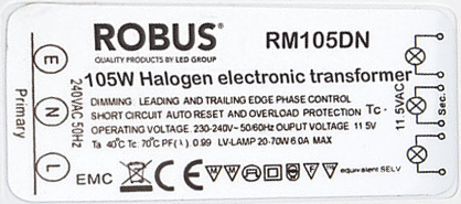

The transformers often have a minimum load. LED bulbs use much less energy than the originals. It may be that in your room of 13 bulbs they are set up as 4 transformers each with three bulbs and one transformer with the remaining bulb. Therefore only some of the transformers are below the minimum load which causes them to flash.

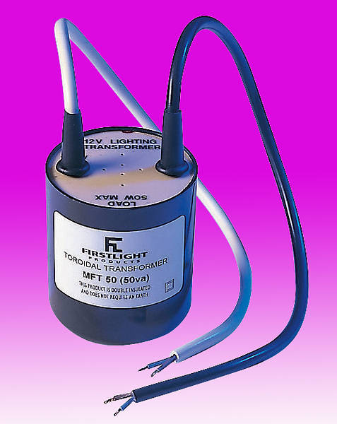

VA is near enough same as watts, so if the electronic transformer says 20 - 105 VA it means it needs a load of 20 to 105 watts, and these are real watts. I have see many LED's for sale which say
and I can see how anyone buying them thinks they are 60 watt, where really only 8.8 watt. This
is common for an electronic transformer it states 20-70 VA for each lamp, a toroidal lighting transformer like this one upload_2022-1-27_23-52-23.png will go to zero output, however they will not fit through the hole normally made for 12 volt lights, Dimensions: Height: 74mm. Diameter: 63mm. Also at £19 each not cheap, and looking at website where I got picture non left.

The simple answer to flashing, is to rewire every light to 240v to the lampholder and fit 240v LED's. Or to replace all of the 'transformers' with (depending on load) one proper electromagnetic transformer better matched to the actual load. E-transformers only works when they are reasonably well matched to the wattage load, otherwise the flash on and off.
