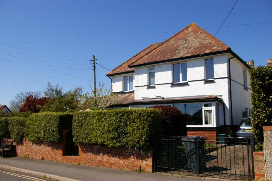

Can we see a picture ?
Originally I had my drawings done for the Juliette Balcony as I didn't want to wait around for planning permission - I just wanted to get the house ready. However, it turned out the bay windows hadn't been built properly - ie footings not deep enough and the brick work not tied to the original house. So, because I have delay things a bit in order to have the bays rebuilt, it makes sense to go the extra mile and see if I can have a proper balcony.
The architect is saying the bays haven't been built up to full ceiling height so I won't be able to use the top of the flat roof. He keeps on saying 'the cheapest way'. I'm not too worried about the costs - if my idea is possible, and as I am rebuilding the bays I want to have the balcony.
I'm travelling back down to the house later today - so when I get there, I will upload pictures.

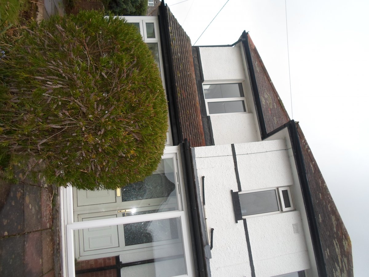

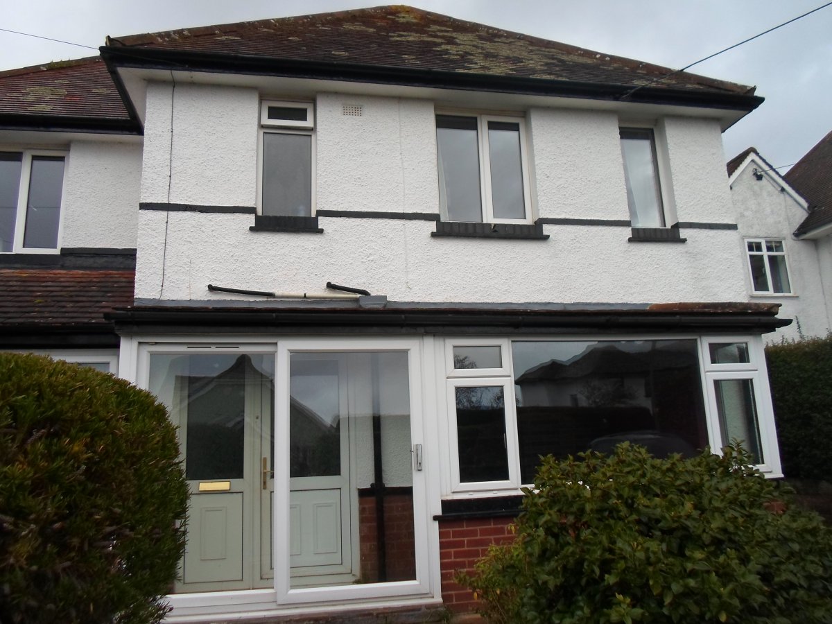

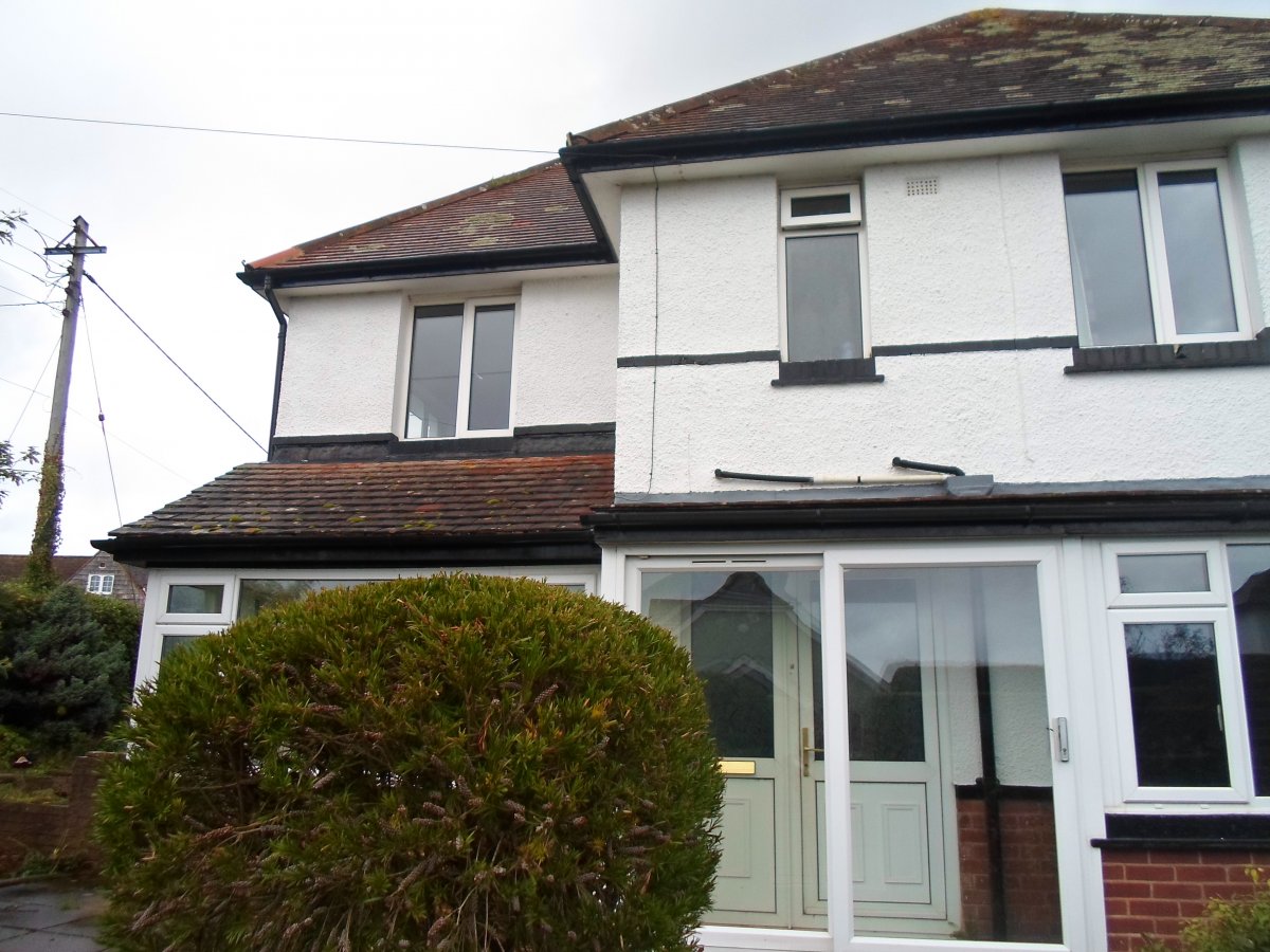

The architect says the bays haven't been built to ceiling height so I can't use a flat roof as the base. I'm having the bays rebuilt because they are sinking and the brickwork hasn't been tied to the original house. It appears the bays were built around 1980 without any planning/building regs.
I'm sure I can afford the works - I set myself a £35k budget for all my works and so far I'm only about 10K in - that covers central heating, full rewire, downstairs cloak room and my log burner. Rest of my budget is for new bathroom, kitchen, double glazing and bifold door off living room, plastering and rebuilding bays and doing the balcony. I've got a £5k contingency too.

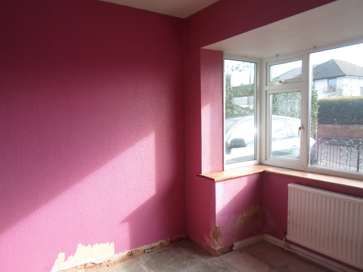

This is a picture taken from inside the dining room. This bay has to be rebuilt. I can see what the architect is saying about the bay not being high enough but the bays can be rebuilt to the maximum height.
The architect is talking about having a flat roof at the existing height - then having a metal bolt on balcony with a gap of some 20 or 30 cms between flat roof of the bay and the balcony. This sounds and I should imagine, would look hideous.
I don't think a little step down onto the balcony would be that bad and you could hide it with the railings configuration.

There is a sea view from the front of the house.
Suppose there's more chance of objections at the front .... Informal chat with the planning officer might be the best solution to start.
