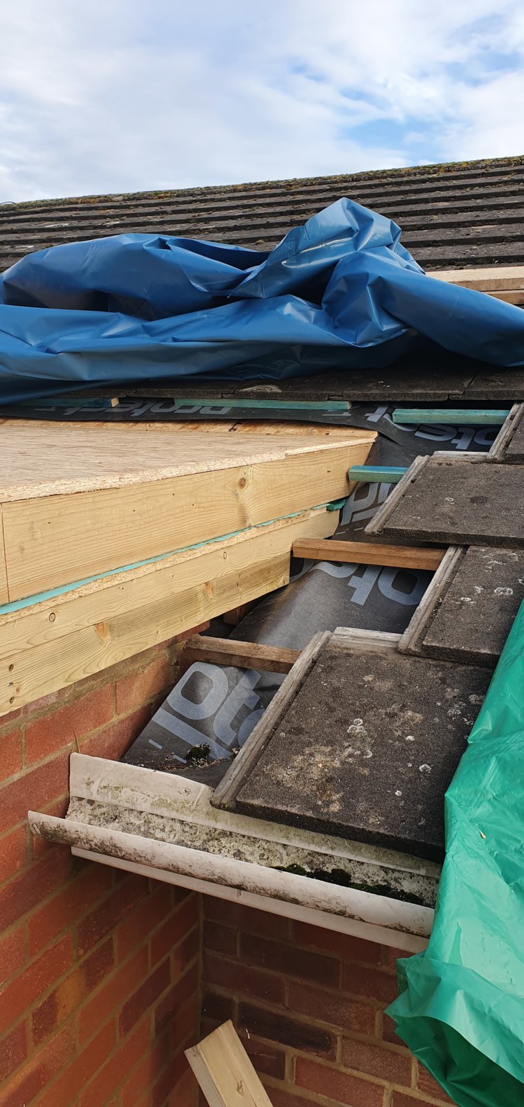

Hi, can someone offer any advice on how to weather in where my new extension joins my existing pitched roof? I will obviously cut tiles to fit up against fascia and under soffit. Does the fascia go into the roof or up to tiles? I assume some sort of leadwork to cover it all but not sure how to go about it.

i cant work out how you've framed the flat roof or whats happening on the RH fascia side?
is there a lintel below the rafters where they enter the pitched roof?
if you remove any obscuring plastic and stand well back and do a few pics showing where the flat roof hits the main roof, and the RH side, it would help?

There is a steel beam that has joist hangers on it holding the new and existing joists.

One would carcass the flattie facia detail, then repair the pitched roof up to the carcassing - i.e. cut roofing battens back, lay felt lapping up the timber, fix battens, and fix tiles (with soakers if necessary) and an abutment flashing, then cover with décor fascia. If the existing pitched roof overhang is such that it abuts below the fascia line then you would need to chase your abutment flashing into the masonry. Can get a bit fiddly as you get closer to the soffit of the flattie - but doable.
It's sometimes easier/better to cut the carcassing back and at the same pitch of the roof and a few cm shy, then tile as high up the roof as you can beneath the carcassing, depending on how yours works.
We recently did one on this fella where the flattie hits the pitched....

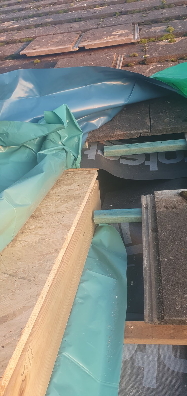

I was referring to the pitched roof abutment where the pitched hits the flattie. You need to get this right and get it done (up to the pint where the flat roof lead soaker is dressed onto the tiles) before you do the flat roof covering.
Always start at the lowest point. You will need to remove battens and repair felt complete with upturn, soaker, tile, abutment flash right up to where you will be level with the flattie. You will then complete the flat roof (with soaker onto the tiles) along with an upturn tray and cocking fillet going up the roof, then complete the tiling.
Your fascia can be fitted last over the pitched roof soakers. We fix a 15mm strip of OSB around the flattie, so that the roofer can tack his flat roof flashing strips to the OSB, allowing us to slot the facia up beneath his flashing....
However, you can fix the fascia prior to the flat roof being covered but after all the pitched roof stuff has been done up to level with the flattie.

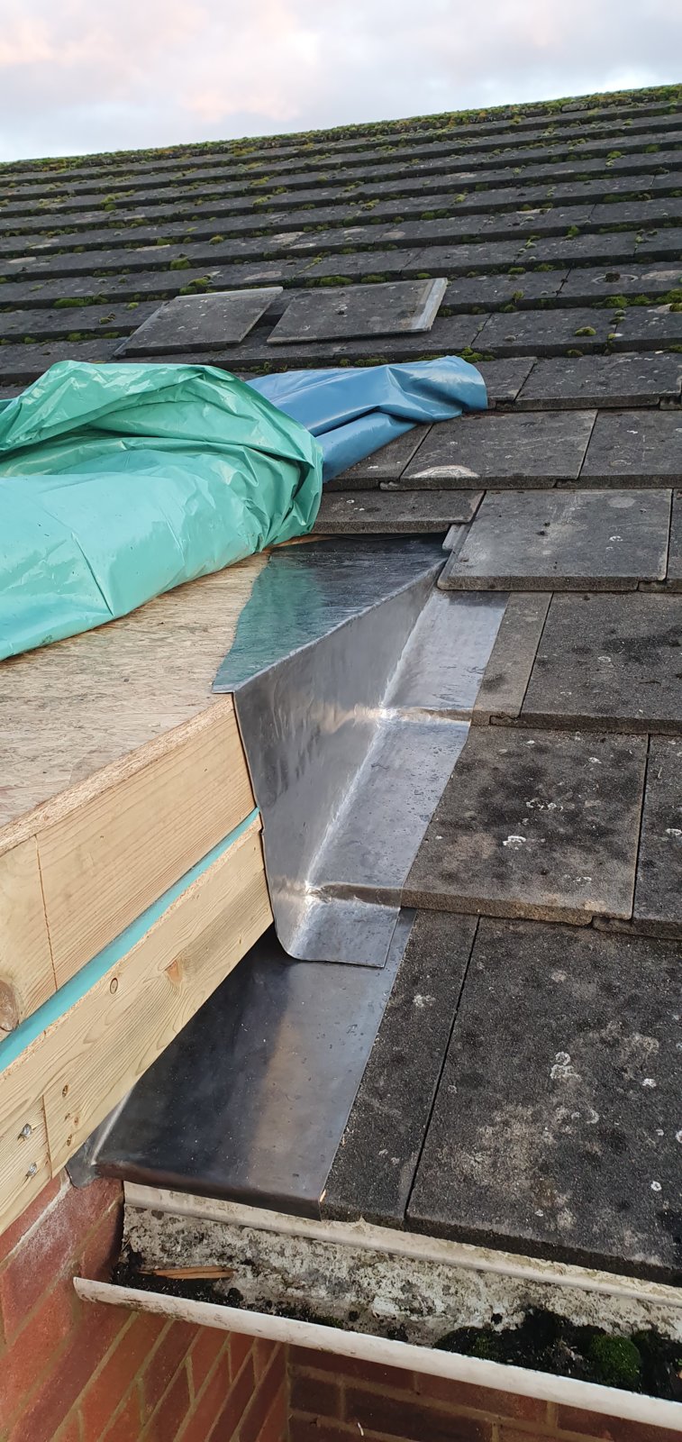

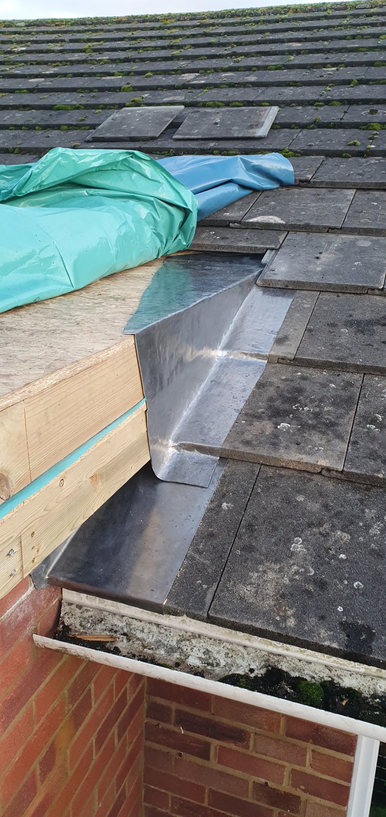

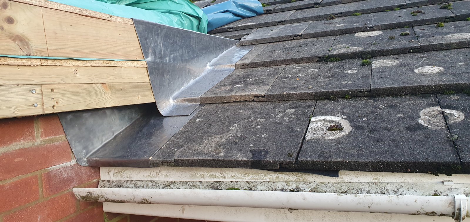

Thanks for taking the time to go into so much detail. Things have progressed a little bit and I think this is slightly different to how you described, I have a slight concern in whether the epdm will stick to lead?

Lost count how many videos ive seen on flat roofs and epdm, think im quite happy about how its going to be fitted its just that corner where it meets the pitched part seems a tricky detail. I'm thinking the lead needs to be cut flush with the top of the flat roof deck then epdm folds over it? But then does it need a bit of lead over the top of that?
Roof has a good fall, its 150mm joists/3" firings/18mm osb/VCL/120mm insulation/18mmOSB. Didn't actually think it was that deep! I actually left the exterior brick course higher with smaller noggins around the edge so I could have a smaller fascia.

noseall, that works but there's only a short run of lead, & the lead would have to be nailed to the kerb.
i'd suggest flapping the EPDM over the kerb and fixing more or less as you've shown in your sketch.

"dont seem to have anything" - yes, the EPDM roof does, it has custom edging pieces (or kerbs as noseall says) with the EPDM nailed to the edgings.
neither of the roofs appear to have angled tilt fillets to flow the material up the kerb upstands?
tilt fillets eliminate the 90 degree weak point.
