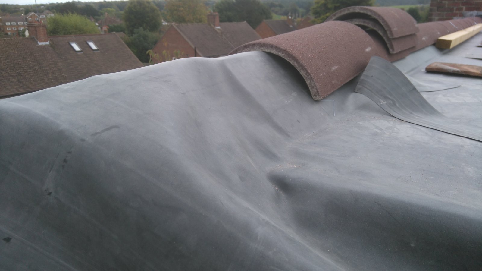

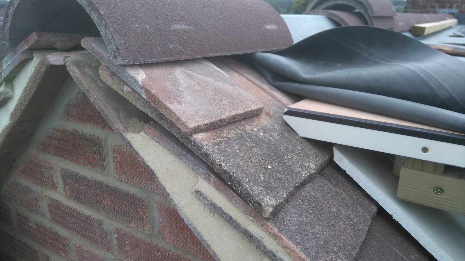

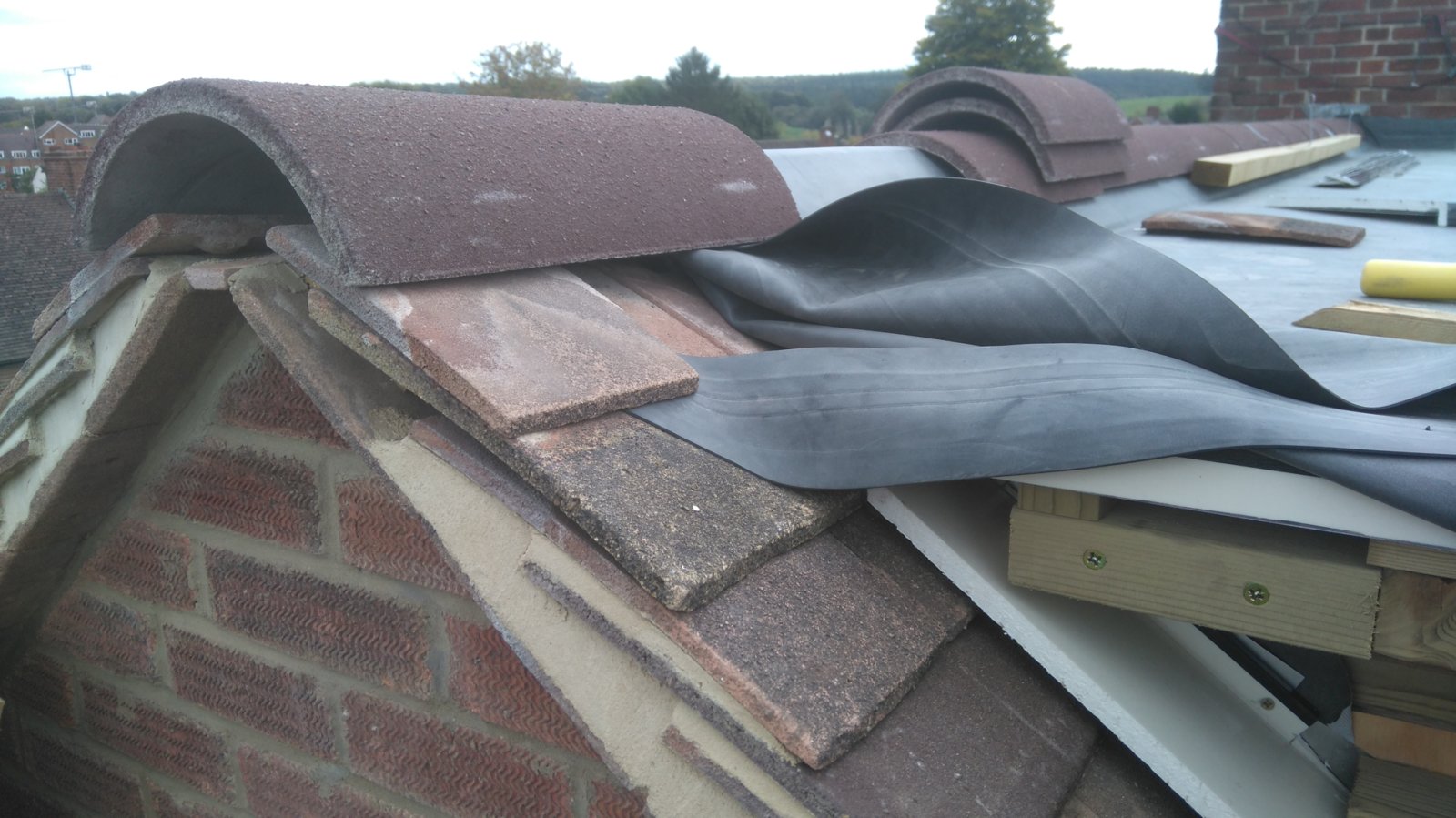

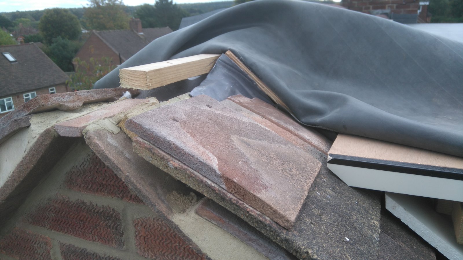

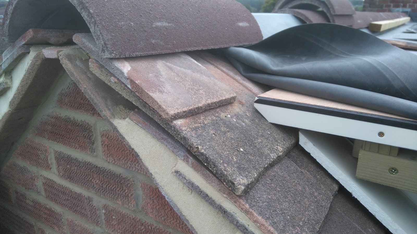

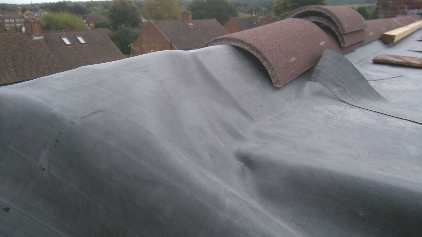

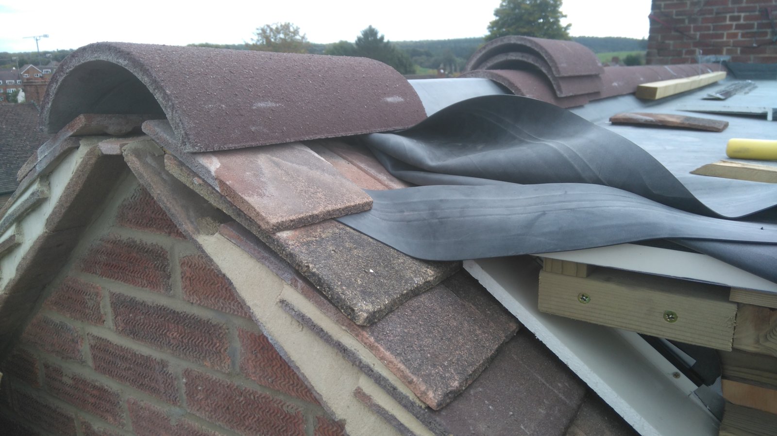

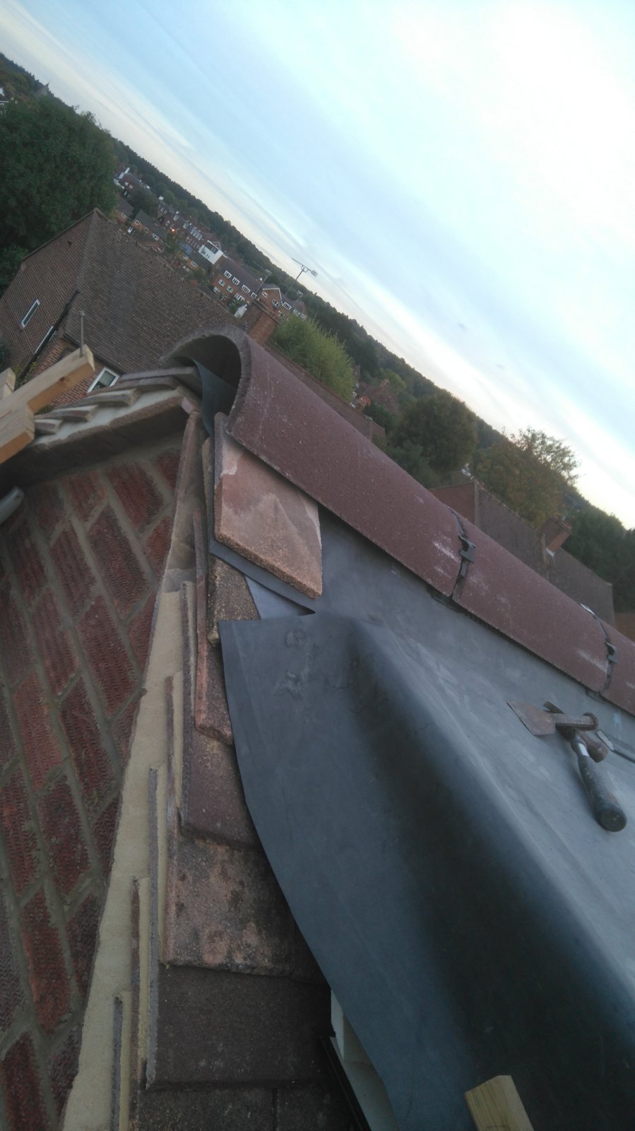

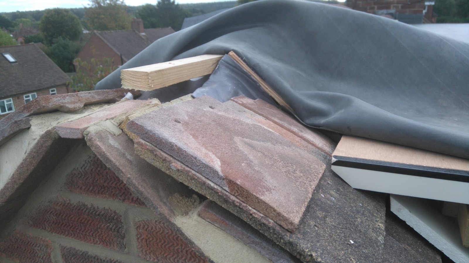

Knowing where the soffit stops and epdm
A little further now and at the point where it all meets.
I'm concerned about water getting umder epdm at this point as i only habe one Eaves tile to cover this bit.
Does it all look like its going in the right direction?
I know ive ashed before but should i put any lead here or is it not needed?
Images are of where the layboard is a bit high and roof with cheek fascia meet. Bird nest protection in too. (thanks). Other image is of where i think the rubber should go ( shown by a small off cut) was told i shouldn't glue epdm to tiles though. So what should it be fixed to?

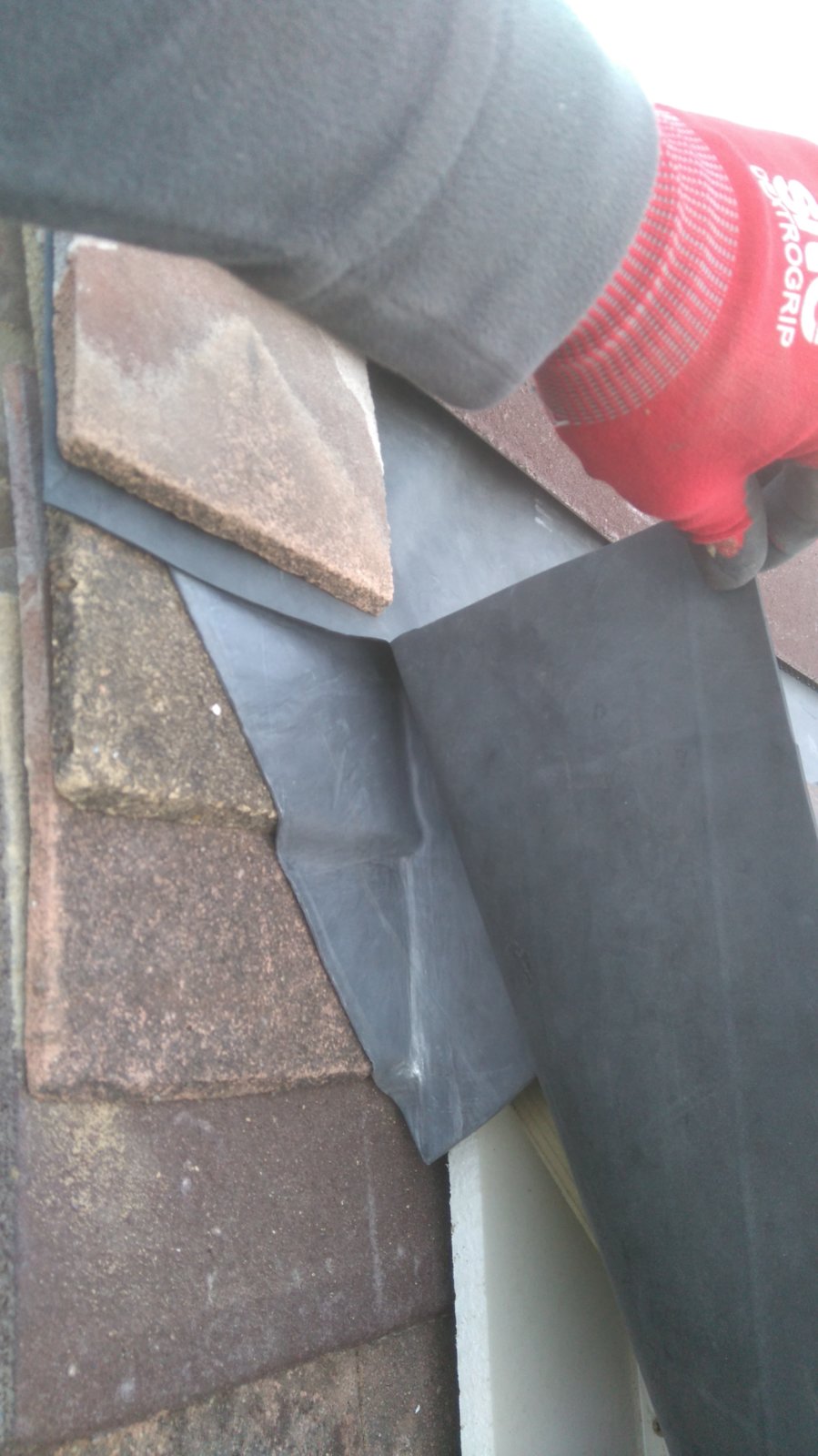

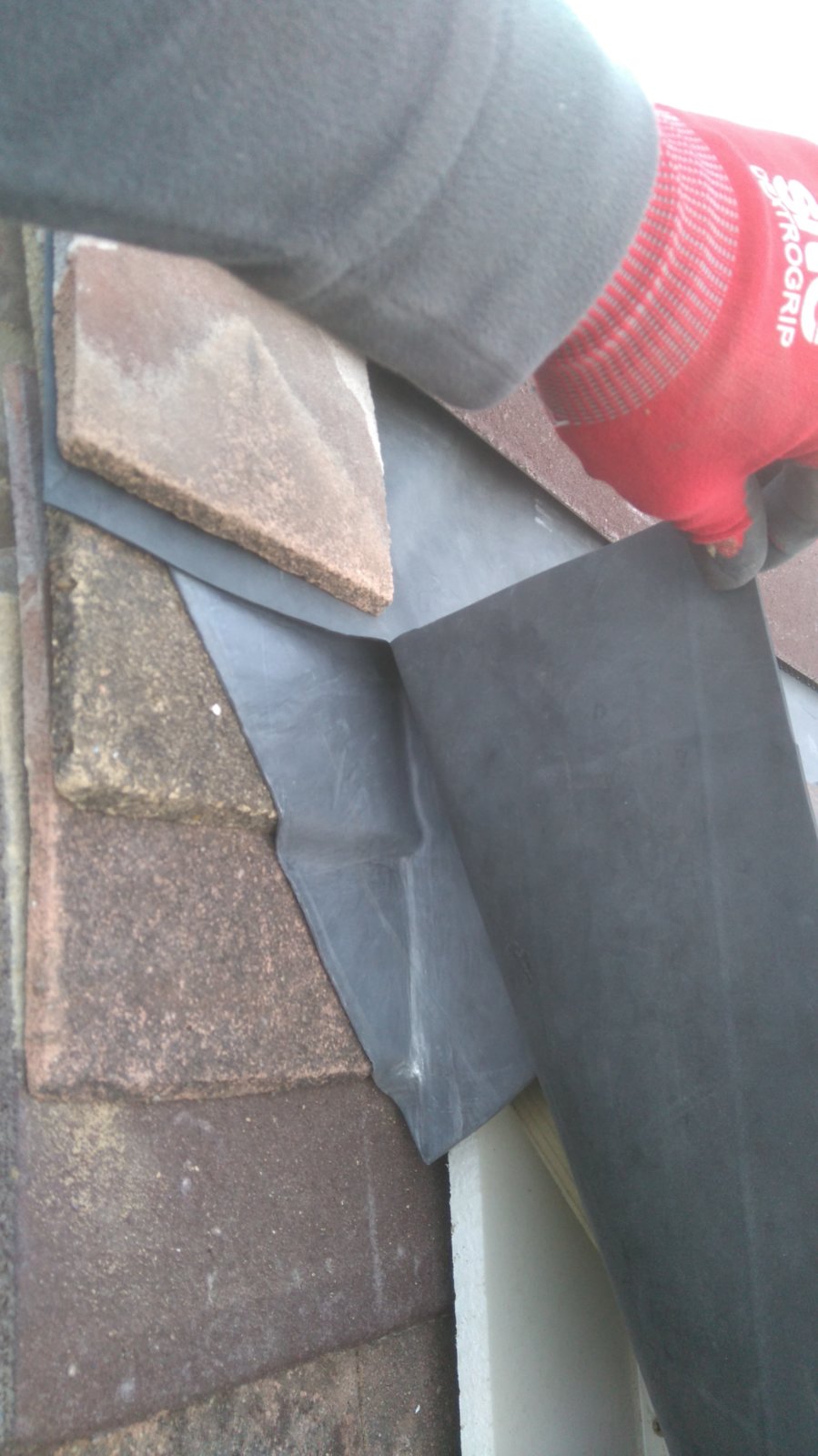

@chappers. Is this looking like you explained. Put a lead apron in and will cut rubber to dress over. Will put un-cured rubber at cut overhang. thanks
