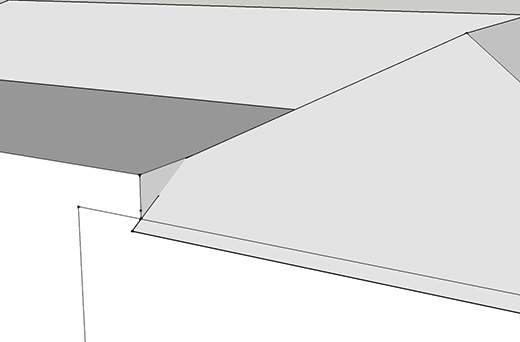

Has any one got any pictures/drawings/insite into how to attach a flat roof to a doubled hipped roof when the flat roof is taller than hipped sofits? I can't picture what happens at the corners as the new roof would be higher than the roof line on both faces.
Bit like below but flat roof is about 700mm higher
You bring the flat roof across in line where it meets the pitched roof rafters and then form a small vertical wall - timber clad normally, on the other side of the hip
Just to clarify:

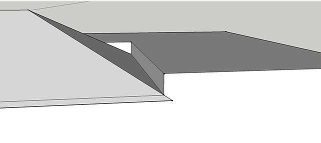

So like this below?
Anyone got any real life pictures?
