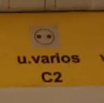

Out of interest, what does the 'U' stand for?
Can't find anything on-line.
The "picture" illustrates that which appears to be a "Type C" socket outlet.
(Google Translate tells me that "varios" = "several" - with "varios" being "masculine" and "varias" being "feminine".)
Hence it probably means "various socket-outlets" - although Google Translate tells me that that is "varias tomas de corriente"
Translating that back to English comes up with "multiple power outlets"
We need a Spanish Electrician to tell us !
As suggested by DetlefSchmitz,
"ubicaciones" = "locations".
So "various locations" is quite likely.

USOS Varios. Various uses - normally your sockets. Alumbrado is lighting (may be a 10A circuit breaker AND some of the sockets may be on this lighting circuit! Vitro-Horno is Oven and Hob, but note that is only a 16A breaker! Often the water heater and washing machine circuits share a circuit breaker, which is often marked Lavadoro y Thermo. All circuits are protected by a "Differencial" or RCD and the incoming supply is limited by a C-curve single MCB which varies from 16A (3.5KW) to 60A (13.5KW) for which the Standing Charge made by the electricity supplier increases with demand. Hope this helps!
