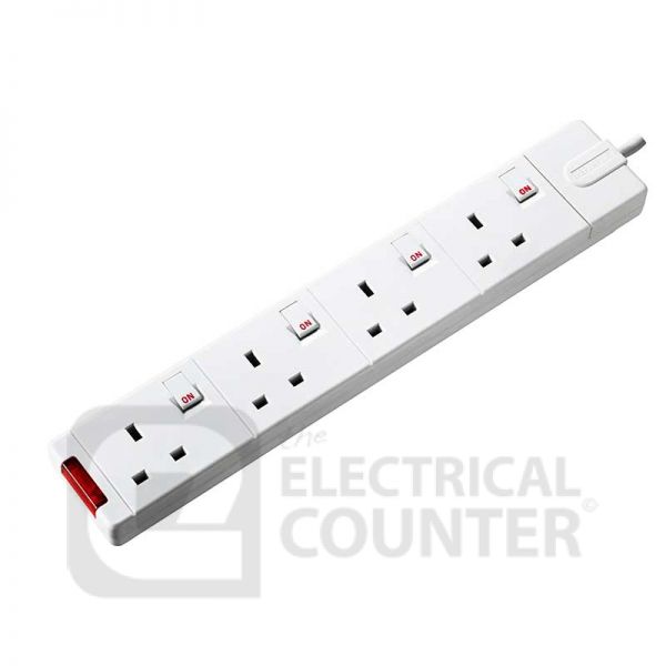

If you mean one of these
The product is protected by the 13 amp fuse at the wall. If you plugged in a washing machine, vacuum cleaner and microwave, and tried using them all at the same time, all that would happen is that the fuse would blow. Hence 1.5mm is Ok
What is this multi-way socket?
It’s one of these:
Masterplug ELS134B-01 Permaplug Four Socket Trailing Socket with Power Indicator, without Plug and Cable, 13 Amp, Black https://amzn.eu/d/99oaYcV
I suppose you could call it a trailing socket, I’ve always called it a multi way socket as I’ve no idea what they should be called!
