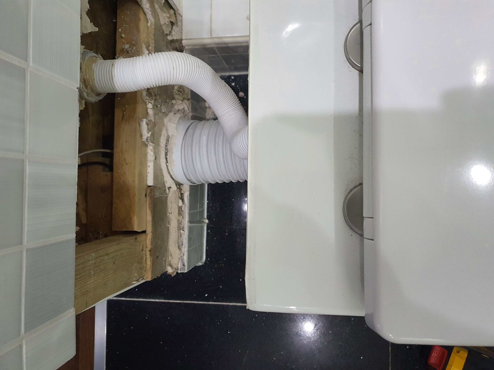

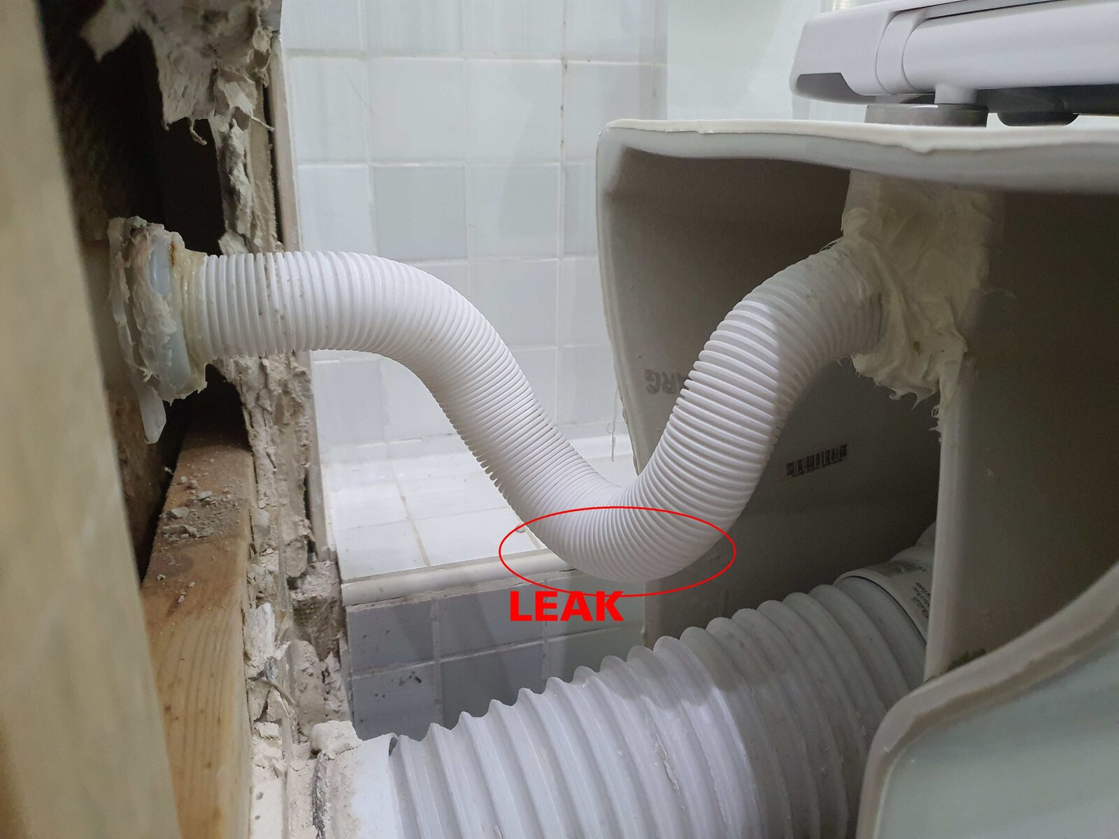

Hi,
There's a flexi pipe fitted to the flush of my toilet and after about 5-6 years it's sprung a leak half way. It's NOT at the joints as you can see it clearly spurting out a jet when the loo is flushed. Pipe hasn't been disturbed and there appears to be no damage so I wondered if it's usual for these kind of pipes to leak or fail??
The pipe being bent downward forms an unintentional trap which always contains water and I wondered if the acidity or something like that with water being permanently in the pipe helped cause the problem? Maybe also with the loo being pushed back to the wall it's making an overtight bend too?
Reason for the flexi pipe is the cistern is not central vertically due to limited space to box it in. Ideally I'd like to fit solid pipe but am not sure how I can get enough room to swing around a couple of 90deg bends or what kind of pipe (solvent/compression) would reliably fit to the Geberit outlet pipe as I thought they used weird sizes? The rubber bung to the back of the loo is also missing (although despite the great wadge of silicone it does not leak from that point).
Cheers,
Dave

It seems to be too tight a bend and has possibly failed due to that fact. Would be better in rigid, but seems out of level with the flush outlet and pan inlet?
That's going to be a treat to sort out. Best way might be to acquire rubber bung for the back of the loo (so the flush becomes pushfit rather than wodged in with silicon) and then have a play with a length of 38mm plastic, fill it with sand, put fittings on each end (so the ends stay as a circle) then warm it up a bit (hairdryer warm not paint stripper gun hot) and try and form the offsets.
Oh dear, there's bodges and then there's bodges and that's a beauty!!
I guess it was done to deal with the offset between the pan and cistern but that was always going to fail. When that pan's pushed back that flexi's under a fair amount of pressure, over time the plastic gets harder, and it's then more liable to crack. Surprised the silicone/adhesive/wetgrab/nomorenails/mait/toiletroll/UHU/gaffa/etc held for so long
That really needs done properly though.
