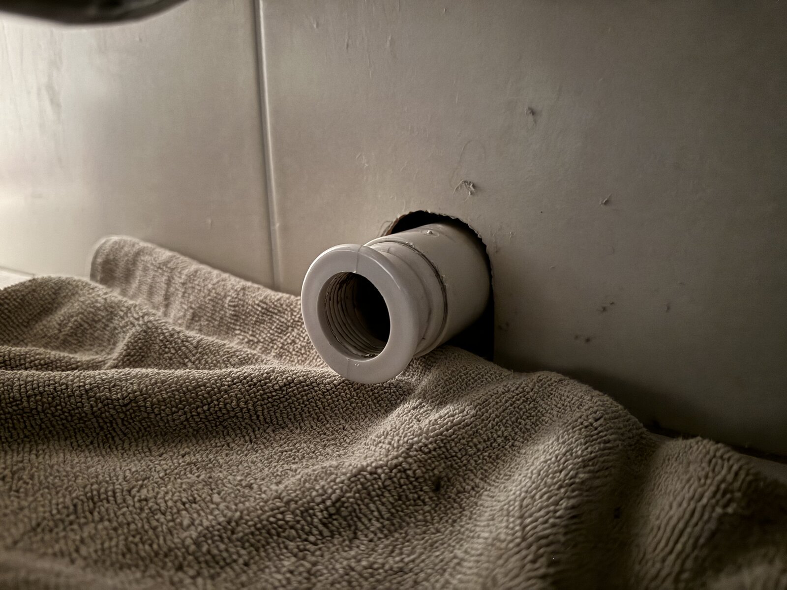

Flexi waste pipe under suspended bathtub
I can't make out what the flexible " trap" connects into ,probably a solvent weld fitting.
You will need to cut the Flexi ,close to where it meets the fitting, and then very carefully remove the part that's left inside the fitting, which is very likely solvent welded.

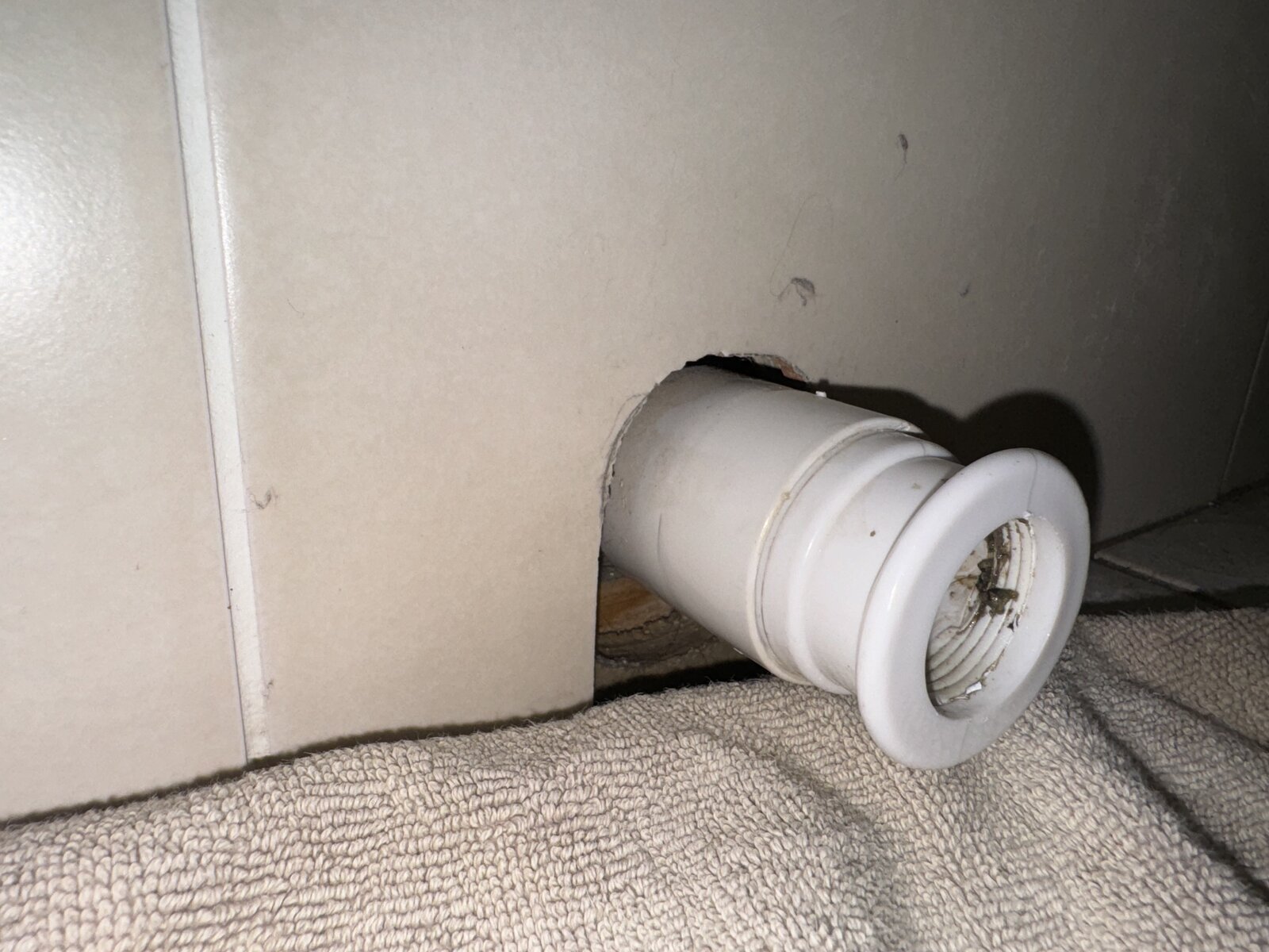

Managed to get down to this, but I imagine you're going to say that's not enough. I tried getting to the pipe going in to the wall, but it's welded together far too well.
Any connections I can make to fit this? Any other options I have?
The replacement 32mm flexi pipe end is a couple of mm too big to fit in to this hole.
Why don't you just hacksaw it off and use a solvent weld straight coupling on the accessible part of what I assume is 40mm rigid waste pipe coming through the wall?
Solvent welding is definitely within the realms of DIY.
It's a coupling that's sticking out the wall, not a pipe. The pipe ,or what's left of it,needs to be removed from the coupling.
Of course…missed that.

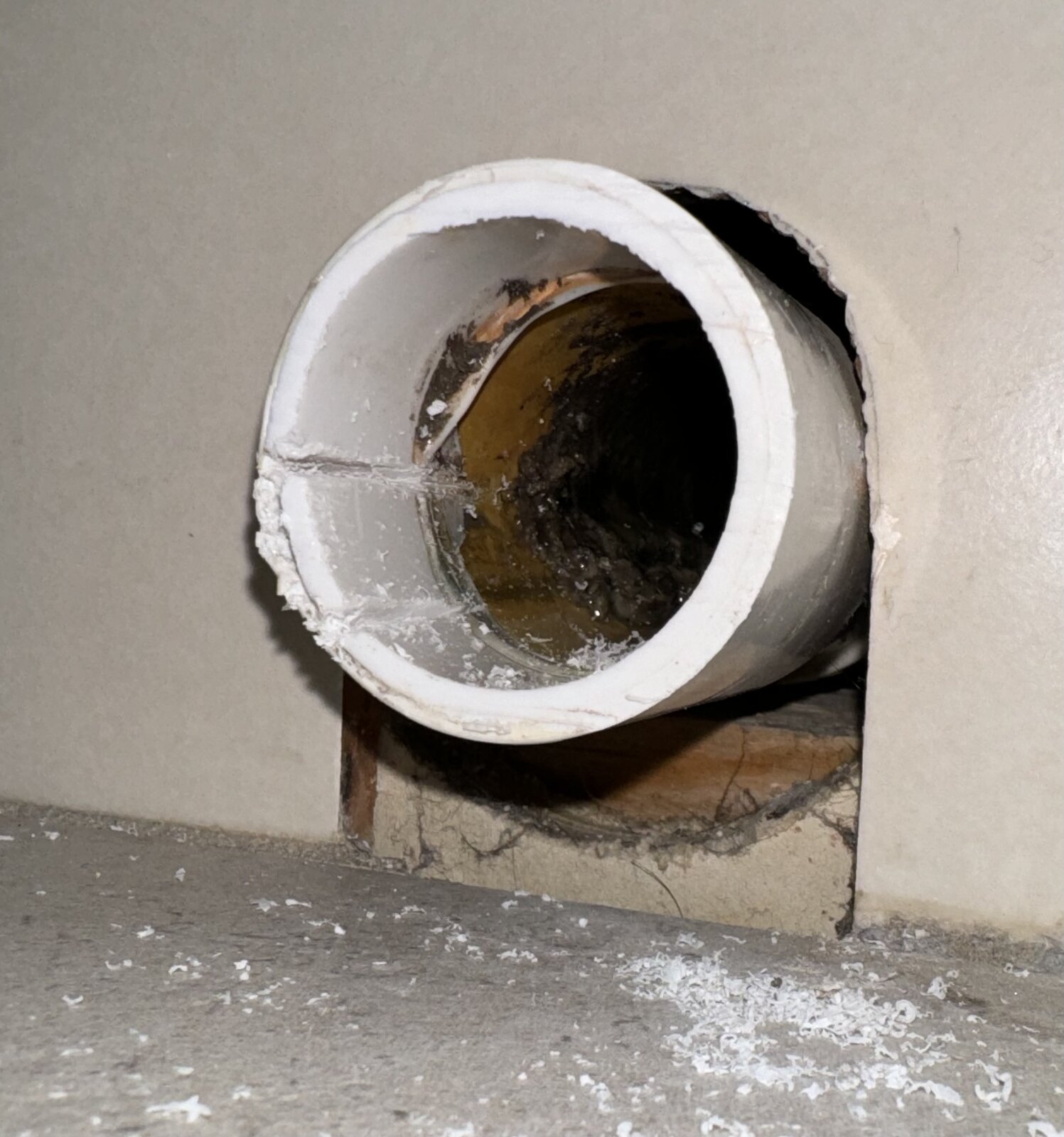

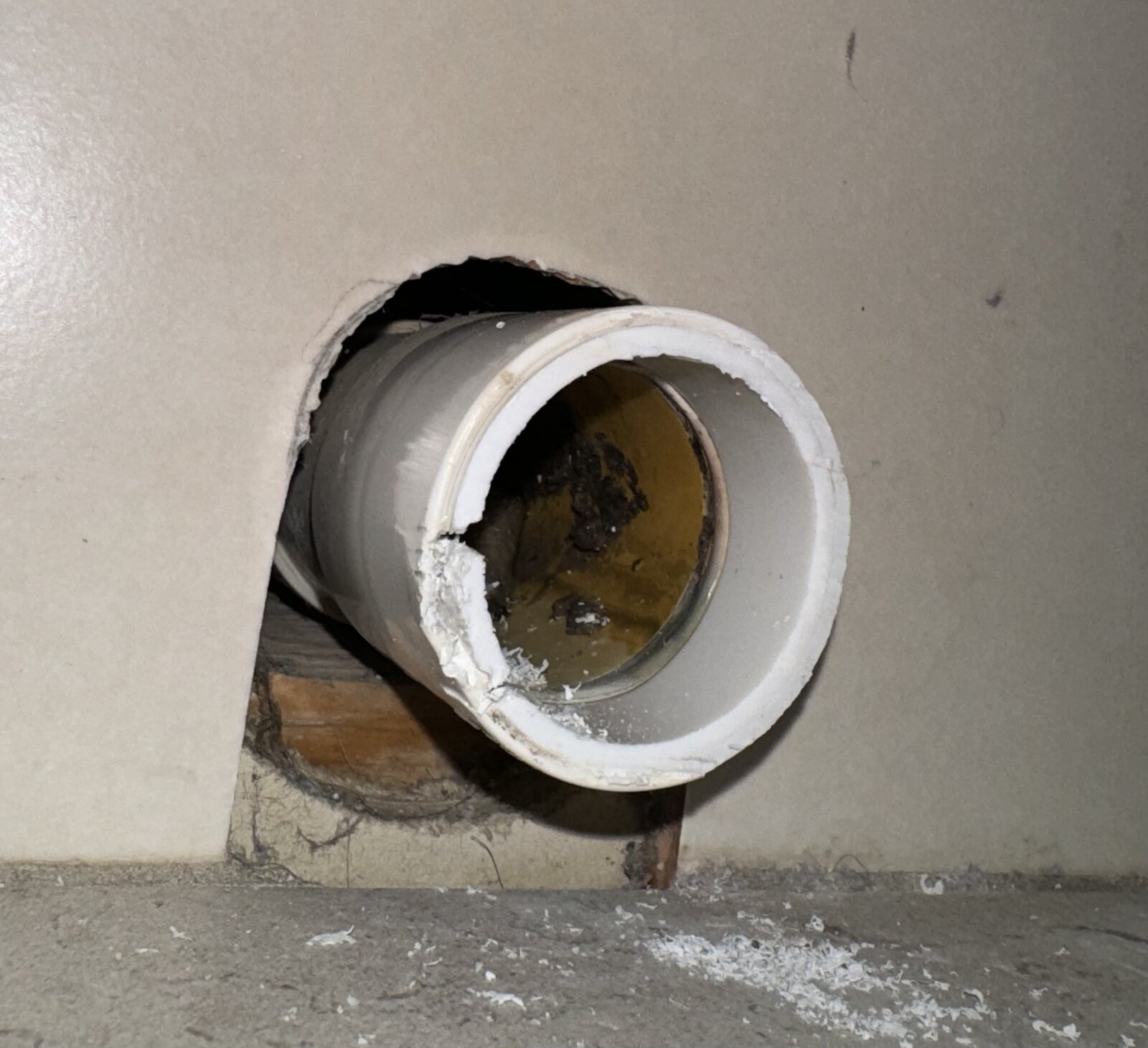

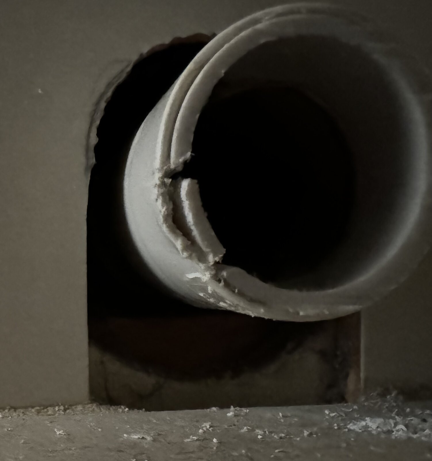

The fitting coming out of the wall feels/looks like a coupler.
I've made a channel on the male pipe, but when I'm trying to remove this small section of pipe inside, it looks like it's pulling at the outside fitting and I can't get any purchase between them. I don't want to damage the coupler fitting, so I'm leaving it here.
Thanks for your help everyone. Really appreciate it.
It's clear from the last pics that thickness of the coupling is much thinner than the thickness of the remains of the old flexi pipe. Something as wide as the piece in-between your cuts ( like an old ,blunt chisel) tapped in between it and the fitting may break the bond. Tapping inward,away from the fitting.

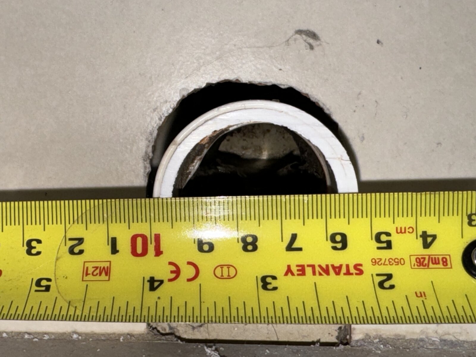

Now that you can take an accurate measurement of the outside diameter of the fitting ,what is it ? Is it around 45millimeters ?
I tried tapping inward but it was still not breaking the bond. And the angle under the bath was too awkward to get any force behind a flathead screwdriver tapping inward.
Here's a picture I took with measurements...
