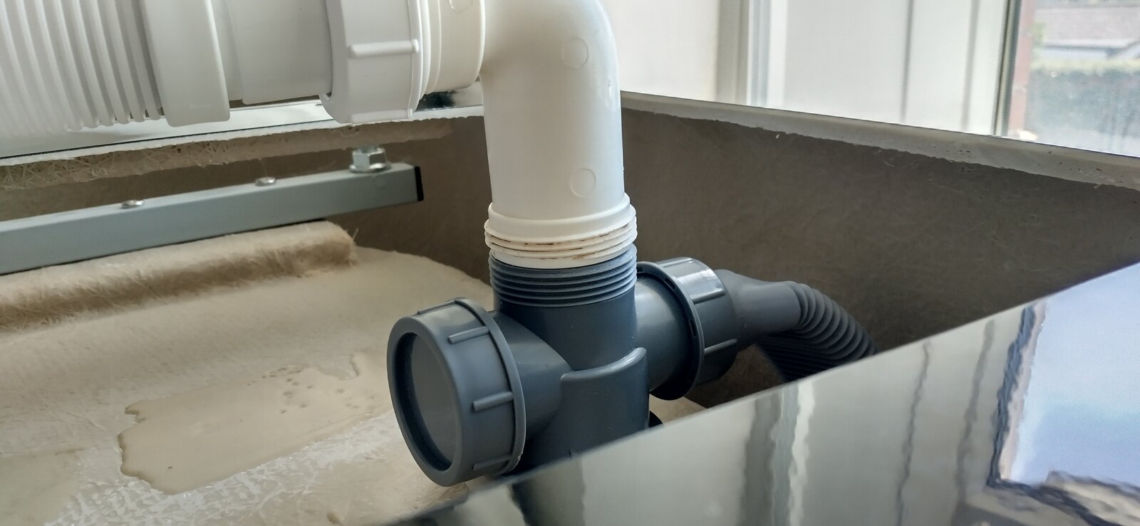

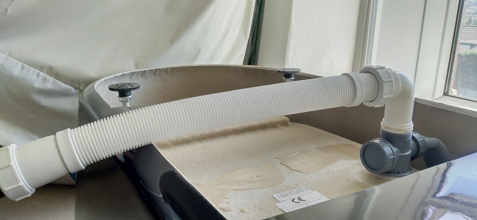

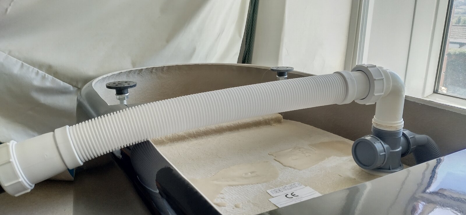

So here's plan A:

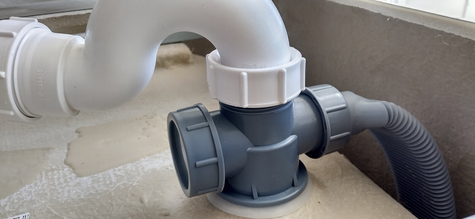

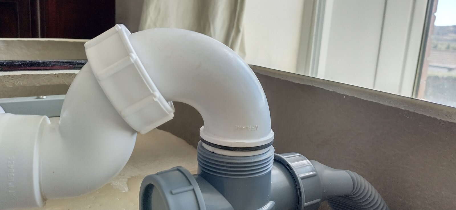

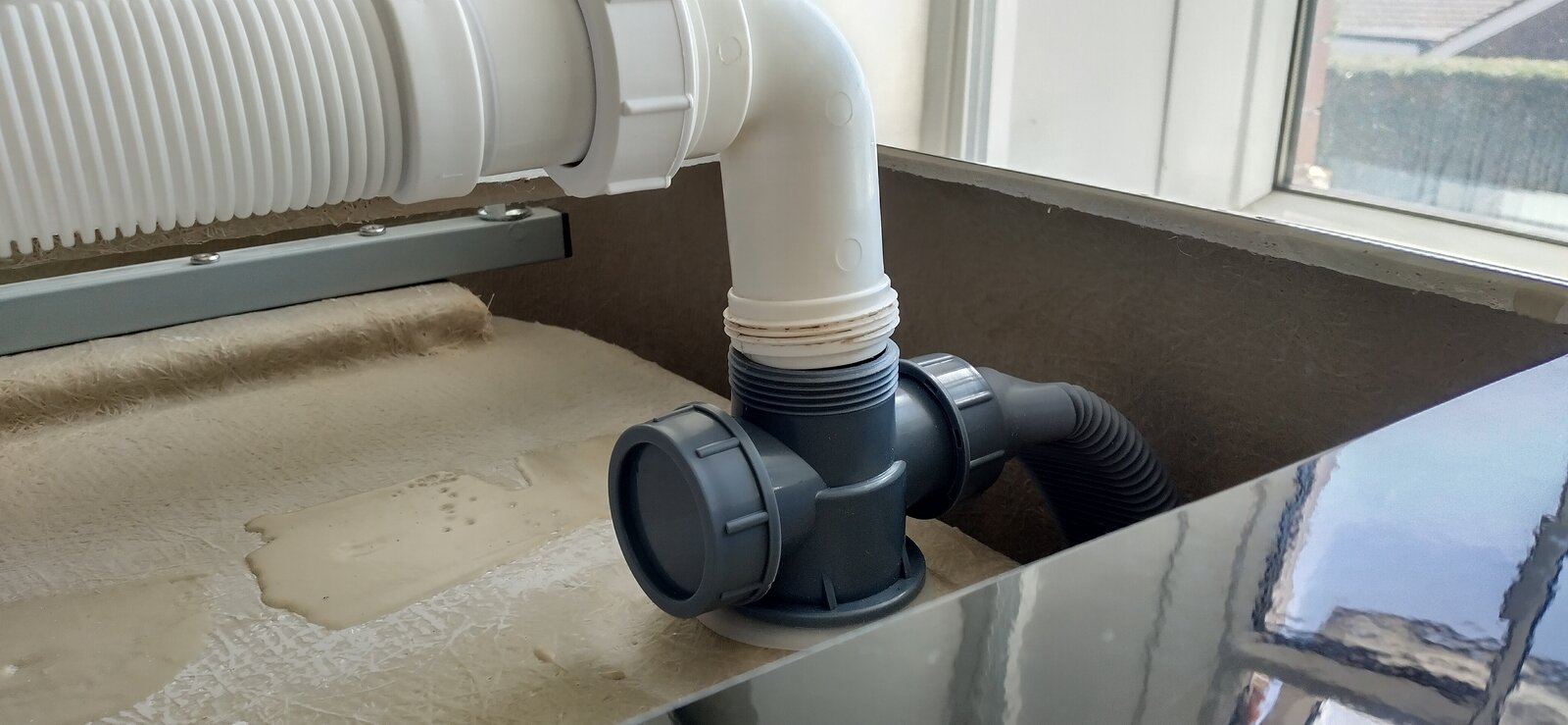

A problem with plan A is that the McAlpine trap doesn't quite sit in the joint:

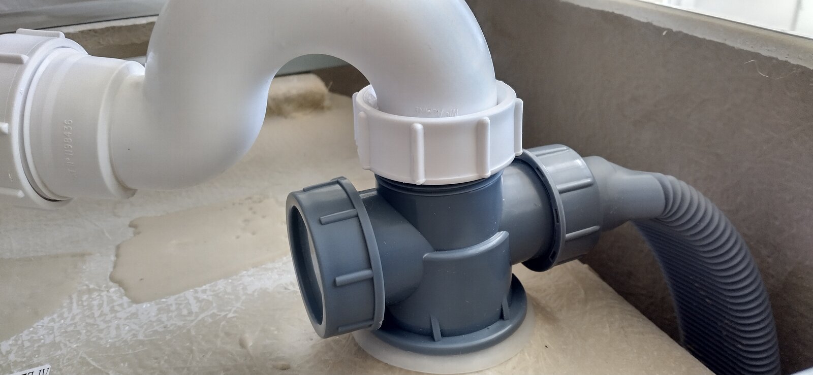

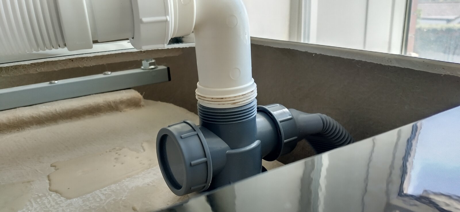

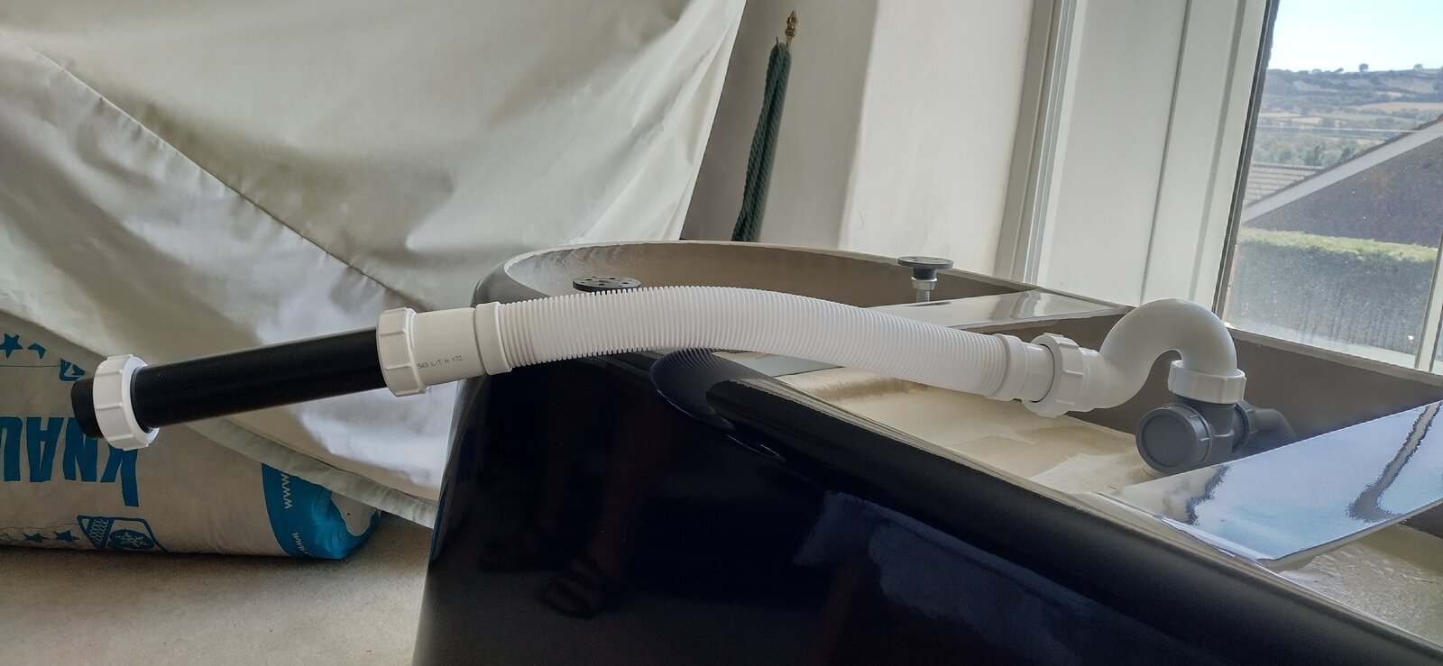

Plan B has a joint that does sit well in the outlet coupling joint, but is not a trap, and I have no way to connect them...
-I'm thinking that plan A is the least problematic, but I need to find a trap that is a mm or two smaller than the McAlpine to fit into the waste outlet coupling - any ideas?
-The other option would be to use the flexi pipe as the trap, where it dips under the bath side - fewer joints so less to go wrong?
-The black waste pipe is lower than the bath waste, so the bath will drain, but will having a longer trap create a flow problem?
-Forgive my ignorance - what's the advantage of a waterless trap?
The inside of the waste coupler had a bit of a lip on the inside of it - I've sanded that off and got the McAlpine trap and flexi pipe attached - phew! So it looks like plan A is the way forward. It will effectively have a double trap (the shallow trap, then the dip under the bath side), so likely a gurgly waste!

OK, that's a flat no then I'm, afraid, it would be advised to drop the waste under the floor and then back up to meet the tee.
I understand your thinking - if the tee's at the level of the bottom of the bath then surely the pipework under the floor just acts as a large trap (u bend) and you'd be right and draining won't really be an issue until the bath is almost empty when the weight of the water just won't be enough to continue the free draining down and back up again and it will slow significanlty. Also you really don't want all that waste soapy water left sitting in the large section of waste pipe under the floor, you will be plagued with problems with blockages over time, I can just about guaratee it.

If you want to use the shallow trap then either file down/stanley trim the flange on the trap itself, you will get it to fit in eventually, or file out the waste hole a little, the former would be better.
Still doesn't get away with the fact that I really wouldn't advise going under the floor then back up to the tee. I've seen it done with showers and baths before and believe you me after a while they turn into a right mare.
Thanks - looks like I'll need to think again...
