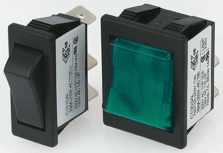

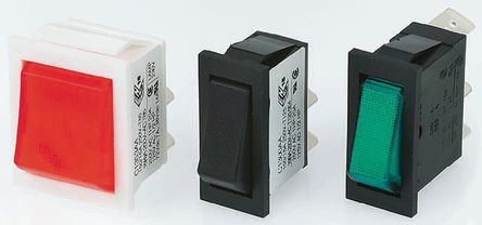

Trouble is ban, I need a two way switch like that and noone seems to make one. Are you saying I could use what's in your picture to trigger the relay?
Don' worry about going a bit off-topic. All ideas sane and zany worth considering, even the plateswitch/stick idea, but I think my missus will eventually tire of that one.....!
Don't think you can get 2-way ones.

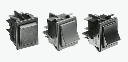

You could make one by using a 2-way architrave switch, or any 230V rated SPDT or DPDT rocker switch that takes your fancy
and a small ABS box. It would appear to help if black took your fancy....
But neither of these is really suited to or designed for fitting on the end of a length of flex.

those switches in a small abs box with a compression gland should be fine....
