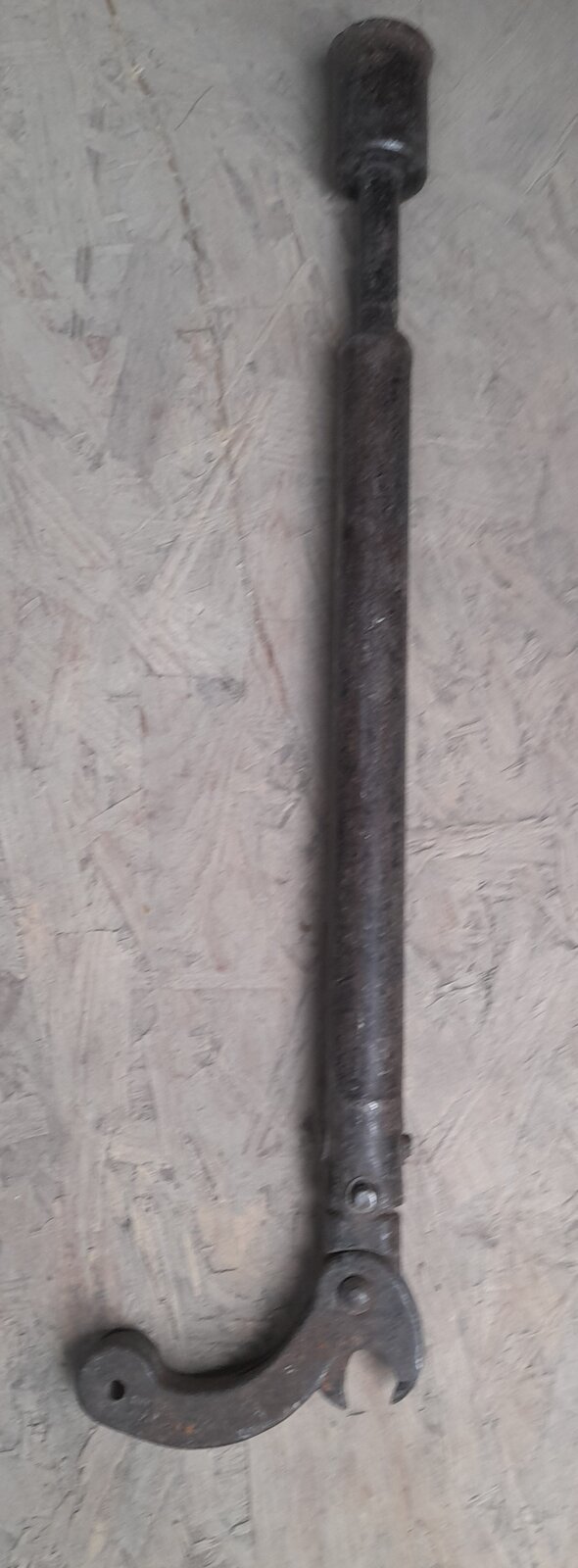

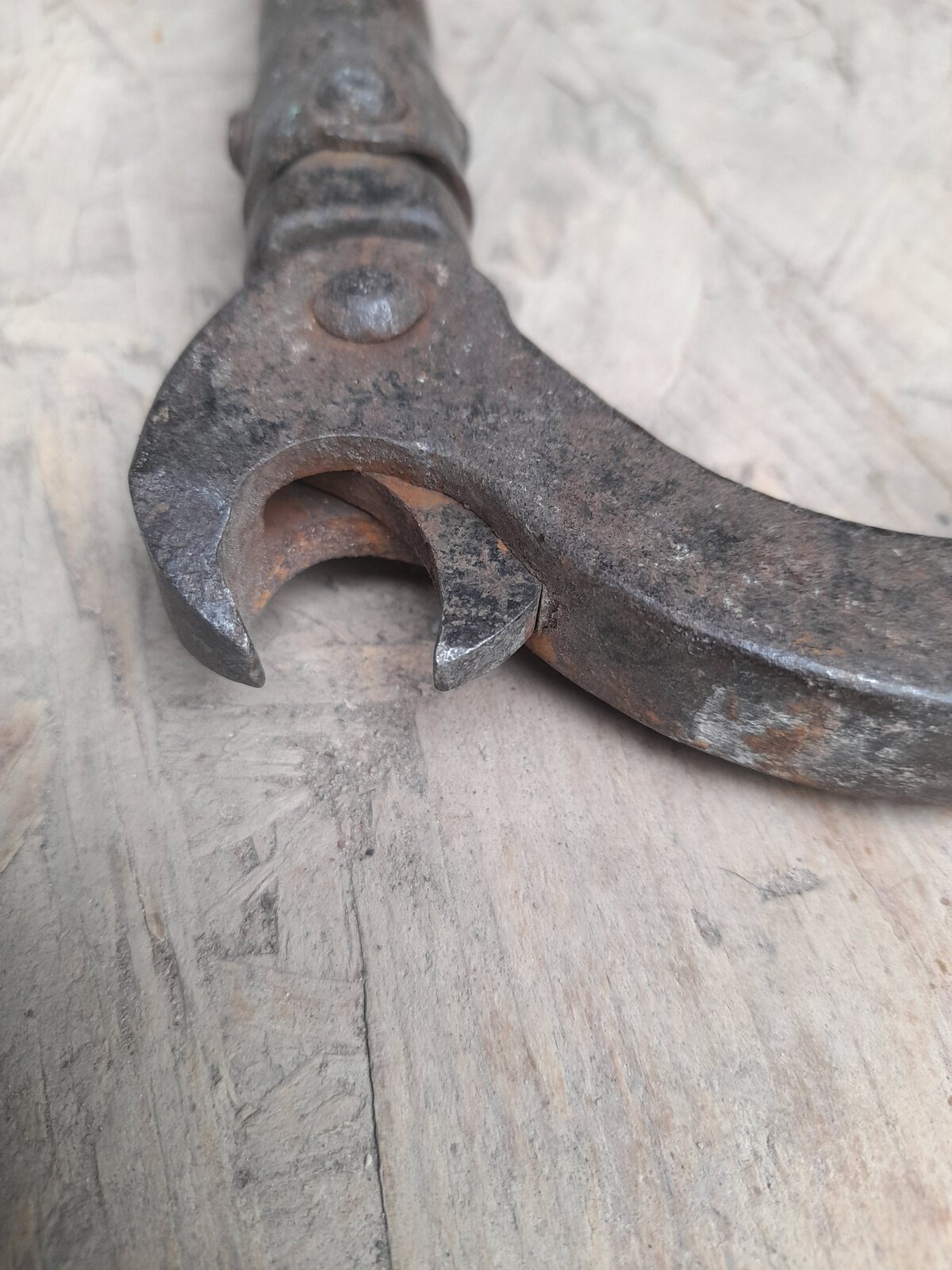

I have never heard of them. Do they work without damaging the floor?.
If it is the same implement I have in mind, they have narrow sharp jaws, like end nippers, but with an arm on the movable jaw. Some include a slide hammer, to force the jaws into the timber around the nail head, then as you lean the fixed arm down, the other movable arm forces the jaws to close tight on the nail. The harder you press, the greater the grip on the nail and the greater the pull applied to the nail to come out.
To answer your question - Yes there is some damage to the timber around the nail, but usually much less than using brute force to lift a board.
Pic of nail extractor
Position Jaws over nail head slide top section up and down smartly jaws go round nail head lever back.
Left with a recess that a screw head fits in nicely.
to refix board.
