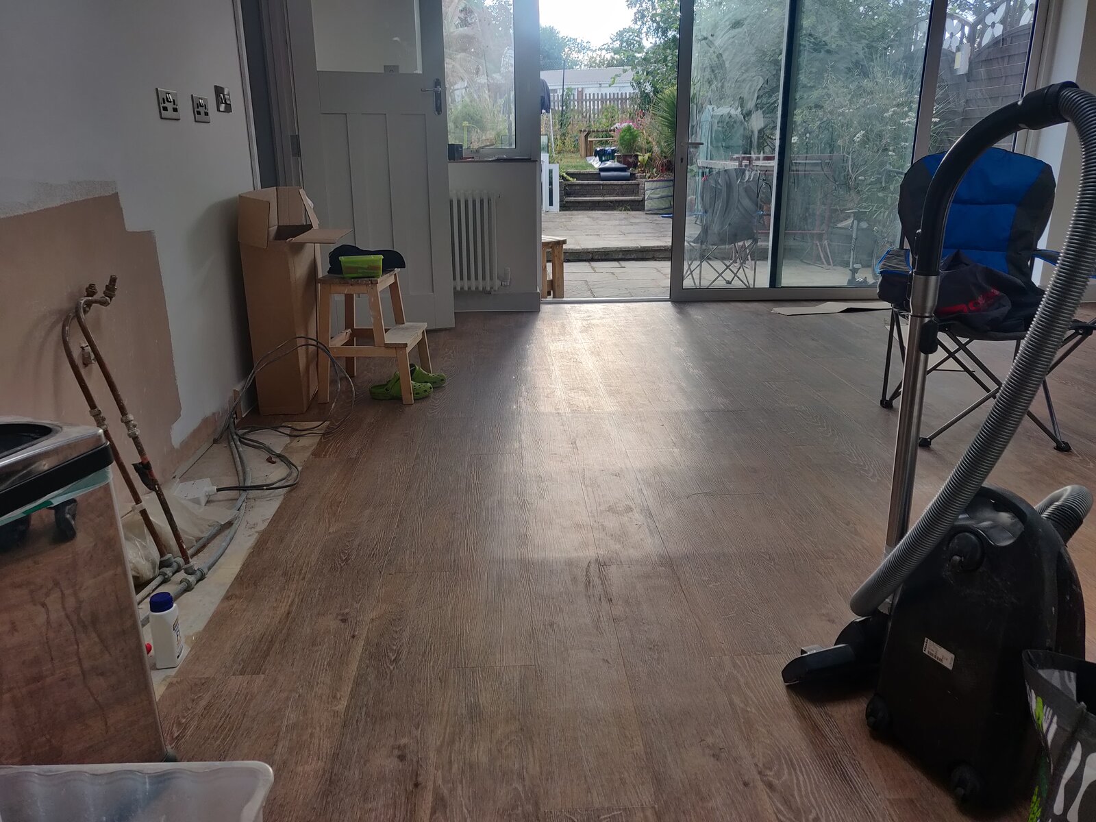

Hi,
I guess this isn't normal?
Karndean fitted last week in new extension and into existing concrete kitchen floor. Floor makeup is concrete slab, small depth of screed to level, celotex, chipboard floor, latex, sanded high points, then karndean.
Every single row is visible and each row dips to the next one towards the door. I put a 2m level in the middle and I get 1cm per metre at the worst points.
Presumably sorting this out isn't simple. Haven't paid yet...
