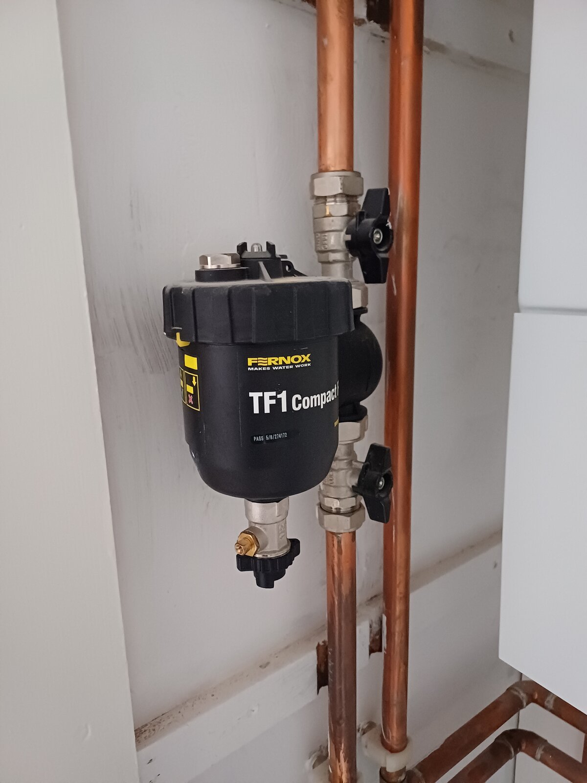

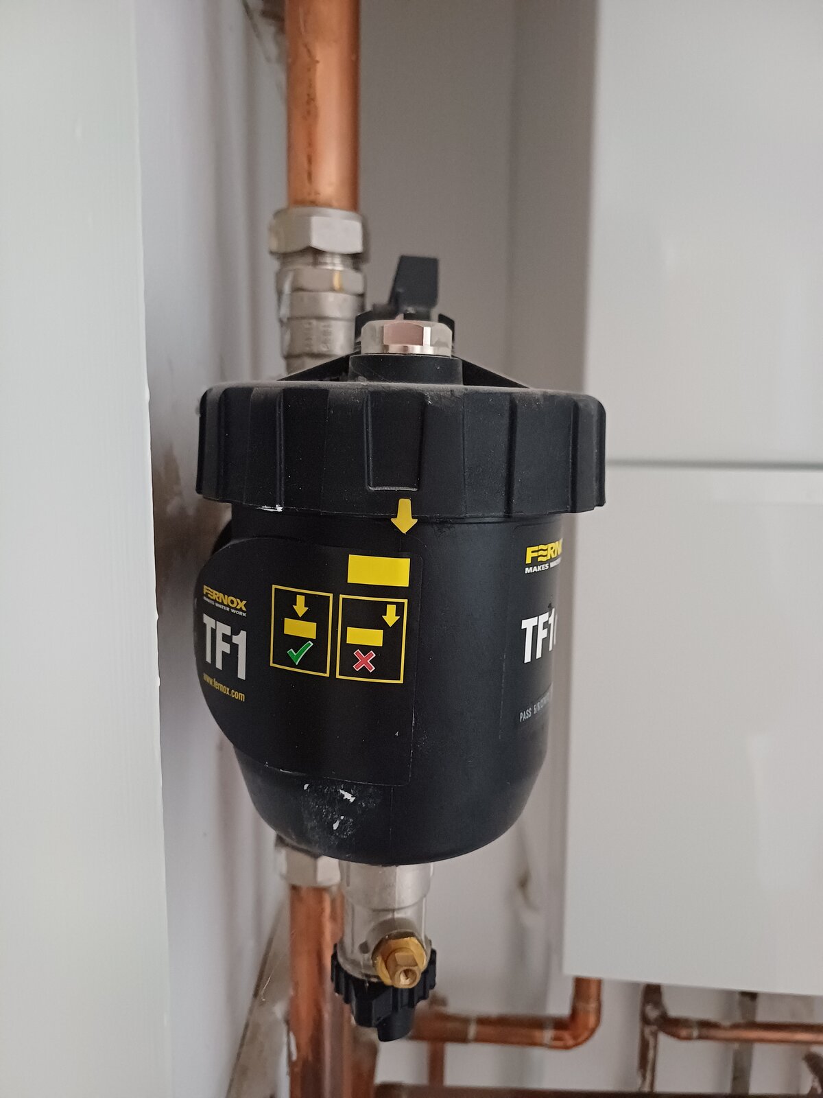

No, those are not present. I do have one of these and I see it might need something doing with it? Relevant to the problem?
Lol. You posted that while I was writing!
Those valves appear to be open (on the filter) but can sometimes just spin on the spindle...doesn't look like it though.
Try bleeding it, see if you get any air.

However, I just bled that filter thing and some air came out. Not loads but some. The valves there are open - presumably would have to be for heating system to work.
I'll keep an eye on it now, as it has just come back on. Could it be that this filter needs emptying, it appears to be towards the end of the gauge. Or is this not relevant to the issue?
Is the arrow on the Filter pointing in the direction of the flow??, can be up or down.
